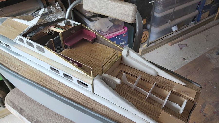

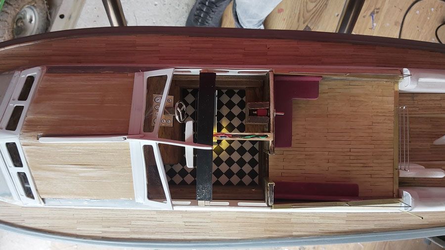

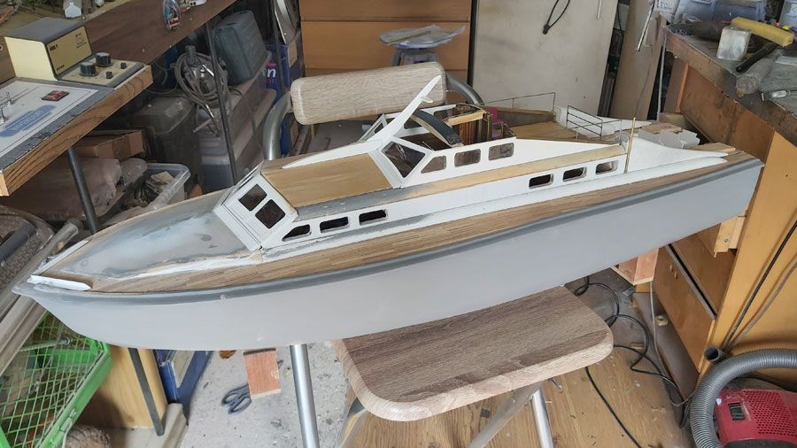

                                                      Thanks for the kind offer Harry but I'm way past that stage now, I decided to let my imagination loose and see what I came up with.
                                                      This is Pecola* as she stands at the moment. I tried the 600 motors but they (and the wiring) were getting way too hot for my liking so I replaced them with a pair of 385's and everything's good now.
                                                      As you can see, the boat has a fully detailed 3 cabin interior with working lights (so that all that work can actually be seen)…
                                                      …and the skeleton of a small jolly boat at the stern. That's what I'm currently working on.
                                                      I still have lots to do on her but so far I think she's looking good. Eventually the hull will be painted a nice rich gloss blue with a white waterline and red oxide below that. I also intend to put a large white swimming penguin logo on the bow.
                                                      The build/renovation has been a bit of a PIA because I originally built this boat nearly 40 years ago when I was young and stupid so consequently nothing is really where it should be. The motors for example have had to be mounted at an angle relative to the width of the boat because the prop shafts were mounted wrong in the first place and I didn't want to start messing about with them because they work fine. It looks OK now, just don't look too closely insidecrook
