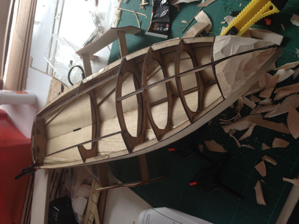

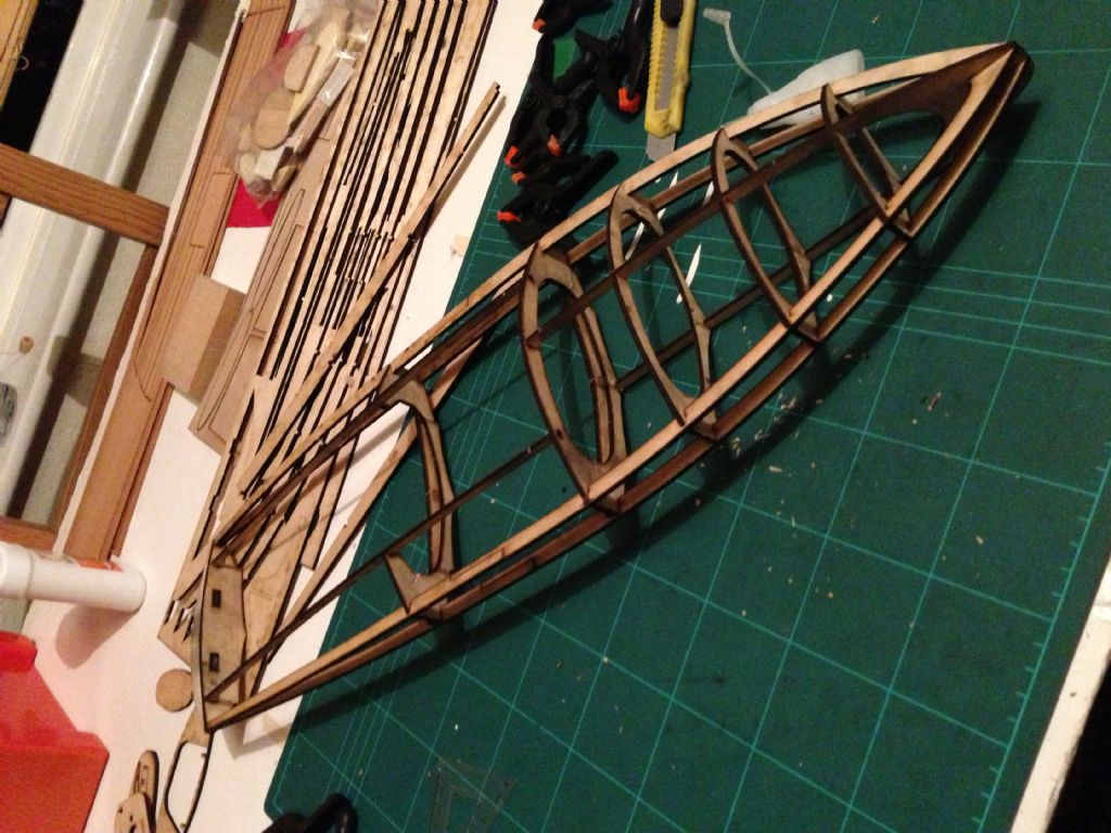

                        Can you post some photos of your build?

                          jonathan szymanski
                            @jonathanszymanski41293
                            #40198
                              Hi Jon
                              Looking at the photos I would think that a 500 size motor will be more than adequate and will help keep the weight down. If you have one try playing with a Magic Johnson car motor.
                              Be careful where you position the motor ideally it should sit just rear of the centre point and angled to enable a straight connection to the shaft.
