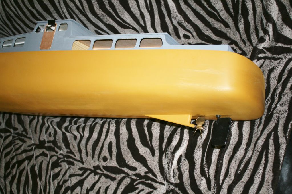

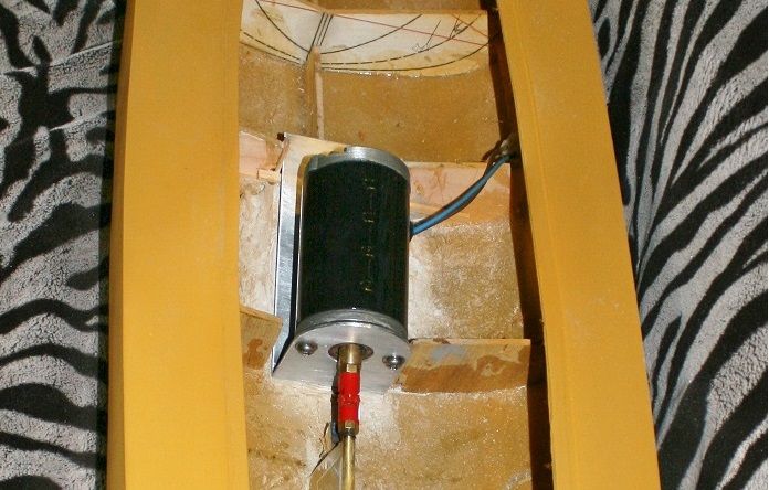

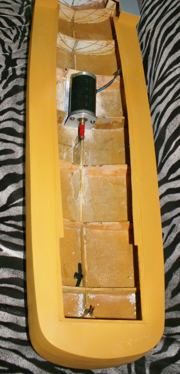

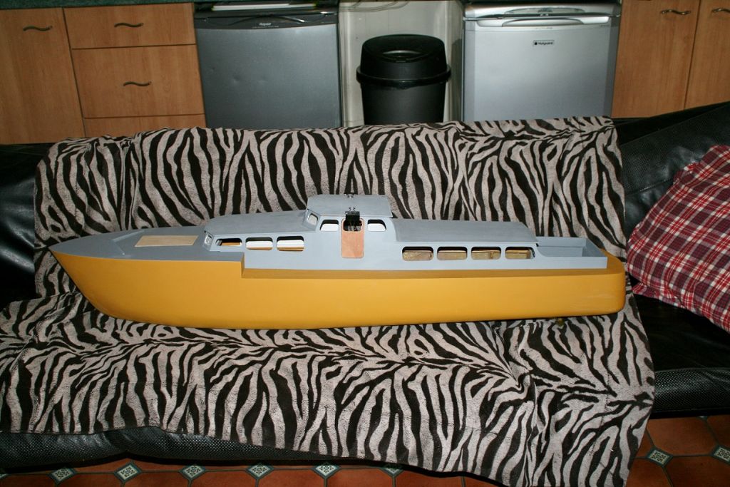

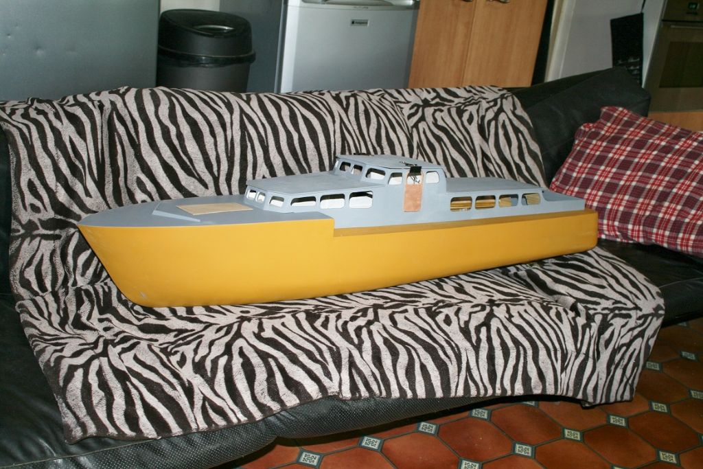

      OK all, I have roughly fitted the fastest of my motors into the hull and run a few tests.
      Unloaded rpm is 4800, With a 60mm prop running in my paddling pool I am getting 3150 rpm. That's about 66% if my maths are right.. With a 50mm prop, I am getting 4000 rpm, about 82.5%. Am I right in saying that the 60mm prop is the better of the two?
      Some time became available so I have had a play with the filler, getting the hull to a decent finish, and got some paint on the cabins.
      Still loads to do but she is starting to look like a boat now and even floats!! That is always useful in my experience.

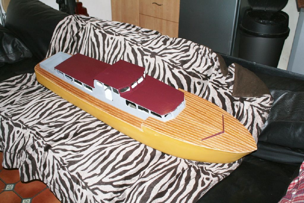

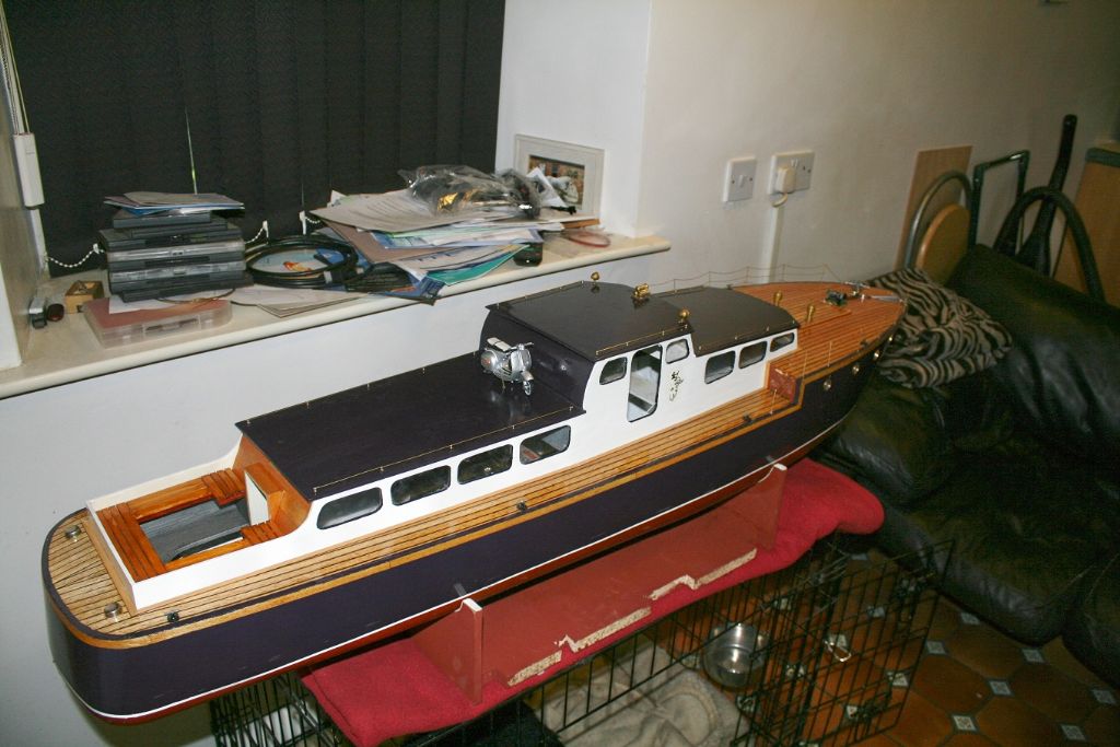

        Life has been very trying lately but not to worry, eventually I got round to doing a bit more on Lorraine. The next job was to lay the decking veneers but it was not to be a simple job. I tried all manner of adhesives without success. Fortunately, there was some excellent advice available from dubious sources, and the problems were solved. The decking is now laid and a bit of paint slapped on the cabin. A lick of colour soon changes the look of things.
        More to come.

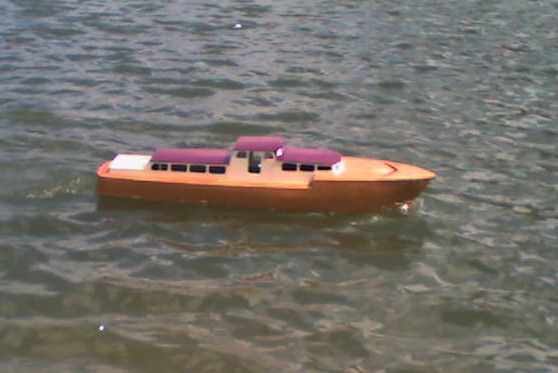

          YIPPEEEE !! She floats .
          #48950
          Diede van Abs
            @diedevanabs87670
            Lookin' good, invisible dude!
            Now off for some detailing etc.
            #48970
            Amy jane September
              @amyjaneseptember49770
              Great stuff, sir
              She looks like she's sitting nicely in the water. Always good to see them where they belong!

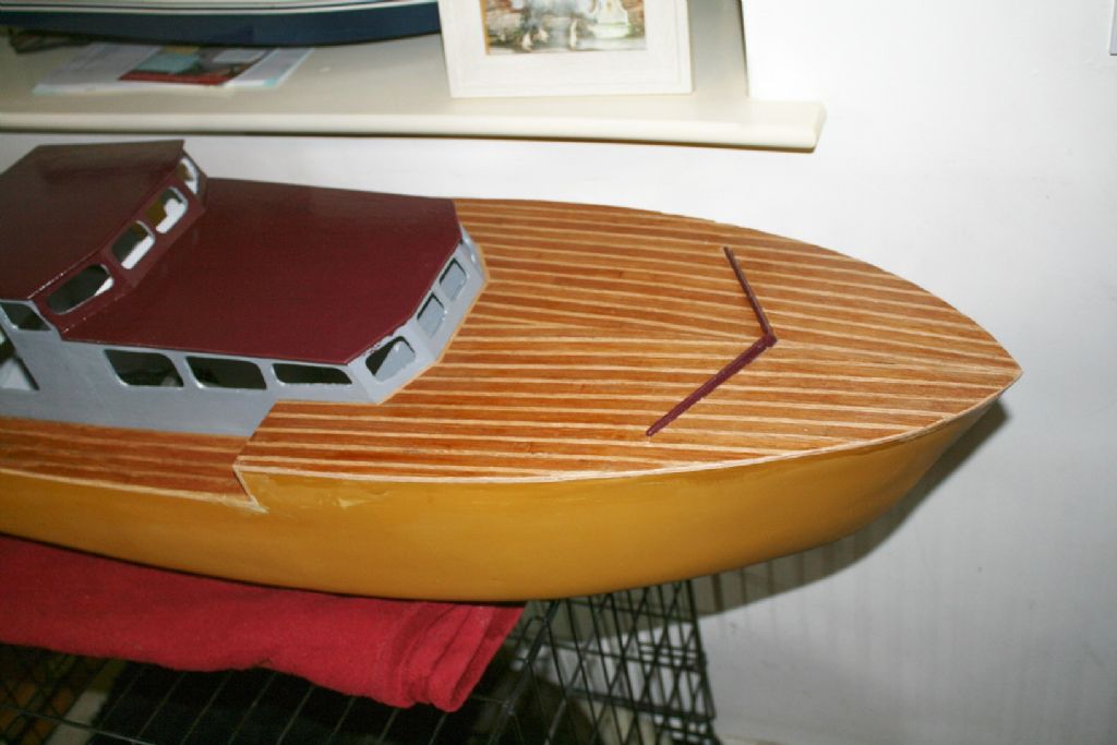

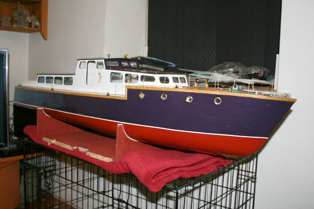

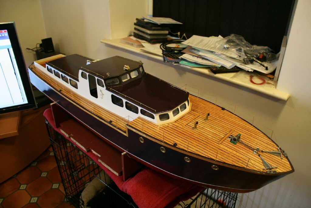

                                          Due to the NHS being totally unable to satisfactorily clone body parts, I have had to take a bit of time off from build works, however, as the saying goes, " I'M BACK !! "
                                          I've been spending a bit of time with the paint brushes and tried to make the hull more presentable. Also had a play with some fittings form the "Cheap but reasonable quality" bin. Had to make up a few bits for myself and I'm fairly happy with the results.
                                          Not really a great deal more I can do now except start the next one. I hope I learn as much next time as I did this time.
                                          Mike
                                          #50808
                                            That looks a very nice model, Mike
                                            Well done
                                            #50816
                                              Mike very nice. Good colours befitting the style of boat, sufficient detail to give it the right look and the wood deck sets it all off a treat. Well done.
