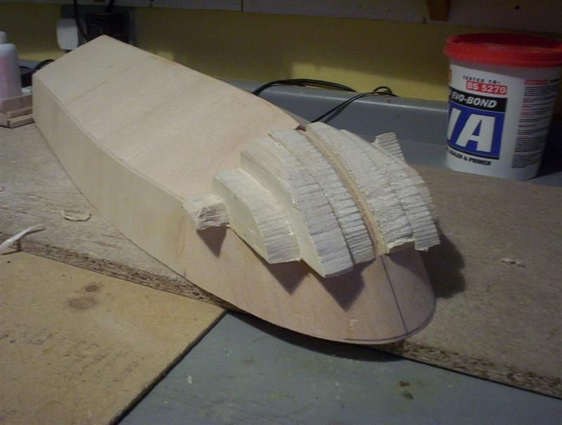

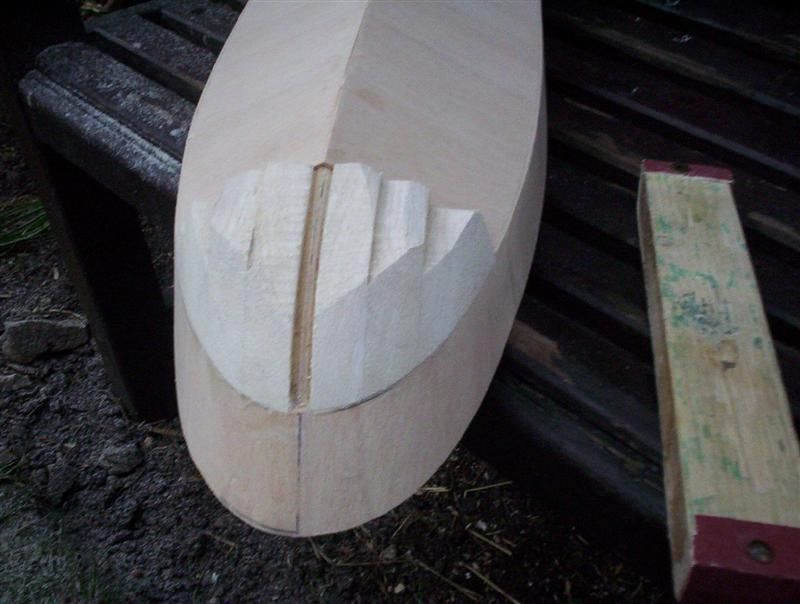

                                One of the tricks for bending balsa which had hard grain in it – lightly score the back face of the balsa in the area which you want to bend it – remember VERY LIGHT scoring across the grain or it may snap at that point. Try it out on some scrap first.

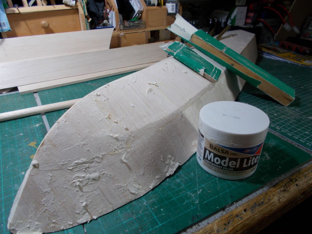

                                As far as blocking the bow and stern on models goes, a lot of us on this forum have done blocking in without any evidence of glue lines or anything showing through.
                                The one thing with balsa hulls is – you must cover them with some material and either coating it with a shrinking dope or some form of resin. On large hulls which I have built in the past, I use a lightweight cloth which the aircraft guys use to skin their planes and also use Z-Poxy to coat it with. This I feel may be extreme for an 18 inch model; there is a water based resin which everyone is using now and it is a good stuff which I suggest you use, along with tissue to cover your model. Also if you are using fillers, try to avoid using the car body fillers as it is a lot harder than balsa wood and you sometimes sand the balsa wood away before the filler. Try and use a product called Deluxe light filler. Just a couple of thoughts for you – and – I will put a couple of photographs on which may help you along, if you read Ray's postings – we should rename Ray – Speedy Gonzalas builder because of the amount of models he builds in a week – I think the ratio must be about 6-1. Ray builds 6 and the rest of us can only make 1.

                                    Had seem the trick of scoring the balsa, but problem being the bow curves in both planes which is quite sever on an 18" model. One to file away. Don't like the idea of using car filler either, though no doubt it has its uses. Our local builders merchant has some filler that im going to try, used on another job and found it to go hard, but not car filler hard. Interesting using aero tissue and dope to coat the hull. Will get some of the Eze-Kote and give it a try.
                                    The bows will be two peices of block, one either side of the keel, so intend rough shaping with the scroll saw before glueing.
                                    Ray can certainly knock them out, but with precision and a fine finish. I can only wish. Just reading Rays comment again and looking at the bows again, might be better to laminate the block. think I'll have to have a play…
