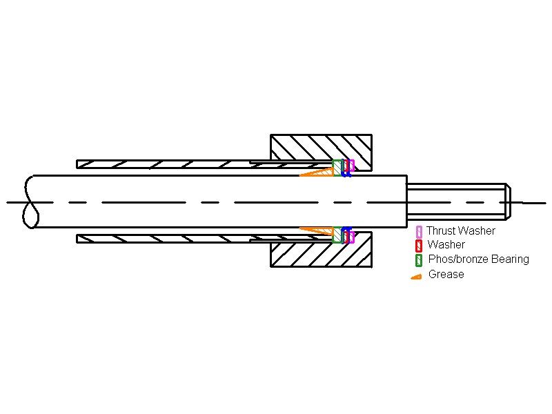

          This works for my large scale models, the tube is brass or copper that I cut a thread into for the cap nut and the shaft is threaded rod.
          If you cant find any phos/bronze for the bearing then use a short piece of close fitting brass tube.
          #21120
            This is my solution………………You can tighten the nut as much as you like, but as soon as you rotate the shaft, the so called locking effect is instantly released!

                PTFE tape is a thread seal and not suitable for a gland seal as the tape will wrap up tight against the shaft during rotation however a block or plug of PTFE would make an excellent bearing in a small dia tube and a washer made from PTFE would make a seal in the same way as my neoprene washer or Bobs greased string.
