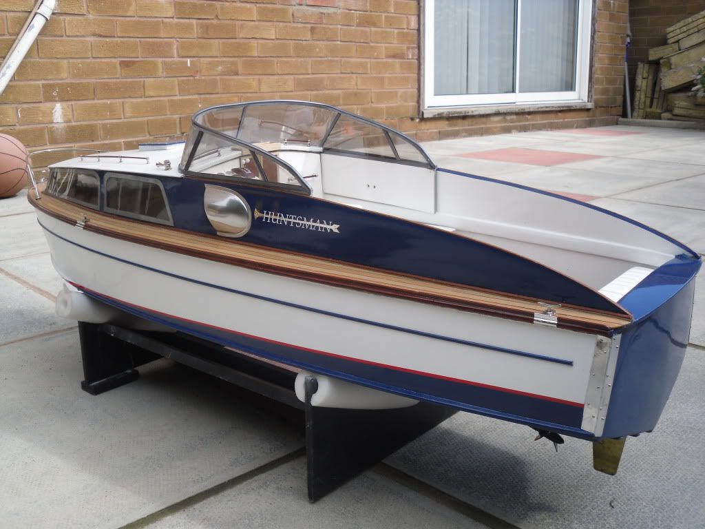

                                The Fairey Huntsman is close to my heart! I own one and love it!, however, as HS93 has pointed out, there are a number of versions, mine is the 28, and featured in “From Russia with love” Bond film, it was one of the chase boats, Bond himself rode the Huntress, I digress!
                                As to the shape, Personally I prefer the Veron version of the 28, the shape of the bow, and hull are very accurate, and as you hvae seen on the mayhem link, its a real nice boat, and I think the wood version is the best.
                                I run a brushless set up, which took a lot of saving up!but is ballistic!,  previously it ran a 700bb turbo neo motor, 2:1 gearbox ratio, on 2 x 9.6v (equalling 19.2v) nimh’s, run time was 20 mins flat out and was very good (single shaft) 52.5mm “x” prop.
                                Set up is a very personal thing, and is very dependent of budget. If you read Ramons build on mayhem, it has been suggested what was wrong, it would appear that the prop is too far back, but it could be a number of other factors also, this Hull thrives on speed and rough water, just like the real thing, so dont let the mayhem problems put you off, thats what model building is all about, testing, testing, and more testing
                                Photobucket“>Photobucket” width=”350″ alt=”” />
                                Not quite finished yet, rear ladder, seats etc, a floating gym palace in its day!
