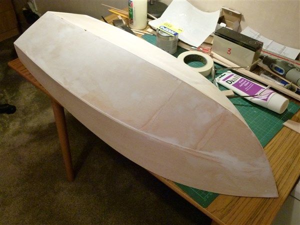

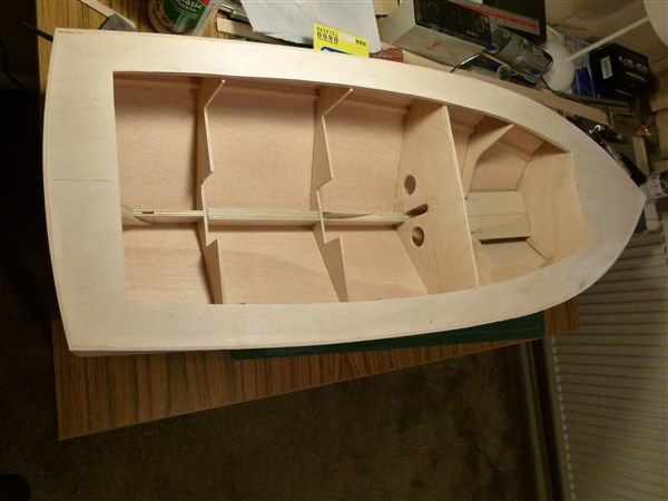

                                                    Well, this is as far as I have got at the moment with my 34.5" boat (1:8 scale). The basic construction of he hull is virtually complete. I have sealed the interior with a hard polyurethane varnish and am in the process of filling and smoothing the exterior with a fine surface filler and rubbing back with fine sandpaper to try to get a really smooth surface ready for applying the GRP cloth. Has anyone any ideas about using a sanding sealer on the exterior and rubbing down again before applying the GRP cloth? You may be able to see that the prop shaft cutout in the keel is enlarged and extended (rather roughly) and also the extended hole in frame 4, as I wanted to be able to insert the shaft tube fitted with an oiler tube from inside the hull. I feel that a fast revving motor in a hull of this size would benefit from an oiler rather than the occasional smear of grease which would have involved removing the rudder and withdrawing the prop and shaft.
                                                    Derek.
                                                      Yes – don't. It's totally unnecessary because the cloth will bridge over any small cracks left after the surface filling, and there may be some incompatibility issue between the sealer and the resin. If you follow the instructions in the article you'll be fine. Incidentally I've just covered a similar hull in 54gsm glass-cloth, using Eze Kote. It's remarkably smooth after a couple of coats and a light sanding. **LINK**
                                                      Your woodwork is exceptionally neat, Derek.
