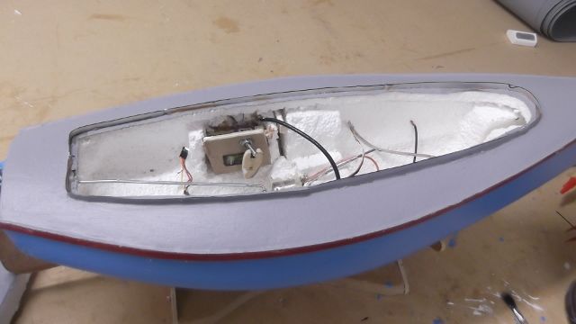

            Amy jane September
              @amyjaneseptember49770
              Hi all. Back again. Did you miss me? (not).
              Well back at work, boohoo.

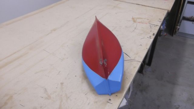

              The cabin window frames all done, and everything ready for a splash of colour.

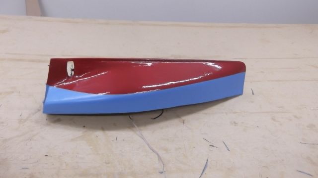

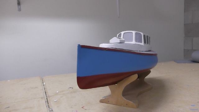

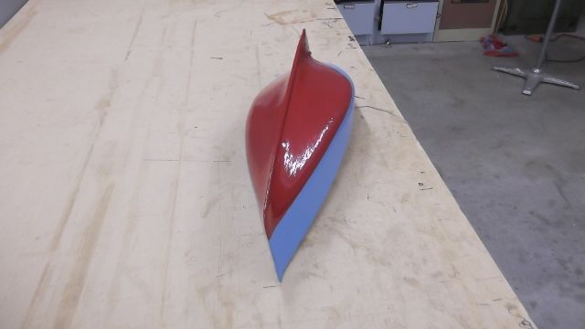

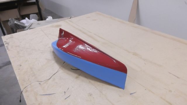

              ….and the hull is painted.
              The water line highlights her shape nicely, you think?
              more soon
              Aj

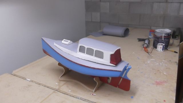

                        Hello again
                        Well, a bit more progress to report.

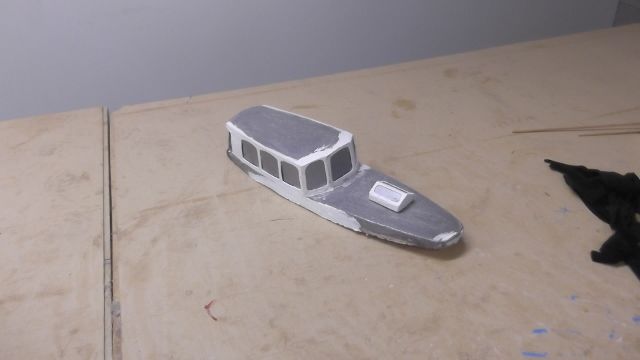

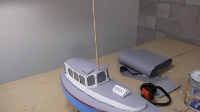

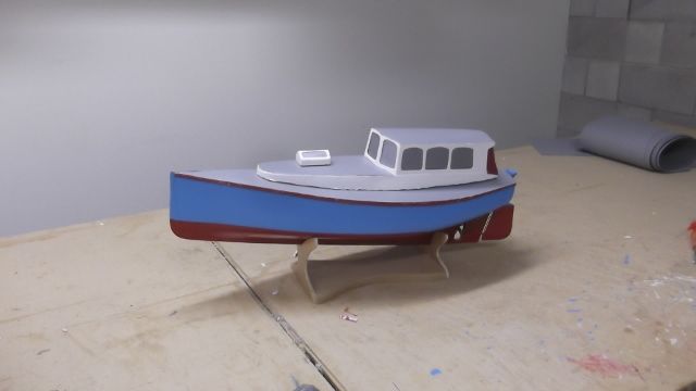

                        A strip of ali was glued into a slot cut in the deck, to act as a coaming. The matching slot cut into the under side of the cabin.
                        The cabin painted….
                        The rudder all connected up.
                        Making a seal between the cabin and deck is next, then recycle another car battery for a few pounds of lead ballest, possibly a cast shoe along the keel.
                        Aj

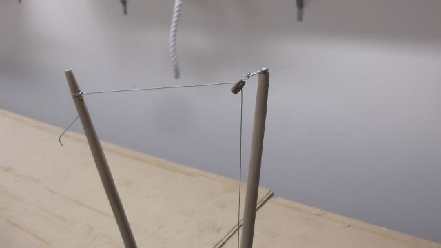

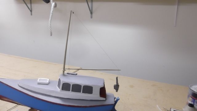

                                          The derrick is done. The mast passes through the main cabin top, just abaft the windscreen. I've put a round ply disk around the mast at roof level and a headless screw projecting down from the mast step. By screwing the mast down until the ply disk is firmly against the cabin roof, I can both support the mast and press the cabin down on its seal.
                                          So… a couple of pounds of ballast, a few handrails and cleats, a few props to experiment with and she's all go…

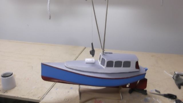

                                                    Right, to bring you all up to date..
                                                    Cassie's derrick in action…
                                                    The free standing mast means the load can be picked up from any where and put down any where on the boat.
                                                    on a full sized boat I would use a couple of trailer winches to keep the deck clear of rope under foot.

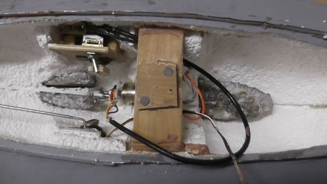

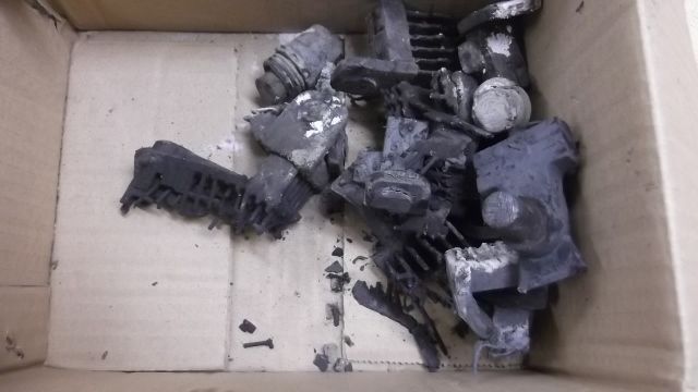

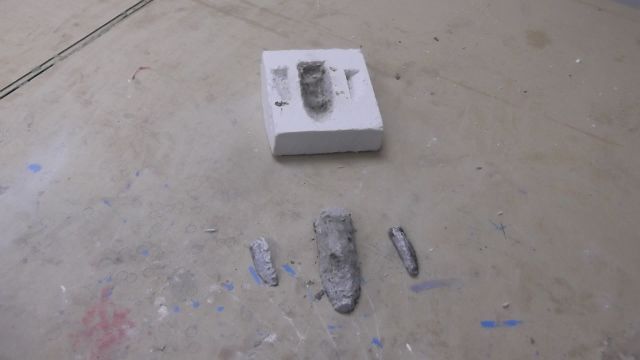

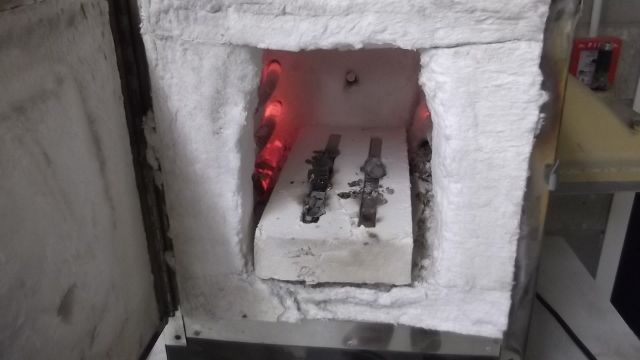

                                                    Ballast was required, so another old car battery was put to the saw…
                                                    This is about al you get that is worth recycling, the plates aren't worth the bother.
                                                    I make the mould out of a bit of ceramic board, hollowed out.
                                                    Crude, but it's only ballast
                                                    I have a small furnace I melt the lead in
                                                    I originally cast the lead in long strips, for to screw on the keel, but didn't much like it , so re cast to go in the bilge.
                                                    Ballast temporarily in place.

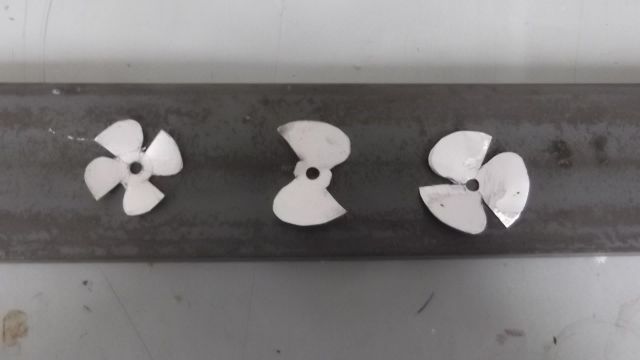

                                                    A few props made up, for to see which is best.
                                                    Sizes from 40 to 45 mm diameter, and I'll adjust the pitch as I go.
