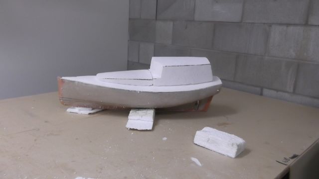

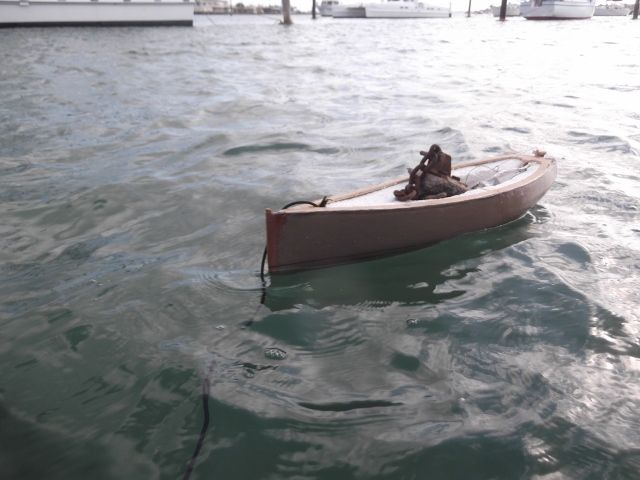

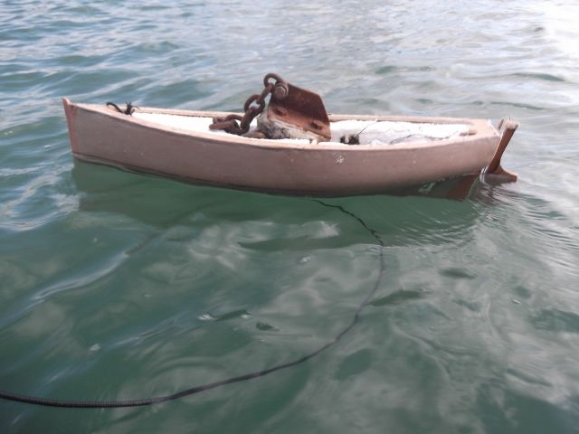

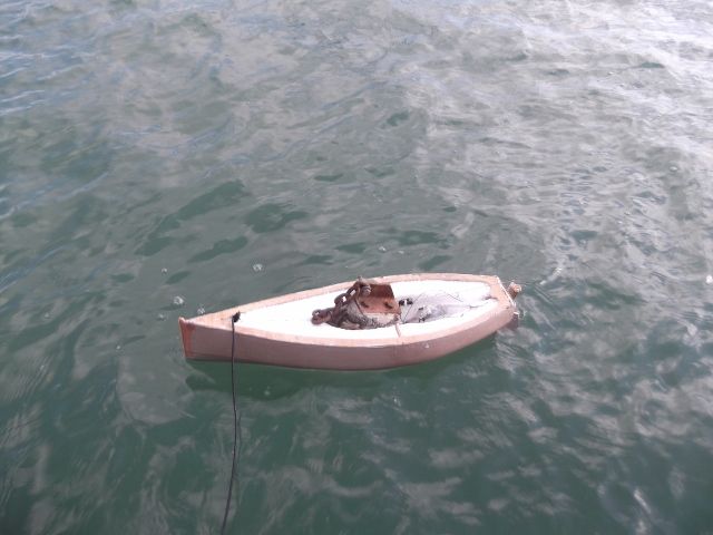

      Well the hulls all waterproof, though not painted, and the rudder servo and motor is in, so I drew in the water line, and it was off to the bath…
      A bit of old chain thrown in to settle her down. Displacement worked out at 7lb. I'll be using 2 my of standard 6 cell 600mah ni cad packs (in parallel) so she will need a bit of ballest..
      more soon…

        Hi AJ..
        The build is looking great, thanks for sharing the pictures, can see the scale a bit better.
        Hope you get to play with the big boat…lol

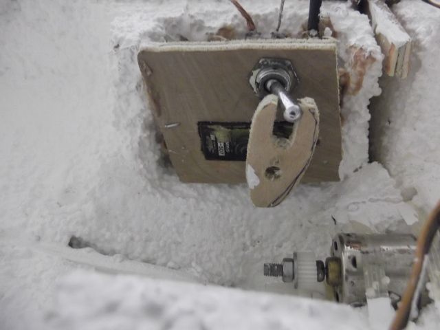

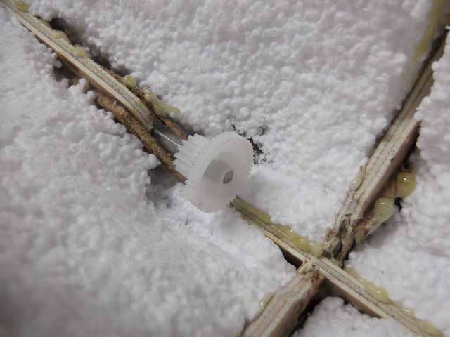

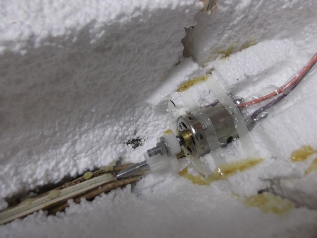

          Here's a couple of piccies of my, err, the boats, internal gubbins.
          The gears are from a scrapped printer, one forced on to the prop shaft, the one on the motor is on an adapter that I made by drilling a hole up the centre of a bolt, and force fitting on the motor shaft. The washer stops the prop shaft sliding aft, and a couple of washers between the prop and tube acts as a thrust bearing, 2:1 ratio.
          To stingy to shell out on an esc, so just a simple servo operated toggle switch for the motor.

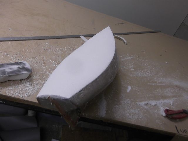

          Sheet polystyrene deck on.

              Amy, is the servo on your motor toggle switch progressive?

                  Len, I should say that AmyJ`s toggle switch is progressive…it will get progressively more difficult to operate as the sailings build up..wink

                        Not sure what you mean by "progressive". Even if it's operated by a proportional channel there is a point along the travel when the over-centre spring inside the toggle switch takes over and throws the switch from off to on etc. We used to have 'self-centring' and 'progressive' servos back in the dark days of reed-receivers; the latter were used for the throttle and for elevator trim in RC model aeroplanes. All modern proportional servos will move to the position dictated by the Tx stick or switch and then stop, awaiting the next command.

                                    Here's the point to all this Amy and my earlier question. Just recently I managed to knock over no end of things on my bench with the power cord of my electric drill. Set of to buy a cordless the next day. My local store Aldi had 14.7 volt re-chargeable ones on offer for £9.99. You wouldn't you use them commercially but ideal for kitchen top model making. On playing with it at home I noticed that the trigger speed control caused the drill to whistle just like my 'expensive' sub speed control. Shot back the next day and bought a second one. This was justified by the need for any battery drill to have two batteries (one in use and one on charge). The second drill was pulled apart. Inside was a 540 can motor, a gearbox and a speed control unit – all separate! Experimenting with the bits, they all seemed to run fine on 6 volts. See what you can find locally Amy. You might as well push a speed control switch with your proportional servo rather than a simple toggle switch. Cheap way of getting one and you get a whole lot of other gubbins also!
                                    Len

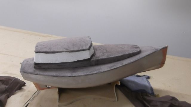

                                      I'm right with you on that Len, very smart thinking! The cheapest esc I can get is about $24 (11 pound or so) so that makes your drill very good value indeed! I don't know if I can match that, but it's off to Bunnings or the Wharehouse for me…
                                      The cabin has been carved out, awaiting a bit more sour milk and bed sheet.

                                        The shape of the cabin is important to the boats seaworthiness, Low windage forward, combined with the hulls deep forefoot, and the high aft cabin keeps the bow pointed into a strong head wind. The high cabin aft makes it impossible for her to remain upside down in the advent of a roll over.

                                          Assuming you are not putting a powerful motor in the boat, I rather like the simplicity of an on/off switch.<another emoticon>

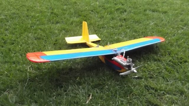

                                                Ok, confession time. For the last few weeks, I've been distracted by building this.
                                                Cute eh? My own design, built by Lynn's methods, from polystyrene of course! Flies really well.

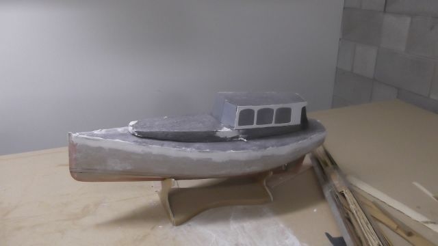

                                                      The cabin has been coated with cloth and glue.

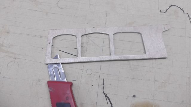

                                                      For the windows I spray painted one side of a bit of clear pvc silver and glued it onto the cabin side, painted side in. I then cut the window frames out of plywood. As I only had 1/8" ply, I split it in two after cutting it out.
                                                      A bit of a pain, but ended up with two frames of 1/32", which were painted and glued onto the pvc windows.

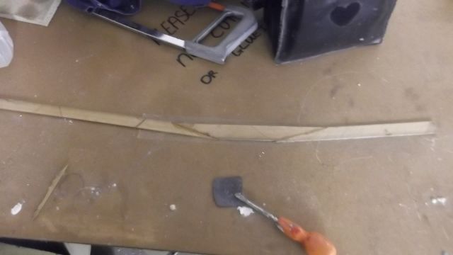

                                                      A bit of filler, and the wales pieced up out of 1/16" Kauri, ready to be cut to shape and size once the glues dry.
                                                      Aj
