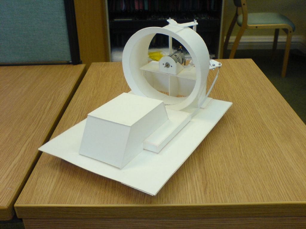

        Hi Andy
        I am also having a problem with motors as the majority of mine are in the 500>700 range but the cans are quite heavy and whilst they are superb for model boats they are adding excessive weight to the hovercraft.
        So now I am playing with some hot buggy motors that my son used to put in his cars, they are lighter, spin faster and hopefully will solve the problem.

              Paul. You are just going to have to go brushless. It is not difficult, just need a brushless ESC. Cheap on fleabay. Very light.. ideal for foam hovercraft…
              J Perkins website has a good selection and also ducted fans.. fans small enought o fit in SRN1 ducts for propulsion.24" would be a good size for an SRN1, indeed
              AND ducted fan..fans.. and adaptors to fit on motors however the largest is a 3mm shaft size

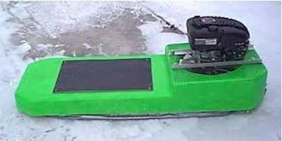

                        What you could do with for model recovery from the middle of the lake is a …..hoverboard…..easy enough to build with a petrol leaf blower and a small piece of plywood.
                        So much more fun than an SRN1
                        Edited By Paul T on 18/04/2013 19:27:19

                                    You could always build one of these
                                    hoverboard 2

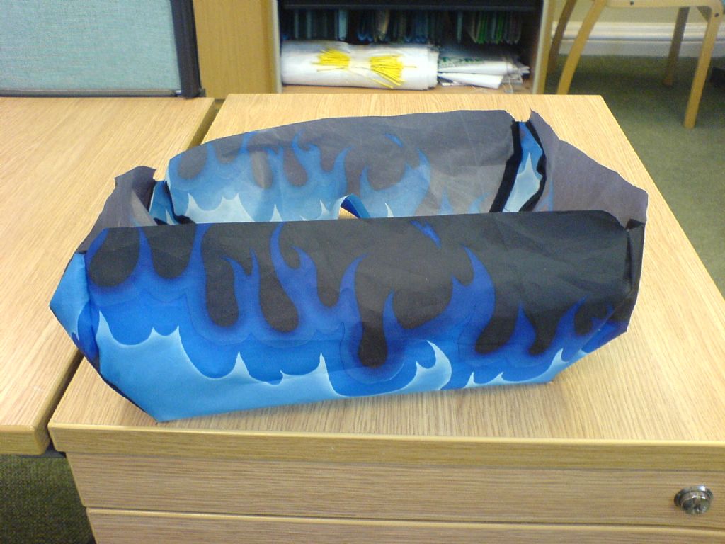

                                            You're right time does weigh heavy….but on the positive side the RipStop has arrived and hopefully Jane will be able to sew the panels together later today.
                                            After your comments I have revisited the calcs for the thrust tube buttress support and changed the design to make it more aerodynamic.

                                                Jane has sewn the skirt together for me and done a super job, now all I have to do is find a way to fix RipStop nylon to timber and foamboard.
                                                Dave: Its a big thing to steer and I am not sure that the rudders will be up to the job but we will see what happens. I don't want to go to the expense of brushless as the hovercraft was only intended to test the foamboard theory and I will be happy if it simply hovers and spins around.

                                                  Paul. I have a feeling that there is nothing more sophisticated than double sided tape used on a lot of craft?? The skirts are prone to damage and need to be able to be replaced easily.
                                                  Rudders, venetian blind arrangement, lots of fins.

                                                      I will try double sided tape or perhaps velcro, still not found a set of fan blades.
