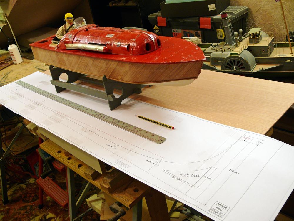

                                            Received latest batch of three prints…..OK
                                            Made a start on the keel, using two layers of ply
                                            Ideal for laps joints as the ply is not quite long enough and also ensures a dead flat keel
                                            Have shown Ellie hull on keel print to show relative size of new project

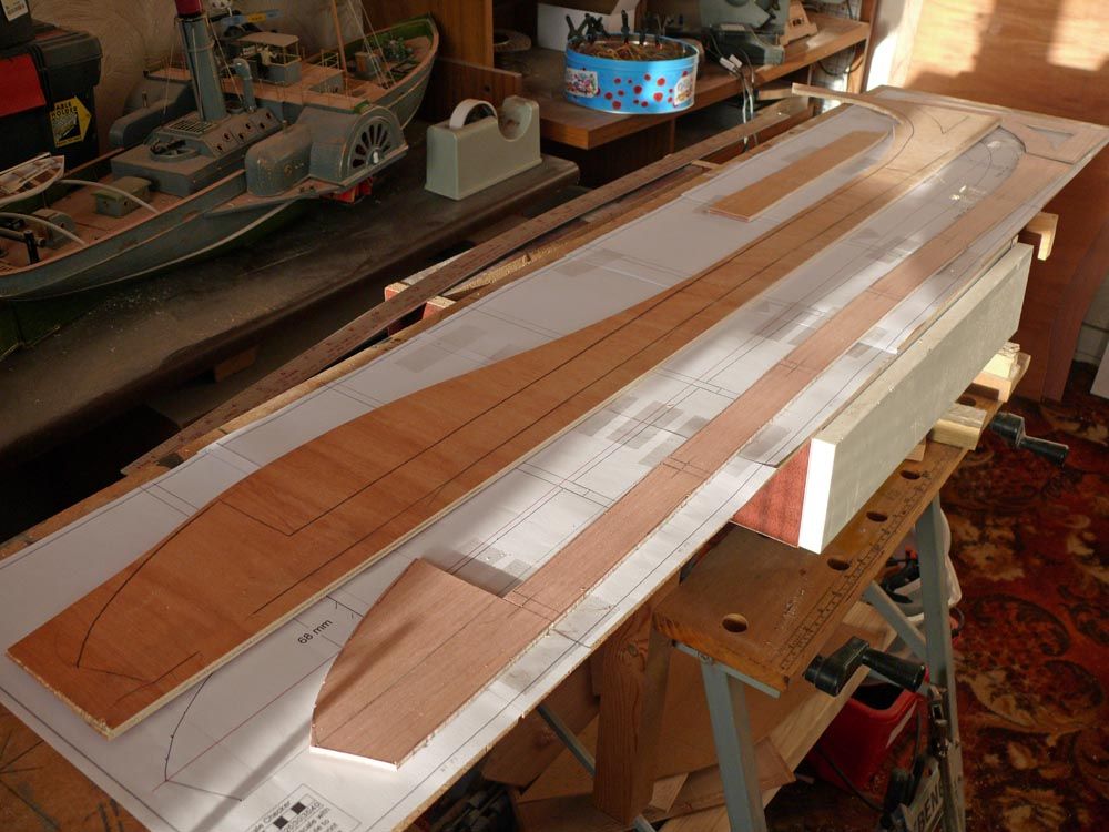

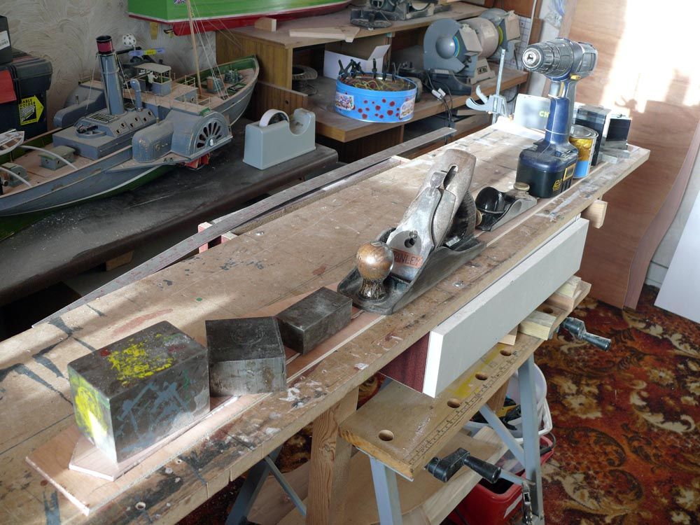

                                                Made a start on Brutus, while the paint and glue dries on SloMo
                                                The keel is made up of several parts and glued together under a mountain of weighty stuff
                                                The result is a strong and flat starting point, with none of the familiar plywood bow
                                                Now for the formers

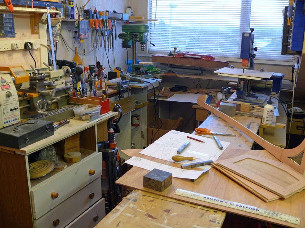

                                                      Thank you, Amy and Ashley
                                                      Here`s a better picture of the famous " Shop Floor"
                                                      In full production now, working on Ellie, SloMo and Brutus
                                                      I must spend half my life up here or on the computer in the spare room , next door!
                                                      Wife doesn`t mind, as she likes to watch the telly in the peace and quiet
                                                      Bizzy B
