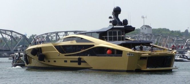

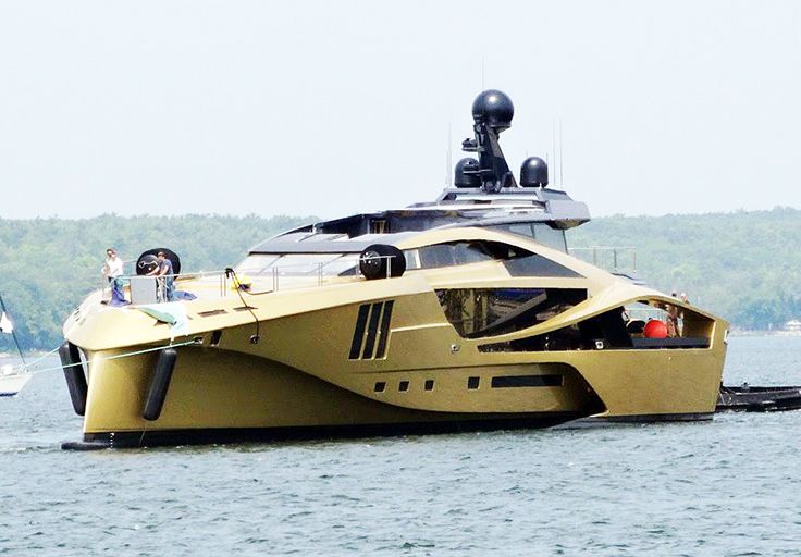

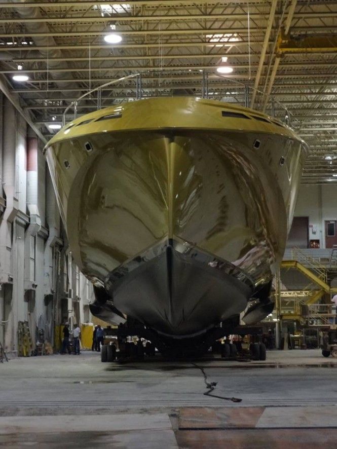

        When drawing Brutus I looked at the way the A yacht was designed and another super yacht called Golden Supersport .
        Palmer Johnson Golden 48M SuperSport Yacht
        I had a basic criteria to follow when designing Brutus and the length of the backward sloping bow on the A yacht fell outside the design brief.
        For a short time Brutus had the same 'outboard chine' as the Golden Supersport (best seen on last image) as a way to control the bow wave but the eventual overall hull width fell outside the lcs spec so it never left the drawing board.

                I actually quite like the design language of the Golden Supersport, although I question the efficiency of the hull design.
                Very unlike the "A" yacht, which I think is an ugly PO..
                I think Brutus will benefit tremendously from a (small) spray rail indeed.
                #70709
                  Chaps. Do not confuse "efficiency" and "excessive style" when looking at superyachts!!
                  ​Looking at that one, it seems to me that on a calm surface (and this is presumably where they want to be on it) the small bulb and the fine entry makes for a smooth ride. At higher sea states the swooping outer section comes into play in stopping too much sinkage….??

                      Posted by ashley needham on 21/04/2017 09:44:12:
                      ​Ashley
                      One A yacht design requirement was for a boat with low pitching characteristics in rough weather. Pitching disturbs the mixing, serving and drinking of cocktails. It is also bad for the sauna pools and the dance floor….

                            The Golden Supersport has an Axe bow, but very shortly after this the flare begins, which means that as the vessel enters a large wave it will begin to throw water to the side and pitch.
                            By contrast, A has hardly any immediate flare, and only starts throwing water to the side about a third of the way down the hull. You would expect it to cut cleanly into a wave, and sail through it rather than over it with very little pitching.  But you will see that this cutting action requires the bow to be very long and slim…
