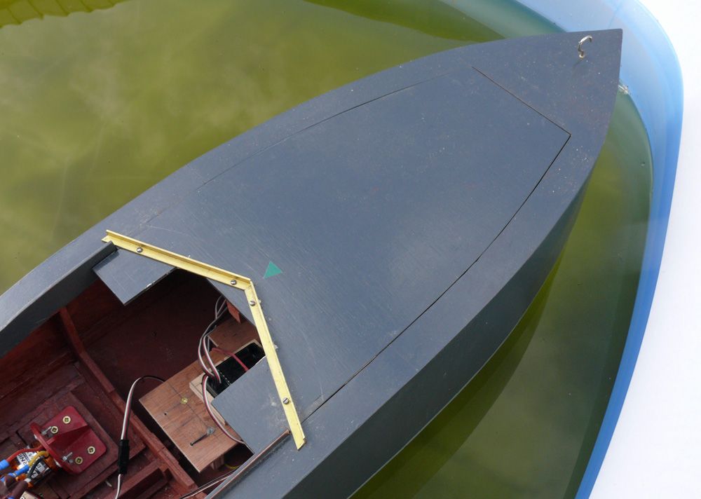

                      Would be nice, Paul
                      Here`s what I`ve done to keep the spray out….Brass baffle and the top cover, sealed in position
                      We`ve got another regatta to attend next week at Buxworth, Derbyshire………A Victorian canal basin
                      Straight line running…..Ideal
                      #60568
                        Both venues are ideal locations to let Brutus rip, the spray deflectors look the business and if your prototype set work I will add them to the main drawing.
