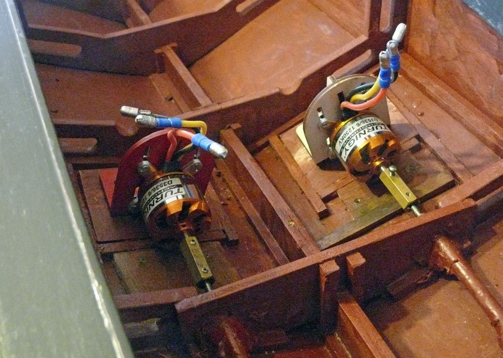

        Brutus is coming out of the shadows and into the limelight again with a double motor transplant!
        Twin brushless motors to be exact
        Having checked up……..Happily, they fit nicely!
        #60353
          Hi Bob
          The model would certainly benefit from the extra power.
          Which of the many brushless motors are you fitting as it would be interesting to know the specs.
          #60354
            Hi Paul
            The motors are ……Turnigy D3536/6…….1250 KV
            The Controllers are…….QUIK Series…….Car-45 A
            Input 5v-12v
            Batteries 7.2v……4600m Ah

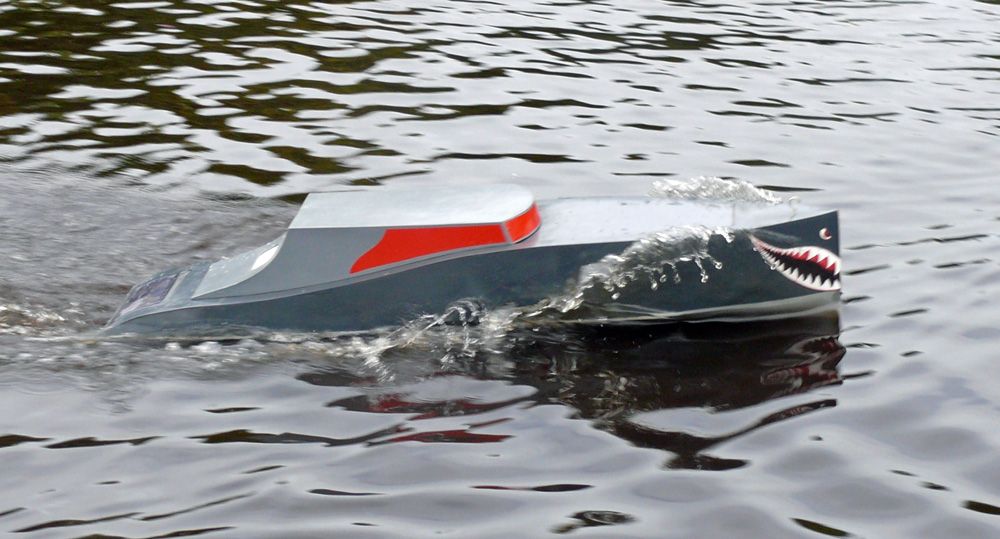

                        We had a successful sea trials at Etherow this morning
                        Brutus ran really well………One snag was that the bow wave in choppy water…….Burst over the top deck and into the boat!
                        Duckie made a short video, which will be posted shortly
                        A few pictures…………The last two are old pictures that have slipped in by mistake!…….Sorry

                        #60381
                          Hi Paul
                          This is the spray problem!
                          Any suggestions?

                                      Hello Bob [and all]
                                      Firstly you need to know that this hull as it is a hybrid containing the best of sea axe and planing hull features, all credit has to go to Bob for faithfully following the design on what must have been a bewildering set of drawings.
                                      The bow is intended to slice through the water rather than ride over it but the underwater profile quickly changes from axe to planing.
                                      At speed the hull rides on the water at a rotational point half way down the hull (roughly in line with the front of the superstructure) whilst the bow still cuts through the water.
                                      Photo 1 below shows the boat in its ideal trim position with a very fine and sharply defined bow wave being formed at the waterline level. At high speed the boat should have exactly the same attitude in relation to the water but be riding 15>20mm higher
                                      Photo 2 seems to indicate that the boat is bow heavy however this could be due to the chop so I cant be sure until I see the video. The image also shows an interrupted bow wave (the ripples rear of the mouth) which is due in part to the decals creating a rough hull surface (not evident on photo 1)
                                      This model is essentially an experiment with a new hull shape and was always going to be tricky to trim correctly.
                                      If the bow wave continues to be a problem after making the trim adjustments then it is feasible to increase the width of the foredeck by the addition of a narrow concave section spray rail so that it over-sails beyond the hull and directs the bow wave back down.

                                        The Bows are slightly down……Due to ballast being added to get the stern up a bit
                                        Will fit a top bar to deflect the spray and seal the lid………And go for it!
                                        On calm water, we don`t have a spray problem
