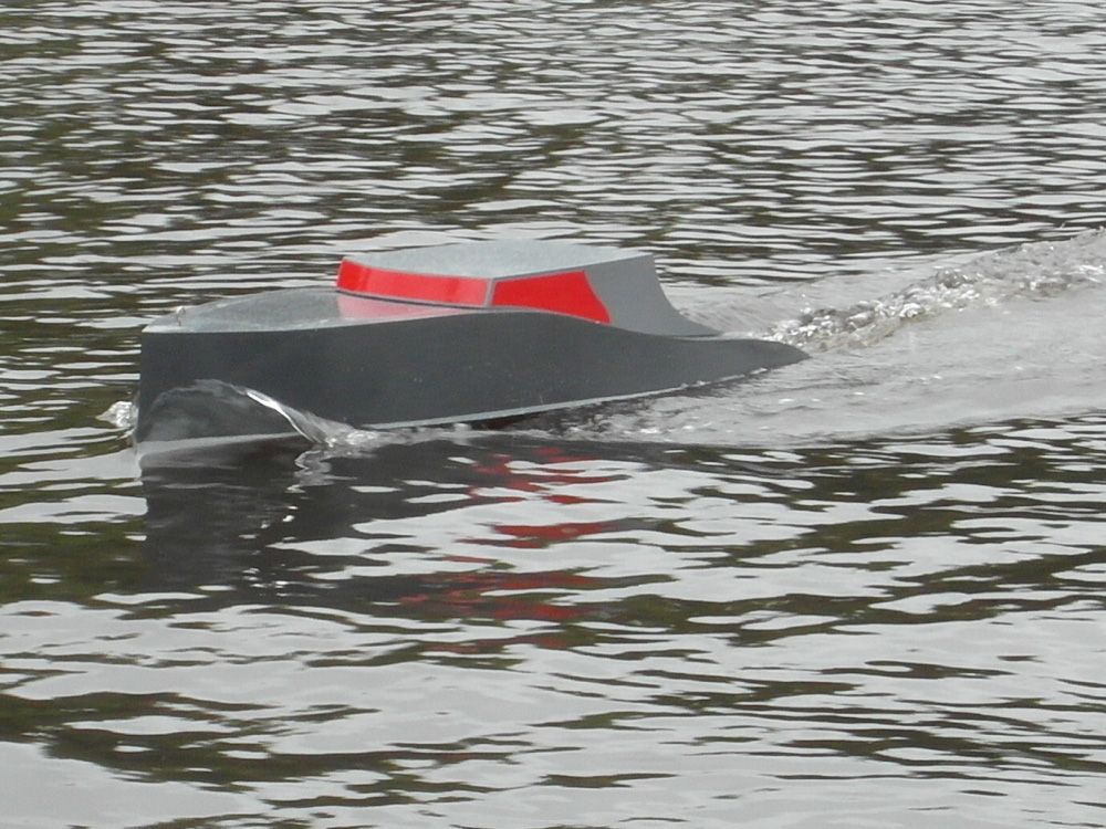

                                            Went sailing with Duckie today, as arranged and had a successful sorte!
                                            For some reason, we`ve still got the very bad water ingress, but it should soon be sorted in the bath today
                                            Would be nice to do a demo at Haydock?
                                            Brutus ran really well and wasn`t even flat out!…..So we`ve got some good potential
                                            Still think the props are too small, but will get some for next outing
                                            Look at the Axe Head created bow wave, in this shot!…..That should please Paul?
                                            Does it need a small amount of ballast up front?
                                            More pictures to follow and another video by Duckie

                                            #51023
                                            David Wooley
                                              @davidwooley82563
                                              Hello Bob and Paul congratulations on your successful sea trials , Brutus does cut a fine wake, the bow on shot looks impressive ,
                                              Dave Wooley

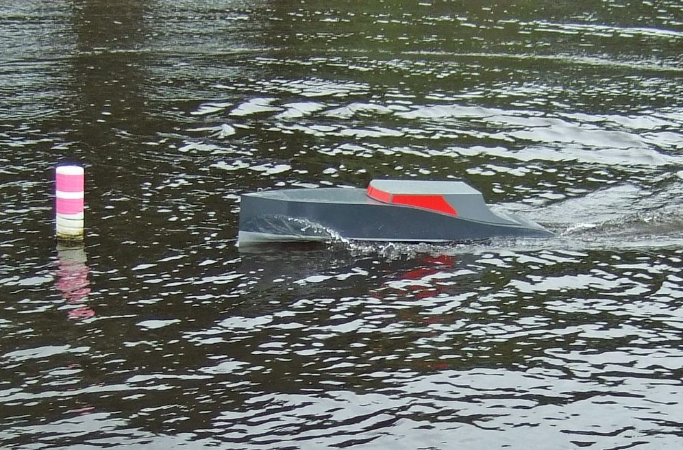

                                                  One of Duckies photos
                                                  He`s caught the bow wave quite nicely…..The knife edge has sliced a crystal clear wave
                                                  Note lack of water disturbance
                                                  #51034
                                                    Excellent shot! The bow wave in particular is very interesting. Not much water being pushed around which does indeed suggest that the hull is efficient.
