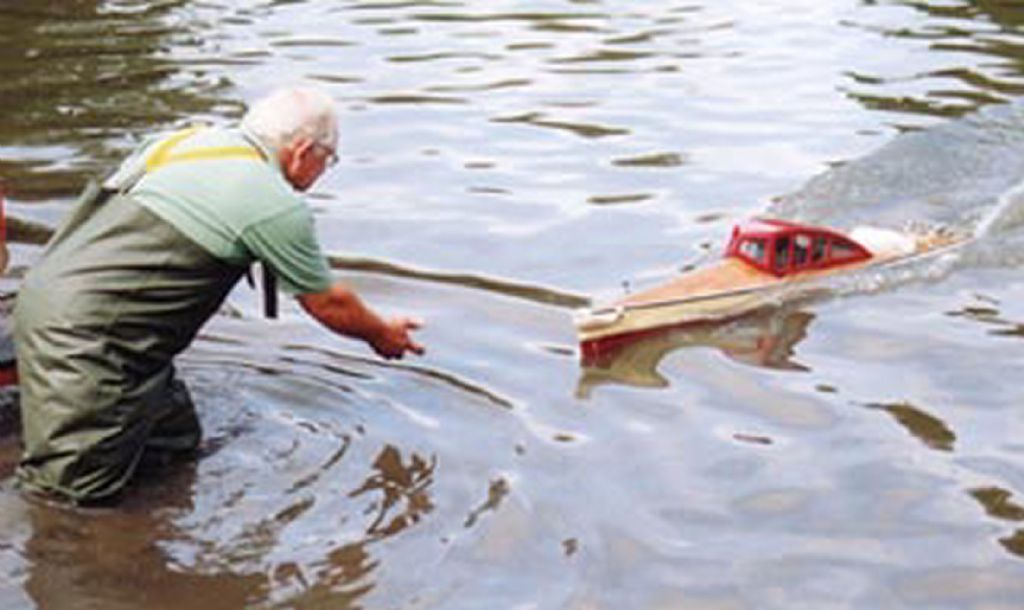

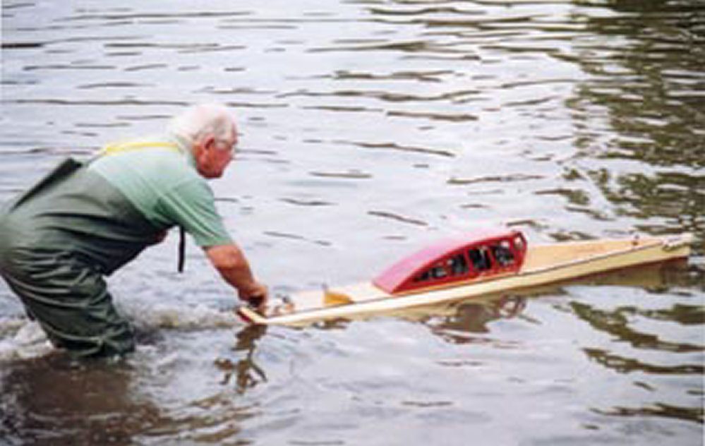

                        Hi Paul Your design reminded me of a model from my past. I finally found these photos of Tom Clements from one of the Newcastle clubs with his Straight runner. tomclem0005.jpg
                        It has quite a deep stem and I think it was powered by 4cyl T Westbury design engine (Sealion) driving twin screws the mechanism on the rear deck is screw adjuster for the twin rudders

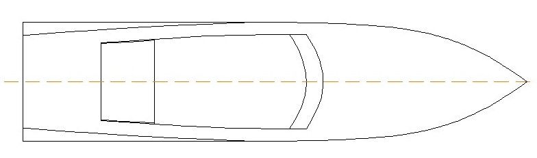

                                This plan view shows the overall shape of the model
                                You can see that the prow is quite sharp and that the shape is further enhanced by the curve starting amidships.

                                        What a shame the top view does not look as futuristic as the side view!!
                                        Bob, it needs some "ray gun" exhausts and rocket fins, or something devil when you start…..
