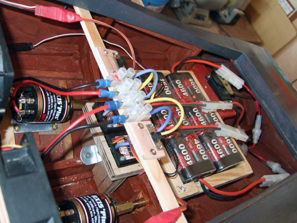

                                                    #49500
                                                      Finalised layout of the brushed motor setup
