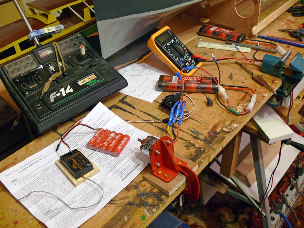

                  Right then chaps!
                  All fittings are now fitted to the wires and about to connect up!
                  Is there a safe wiring sequence of connecting the wires?……….."Connect the battery last!"……Some one shouted………..Good idea………..Thanks……….Peel that man a grape!
                  Just checking the fuse size. The paper work says the ESC is 50 amps!………Who said we don`t need a big cooler?……….Was it you, Ashley?
                  With both motors running, that`s 100 amps!……We could make toast with that!
                  I`m beginning to suspect that all this power can`t possibly be true!……Am I missing something here?
                  Somebody mentioned at Ellesmere, that these motors are very efficient and run cool and we don`t need fan cooling………..Well, we`ll see!………100 amps?……..Geeeeeez!
                  At the moment, the motors are not glued in place, so for safety reasons, I`ll clamp one to the bench and see how things turn out……….Good idea, Bob
                  Here we go, boys!
                  Bob in a bunker, somewhere in England
                  #47521
                    Hello chaps!……..Back from the brink!…….Unscathed too!………Anti-climax really
                    Connected the wires up………Battery last of course
                    When the radio was switched on……..Flashing lights on the ESC PCB……Beep…….then more beeps……the ESC fan went into overdrive, up to very high revs….(10,000rpm?) and made a goodly draught!
                    Switched the ESC on and the motor ran as sweet as a nut!……Very smooth……Very quiet
                    Moved the Rc stick forward and the revs increased very smoothly and quickly…..And blew the fuse!
                    Don`t know what the fuse rating was, but it wasn`t 50 amps!……….Might have to use a nail next time!
                    Still!…..That was a good test and we can now carry on regardless
                    This calls for a tinnie and a stiff drink!
                    Cheers chaps……..Bob

                    #47522
                      Bob.
                      50A esc…..hmmm.. Your battery packs I think are rated at 35A max discharge?? (check spec) Perhaps a 35A fuse should be fitted as a starter. Just a thought. idea
                      My larger "boat" with an in-runner brushless motor makes my batteries very hot when on full throttle. You have lots of air circulation in the hull so fires meltdown overheating should not be an issue.wink
                      Lipo batteries can deliver way more current that Nimh batteries. A check at the pond side of current draw may be in order starting with your smaller choice of prop.
                      I am not being alarmist, but big numbers are being talked about here!! I dont suppose for one minute that your motors are going to draw this sort of current.thumbs up
                      #47523
                        Hello Ashley
                        Many thanks for your timely advice
                        The fuse system I'm using is out of the junk box and came complete with Tamiya plugs attached, so I'm assuming they can be used with a 25 amp fuse?
                        I was pleased to see how gentle the motor was at low revs, so the maiden voyage will not be a firework event after all
                        Just wondering if I need to explore the setup for maximum power shortly?
                        When the radio was switched on, the ESC mini fan stared and was surprised it was using the receiver battery for power!
                        All very exciting
                        #47525
                          Just had another motor run to test the running with a slightly out of true motor coupling
                          Using a 15amp fuse, all ran well. The motor zoomed up and down smoothly and nicely, but didn`t like the coupling, approaching top speed, as it was whirling. Will try it again in the boat shortly
                          The motor ran so smoothly, I reckon it would run on the bench without being clamped down!
                          Also discovered that the Rc battery is not required to run the ESC
                          Conclusion, using Brushless motors?……….Easy, simple and excellent!
                          Got to admit, I was a bit over cautious during the run up, but you know what they say?……..Better to be cautious than sorry!
                          I expect some comment from Head Office
                          #47526

                                      Latest work in progress report
                                      The system is fully wired up
                                      One motor runs nicely, but won't run in reverse…….Not that we will be running backwards!
                                      Second motor is erratic, but will run in reverse!
                                      According to the instructions, the system needs setting up……..Which looks tricky at first glance, using a tiny button on the ESC unit
                                      At the moment the routine of starting up seems rather vague
                                      The ESC's each have a minute on/off switch, which is impossible to tell whether they are on or off!
                                      The motors appear to run, regardless of the little switch positions!…….As do the ESC high speed fans
                                      Due to coupling eccentricity, max revs cannot be achieved……Will be phoning the makers today, to sort this out and purchase another Brushless set for SloMo
                                      Not happy with the junk box fuse line…..Need to get a higher rated set up
                                      On the brink of sailing, but delaying same until more confident with the electrics
                                      Enjoying the mysteries of Brushless technology!
                                      #47568
                                        Bob. Get a program card for the ESC`s.
                                        The main cooling fans are separate to the motors, are they not?
                                        I would imagine that the ESC fans run full tilt all the time.
                                        #47570
                                          Thank you Ashley
                                          The instructions say that you don't need a Prog card with NiHm batteries, but you do with the LiPo type!
                                          It's a mystery at the moment, but I'll sort it out shortly
                                          Need to visit the pond and ask questions
                                          The motors seem to have settled down now?
                                          First question…..Why have a switch, where you can't tell if it's on or off?
                                          Ha!…..Will ask the retailer, right now!………That was obvious!
                                          #47602
                                            Latest story
                                            Phoned the supplier and sorted out the various questions amicably
                                            It seems that the ESC is man enough to withstand a total motor lockup!……..Weed or a plastic bag on the prop etc and a fuse is not required, but would be useful in the event of water getting to the ESC`s
                                            This is a complete surprise to me!
                                            Don`t need a Prog card. The ESC is already set up for 7.2 v
                                            The little switches should switch the motor off and may not be fully pressed into the socket on the PCB
                                            They are sending two FOC motor couplings to replace the faulty units
                                            Hope you find this info of interest
                                            #47610
                                              Bob. What about the issue of your battery only being able to deliver 35A against a possible total demand of 100 A !!!
                                              Good news regarding the program card.
                                              This experience is akin to buying a, say, digital camera. You can read all you like about the specs and so on, but its not until you buy and use it that you discover what it is that you really want, or need in a camera.
                                              You are taking the first tentative steps into the magic that is brushless, and are learning whats what.
                                              After you have used all this good gear you will of course be none the wiser as there are a million different brushless motors out there and a thousand brushless ESC, and then there is the LIPO thing…you know..the batteries the chaps turn up with in a fire proof bag and a steel ammo-tin !!
                                              It is a right minefield!
                                              #47613
                                                Thank you Ashley
                                                I`m using two 7.2 batteries, which is the size recommended by the motor suppliers, so they should me OK?
                                                I`ve got four 12v batteries……What may happen if I tried to use them?
                                                Don`t fancy the Lipo option at the moment
