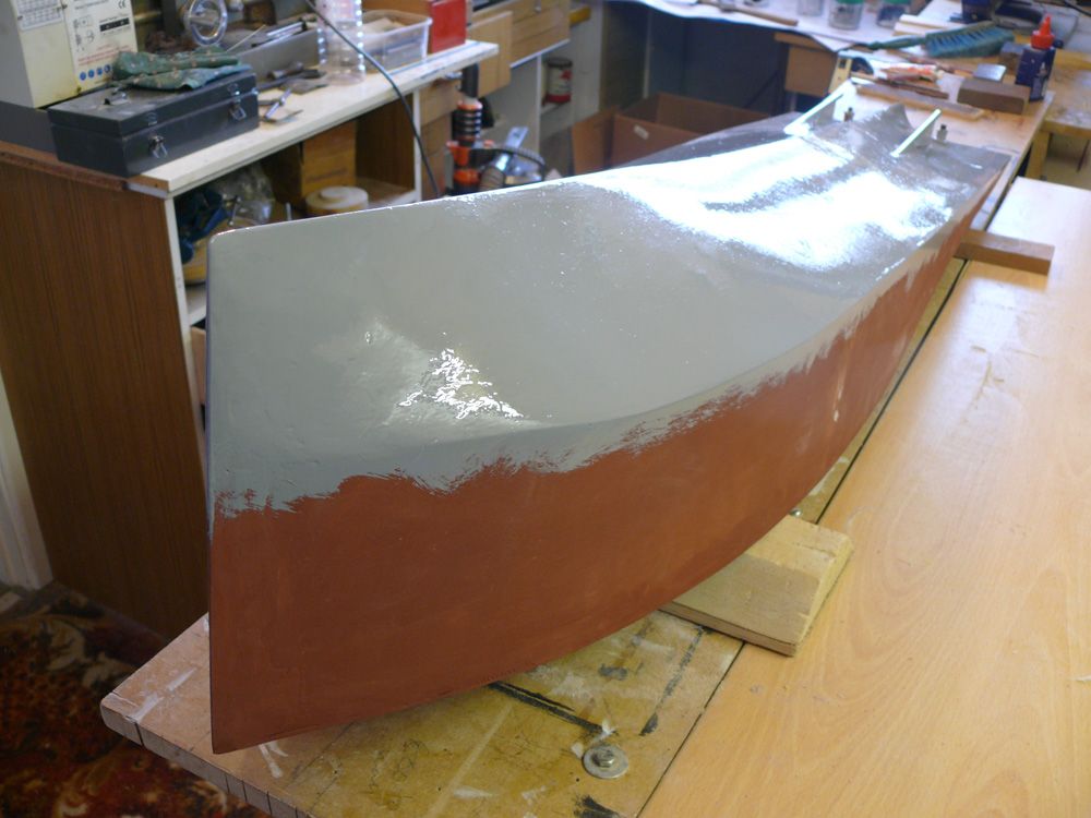

              Went to the DIY shop and couldn`t get two shades of gloss grey
              So, I got a tin of white and a tin of black……Which turned out to be a great idea!
              Because I was able to mix my own two shades that looked just like Paul`s colour requirements!
              I abandoned the Halfords spray paint idea………Too anti social for indoors!
              #47178
                Admiral Bob
                The 'red oxide' has helped show off the curves and I am very happy with the way that the chine just melts into the bow.

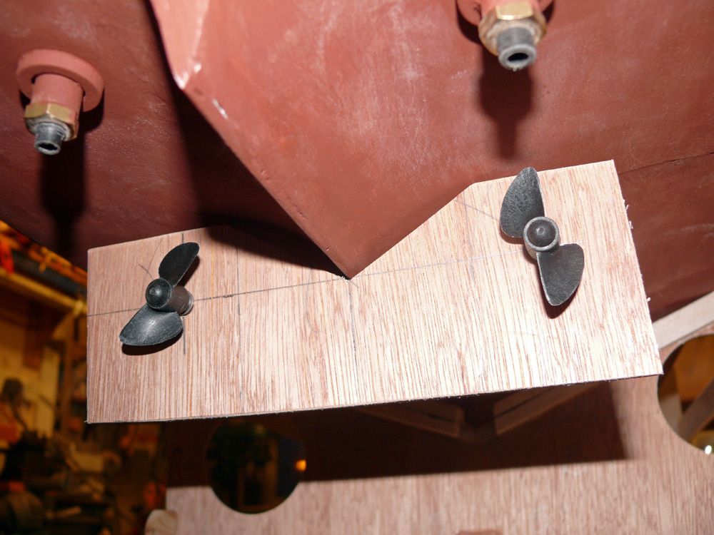

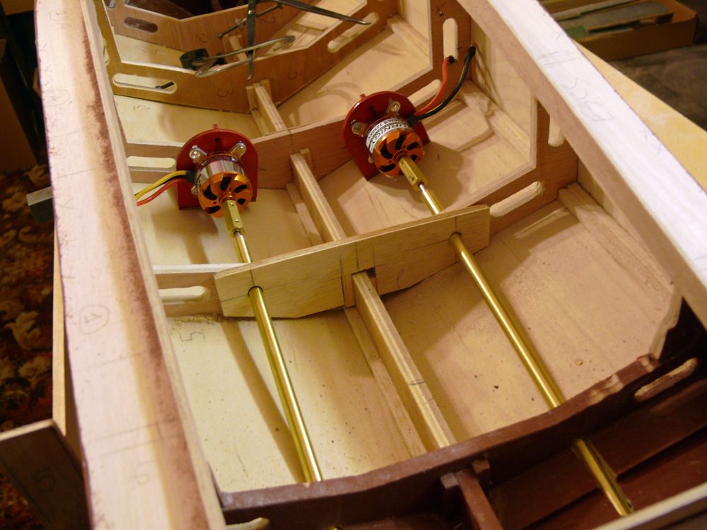

                  The propshafts have turned up and I`m in the process of installing them right now
                  For the benefit of the readers, this is my preferred method…….
                  I make a template for the motor end and one for the propeller end, with the propshaft centres drilled and with a central feature, like the keel, to centralise the fixtures
                  Motor template
                  Note central location. This template will be glued in position permanently
                  Packers will be made to align the motor axis and glued in position
                  Propeller template with central location
                  #47180
                    Question……..
                    Are we supposed to grind flats on the motor shafts for the grub screws to drive on, or do we rely on the grub screw acting as a clamp?
                    A flat on the motor shaft may upset the high speed motor balance?
                    The same applies to the prop shaft

                        Bob. As you are dealing with a modicum of power here, I would say that a flat on the shaft may be a good insurance against slippage.
                        Dont recall seeing many flats on motor spindles, but this may be more due to bumping up production costs rather than necessity, what size are the shafts?? if they are a reasonable size I should think a small flat would be good, cant imagine upsetting balance too much. I have seen motors wit flats on now and again.
                          The first port of call should be the motor / propshaft manufacturers but in the absence of any such information and instead of grinding some flats you could simply grind shallow groves lengthways on the shafts, providing you don't go to deep and cut an equally spaced set of groves ( like cutting a knurl) you shouldn't ruin the balance and you would give the grub screws something to grip.
                          #47186
                          Trevor Holloway
                            @trevorholloway99134
                            One small flat (2mm x 2mm) the right distance along the shaft should be fine and will give enough flat for a grub screw. Its only a miniscule of metal removed but taken up by the grub screw sitting nearer the shaft centre line. I sincerely doubt any device could measure the difference in the out of balance vibration.
                            #47187
                              Thank you, chaps, for your comments regarding the motor shaft drive flats
                              That`s what I would have done myself really……Just making sure I wasn`t missing anything

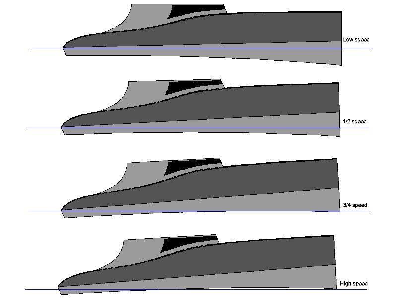

                                      #47199
                                        Hello Paul
                                        Let's have a talk about the sailing characteristics of Brutus?
                                        I know it's too late now, and I'm not that concerned about failure and I realise, this should have been discussed before we started the build…..etc
                                        The stern is only 12mm deep!……If that!
                                        On your drawings, all the heavy stuff is at the back!…….Why?
                                        The waterline looks to be on the joint line of the rear hatch?
                                        Is this the spec the Goblins thought up?
                                        I have complete faith in your design skills and await the results with great anticipation!
                                        I am amazed that at such a late stage of the build, I have only just realised my trepidations and I am further amazed that none of the readers have cast dispersions either!
                                        Luckily, if things go wrong, I have a cunning plan!
                                        Fit the outrigger sponsons, I mentioned at the start of the build, as suggested by the Fairies that live in my workshop!
                                        All good fun and it adds interest to a very exciting project!
                                        Now then, readers!…….This is your chance to shine!………Is the future……Success or failure?
                                        Doubting Thomas
                                        #47201
                                          Bob. The landing craft i am building for our D-day event is 5 feet long and 1 foot wide, It is flat bottomed, I will be very suprised if it has a draught of more than 3/8".
                                          Brutus is wide and flat at the rear, it has increasing levels of bouyancy forward (due to the in itial very thin footprint on the water `coz of the axe bow. Paul says he expects it to float levelish (cant remember the exact attitide) and i would fully expect that to be the case despite the size and apparently low rear end, based on my experience.
                                          I cant see that you will need any ballast at all, but should leave scope to move the batteries about to correct any list, or to obtain a better attitude when at speed.
                                          As to how it will go…not sure.. it may be fast but keep a substantial portion of the bow in the water, unusual for a speedboat, but this is an unusual front. Turning performance..who knows? but the centre ridge and shaft skegs should help.

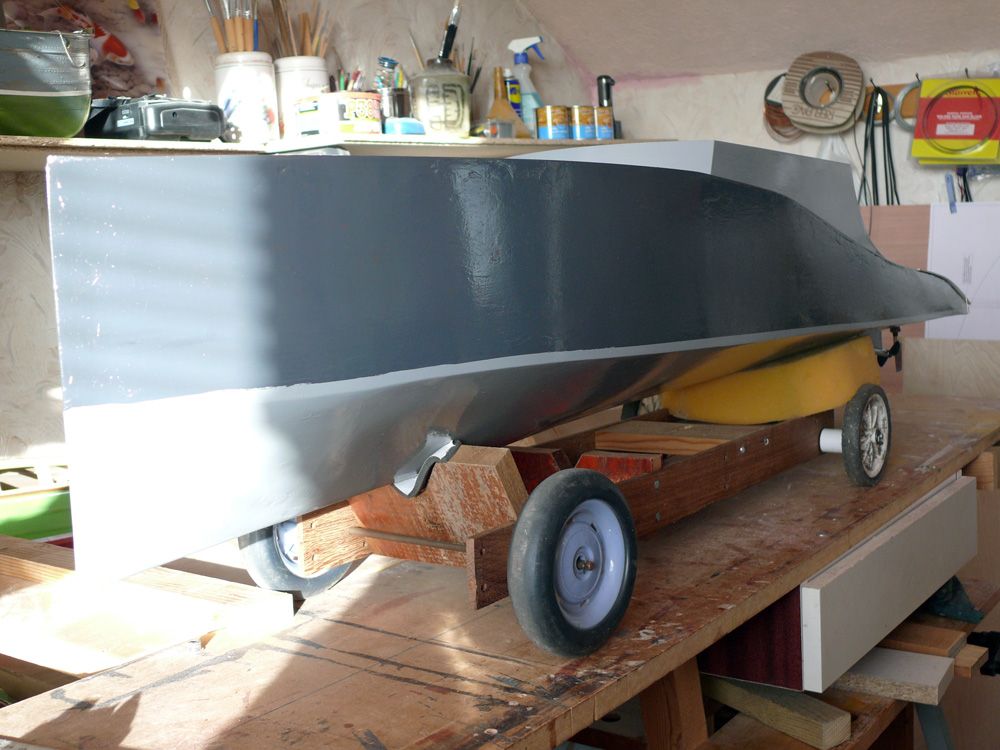

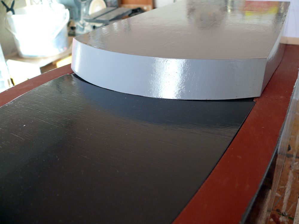

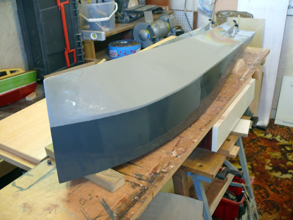

                                                Latest WIP pictures
                                                Hull dark grey painted……..Needs a separating line, as the Sellotape line is not very crisp
                                                #47205
                                                  Doubting Thomas
                                                  You are having the same thoughts and worries that I had back in October but Brutus should float fairly high in the water and as the speed increases the model should rotate around the mass of the motors, hence having the equipment where it is. The addition of the cooling fans has changed the characteristics slightly so there will be the need to trim by moving the batteries once the model gets on the water.
                                                  The colours look very good and I don't think that you need a dividing line between the upper and lower hull but if you do decide to use one I would suggest a very thin black pinstripe.
                                                  #47227
                                                    I think..NO pinstripe. Get a good crisp line there Bob. Decent masking tape, rubbed well down on the edges.
                                                    Pity, but a sprayed finish, black on the top fading to grey on the bottom would be spectacular, in an understated way.
                                                    #47231
                                                      Thank you Ashley
                                                      Haven`t got time to rub down and repaint…….The Ellesmere show is only one week away!

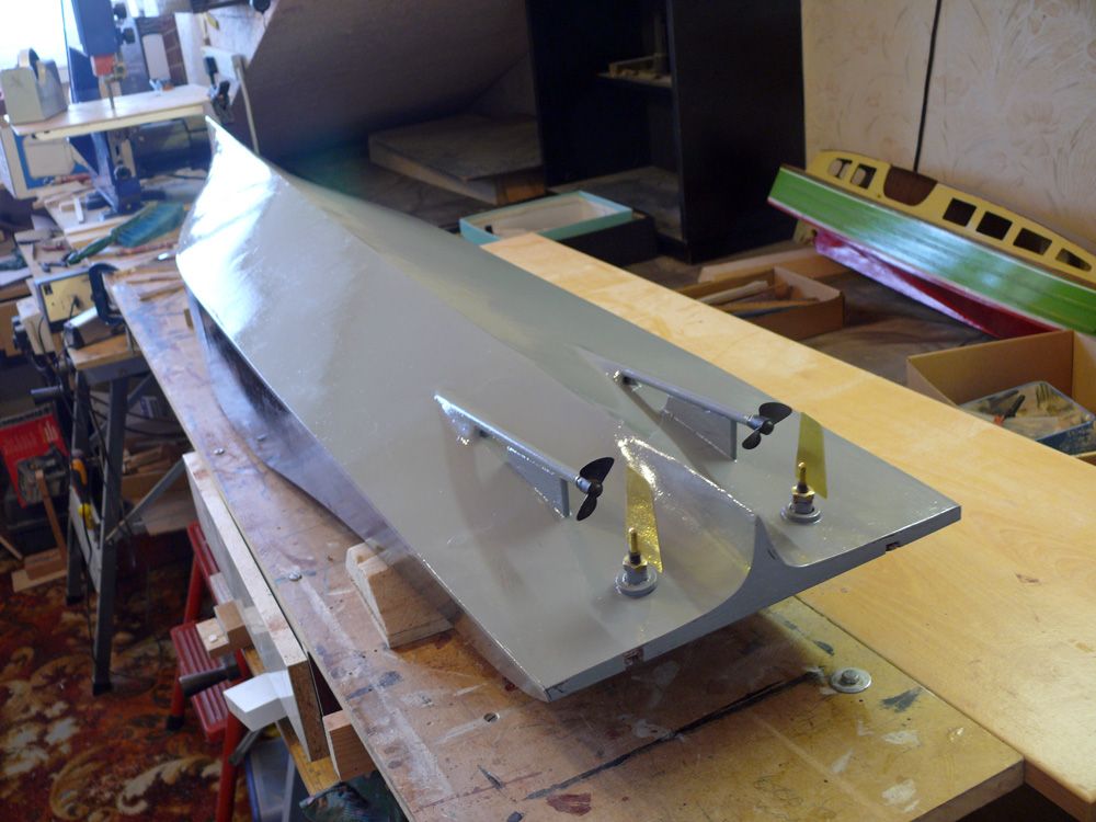

                                                      Latest stage of play…..
                                                      Need to make a means of transport……
                                                      Going to assemble the rudder mech through the hatch, to see if it can be done
                                                      No access for a screw driver, you see

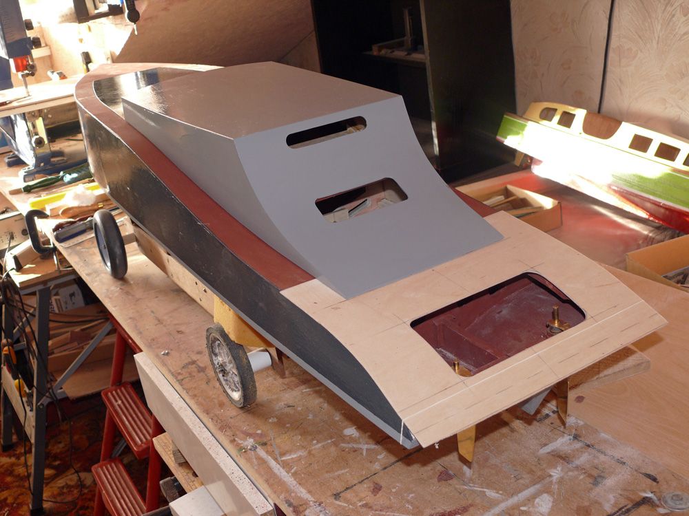

                                                      Shop floor to Drawing Office
                                                      We didn`t bargain for this!……..The Windscreen is in conflict with the foredeck!
                                                      We can either….Sand it away or build the windscreen up on either side?
                                                      Need your expert advice, please
