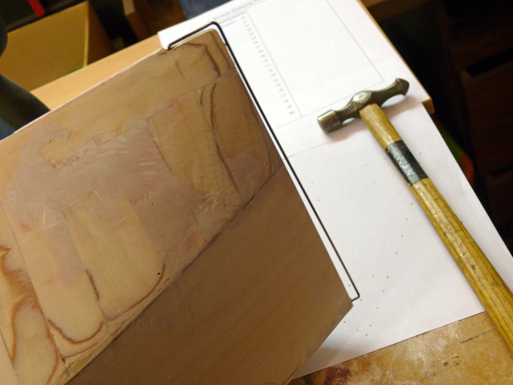

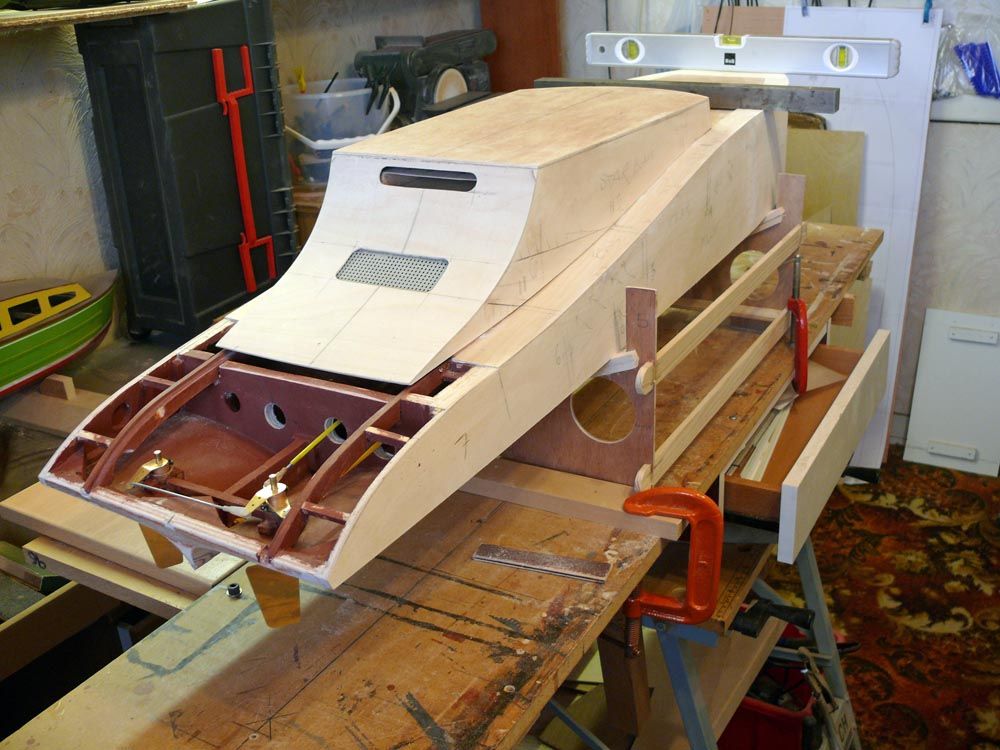

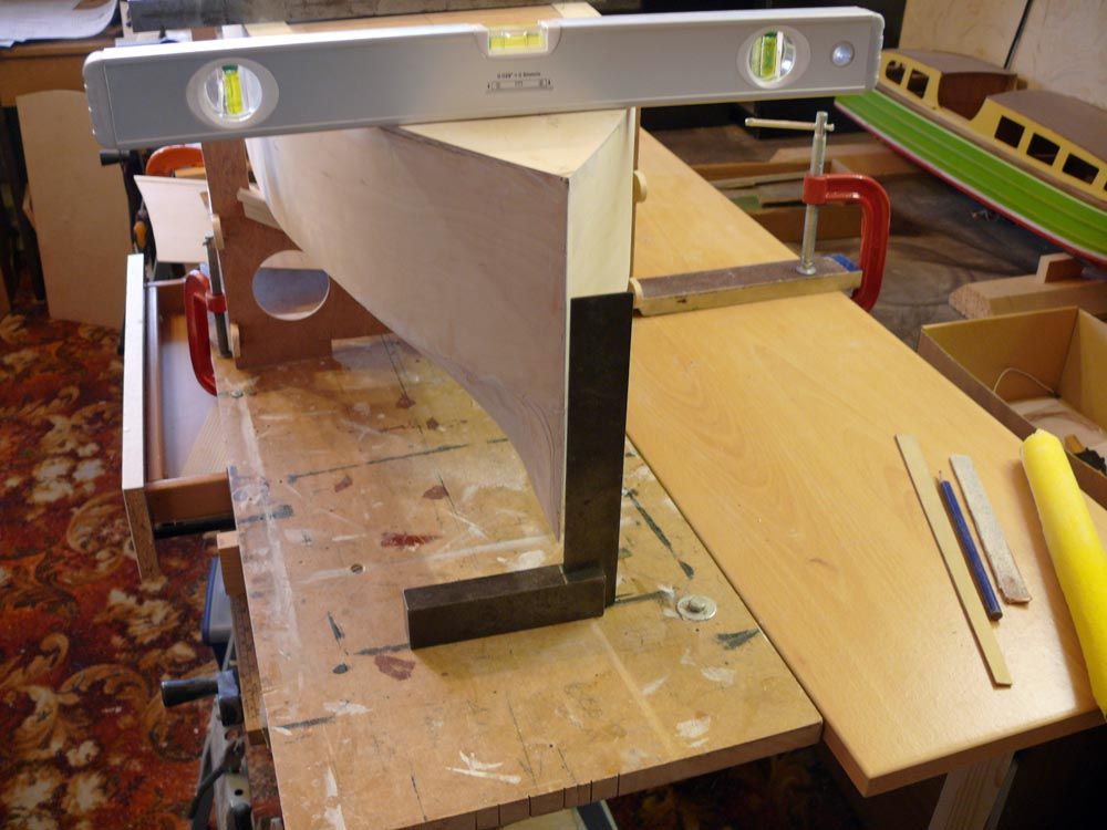

          Work in progress pictures to keep Head Office happy
          Squaring up and sharpening the Axe edge!

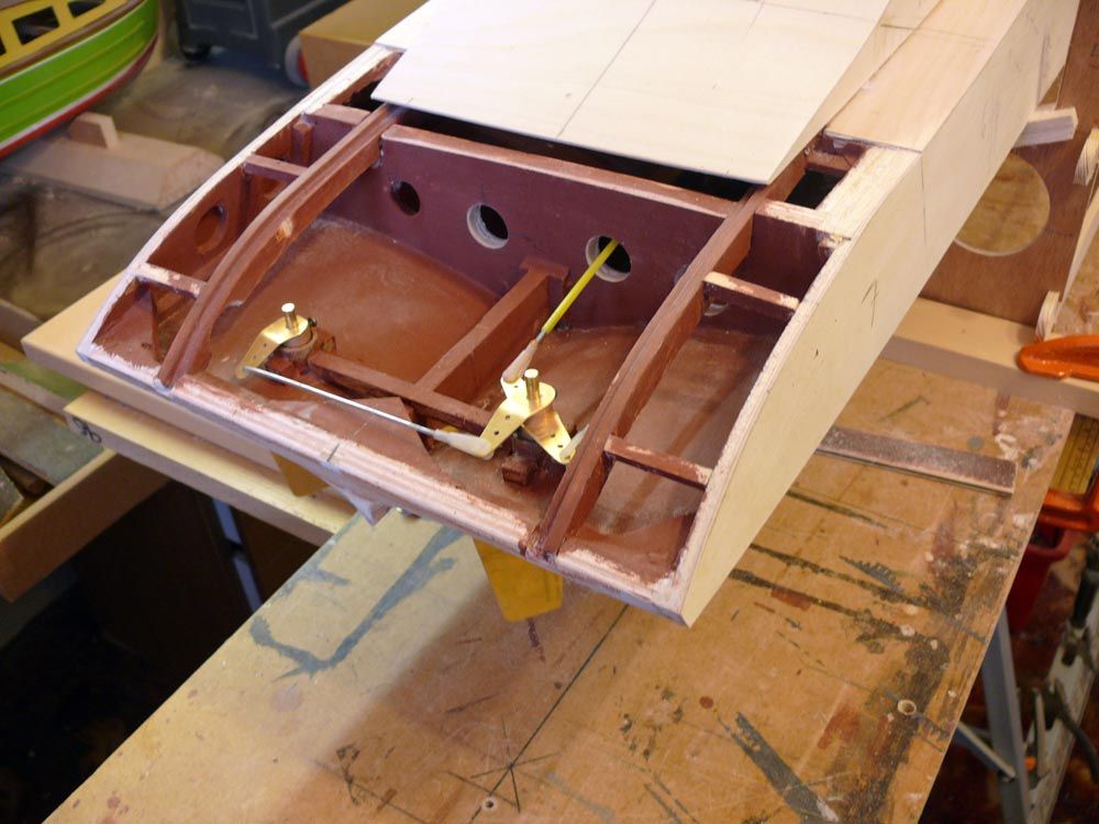

          The rudder mech is now finished……..Just trying to pluck up the courage to glue the stern cover on!
          Just a nice general view, showing the unusual lines of the hull
          #47122

            #47124
              Thanks Paul
              Not glueing the cover on yet, until the pro shafts are in!
              They are due any day now
              Living with the build for the last two months, has made me Blasé to the outrageous shape of your Masterpiece!
              It should attract a few funny glances at Ellesmere Port if they don't know about this website!
              #47125
                You aren't going to seal up the tiller connections are you Bob? I always make it a rule to ensure that all the internal gubbins are accessible for maintenance as at some point in the future you can bet your life they will need to be!
                What if you have an unfortunate collision with something underwater which bashes the rudders and distorts them?

                    I am using nylon tillers, I have said this a dozen times. They can be fumbled on blind and adjusted "remotely", the way to go.
                    #47132
                      The prow is unusually sharp but is quite fragile when it comes to slicing models in half, including the occasional steam plant!
                      So we`ve embedded a length of 1.5mm piano wire in, to give the axe edge a slight advantage!
                      To get the wire to bend round a sharp corner……It need some persuasion!
                      Ha! Ha!………Bob in the Smithy with the coke fire roaring away
                      #47135
                        Hello Colin
                        Only just spotted your post, apologies for replying earlier
                        The gibbons are accessible really…….But…..
                        We have two motors…..Don't need any rudders?
                        Ha! Ha!…….Bob

                          Your hammer's too small, Bob
                          (just thought I'd add a really constructive comment to the debate)
                          #47138
                            Thank you, Amy…..Happy Valentines Day!
                            That was a surprise, eh?
                            I really enjoyed tapping that wire in place!
                            Any progress with your project?
                            We are pleased you have a workshop now
                            #47141
                              Bob , Personally I would leave the wire off. If you bash something, the bow will still dink due to the large weight and hence momentum, It will then be more tricky to repair as the wire will not straighten properly…WHEREAS if the bow was just wood you slap on a bit of P38, sand, paint and its like new again.
                              Just a thought.

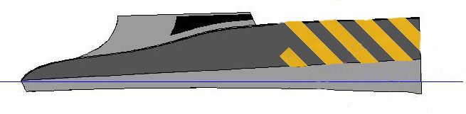

                                              Shop floor to Management Suite
                                              Health and Safety are not happy with a grey and black high speed Chopper!
                                              Too dangerous!, they said and are threatening to axe the project!
                                              Fellow boaters will not be able to see the Beast of Etherow clearly and quickly enough!
                                              They've got a point, Paul
                                              We can have a grey and black boat, but it will need Yellow hazard stripes at the cutting edge of Technology!
                                              What shall we do about this possible hazard?
                                              Bob……..Bearer of bad news
                                              #47158
                                                Bob. Are they joking? They have NO point. A jet black boat should be easily visible, and its no small size. Why not ban grey warships then?? They are even less visible. Ban subs !! ban motorised ducks !! ban ban ban
                                                This is precisely why we do not have a club at Bushy Park. Anyone who could not see such a large black boat should not be on the water, in any event, you will be controlling it, it is not as if it will be free running.
                                                Sail somewhere else. You would not believe the variety of craft what will be in our pond this morning.
                                                #47159
                                                  Well you big puddin`!….. Ashley……You fell for that one alright
                                                  Hook line and ballast!
                                                  What a pity it`s not April the 1st?
                                                  I think it is a sensible suggestion anyway?
                                                  #47160
                                                    I don't think the Drawing Office will be too keen on that Bob….
                                                    Looks like you've repaired it with parcel tape.
                                                    #47161
