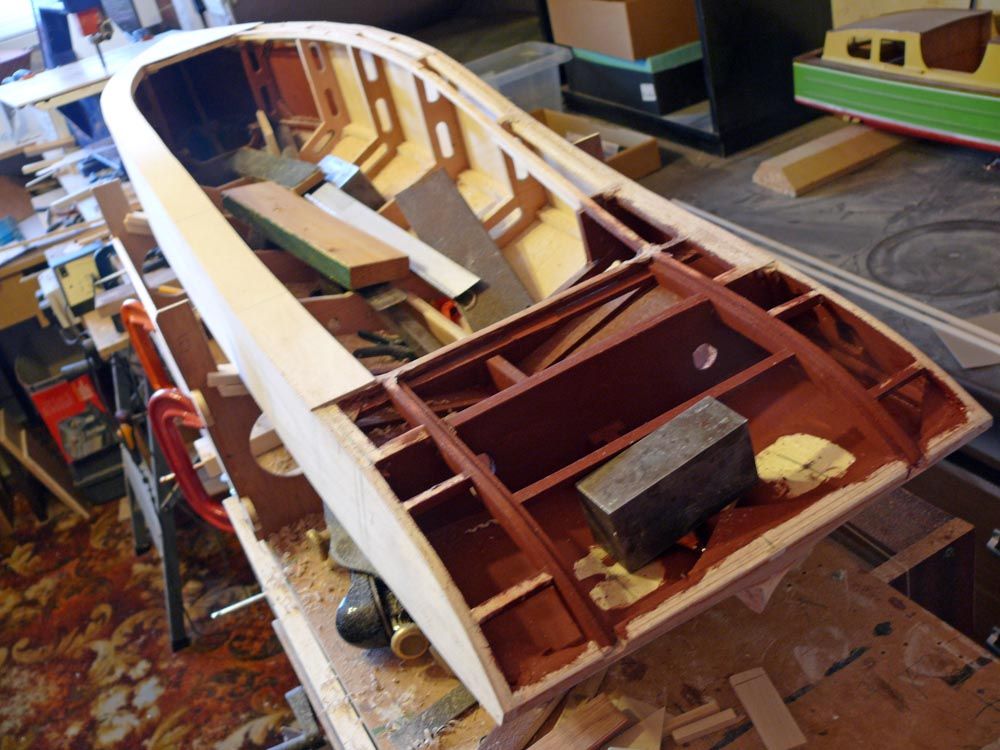

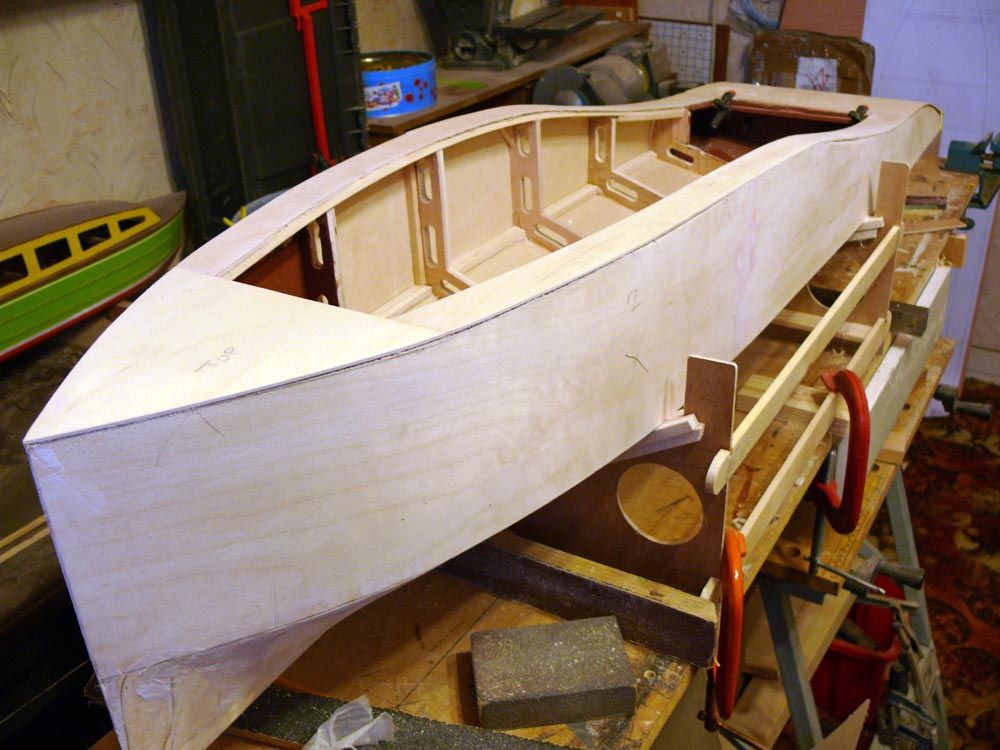

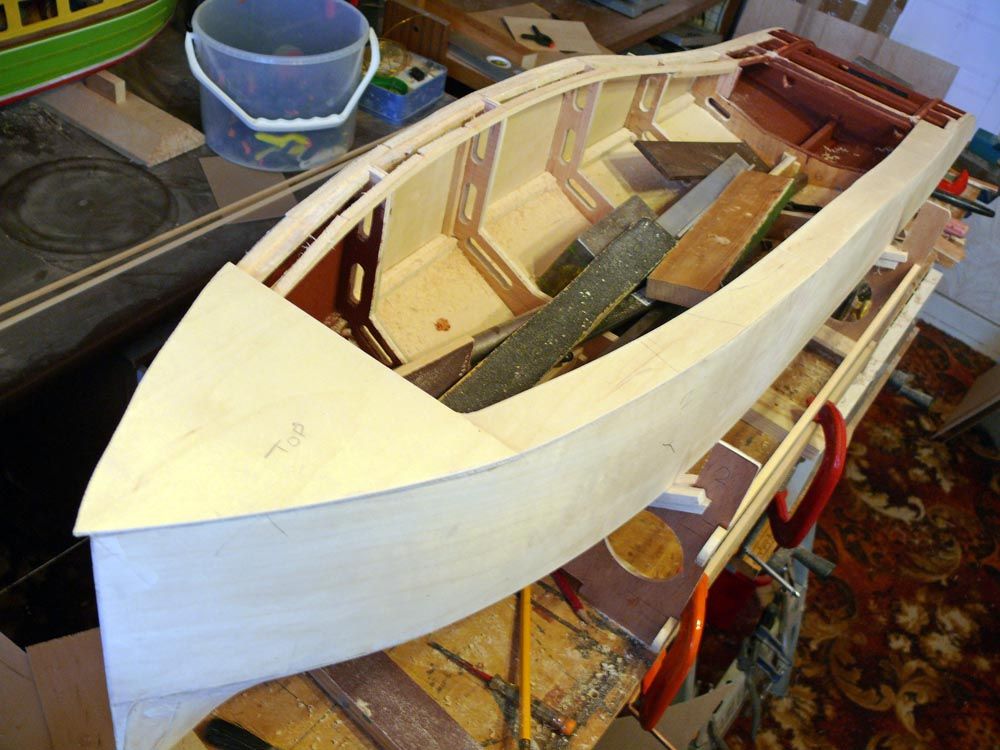

                    I`m so pleased how things are shaping up, that I had to show Paul the latest of manufacture!
                    What do you reckon, Paul?
                    It would be very interesting, should one or two of you chaps out there, had a go at building this very unusual and exciting model

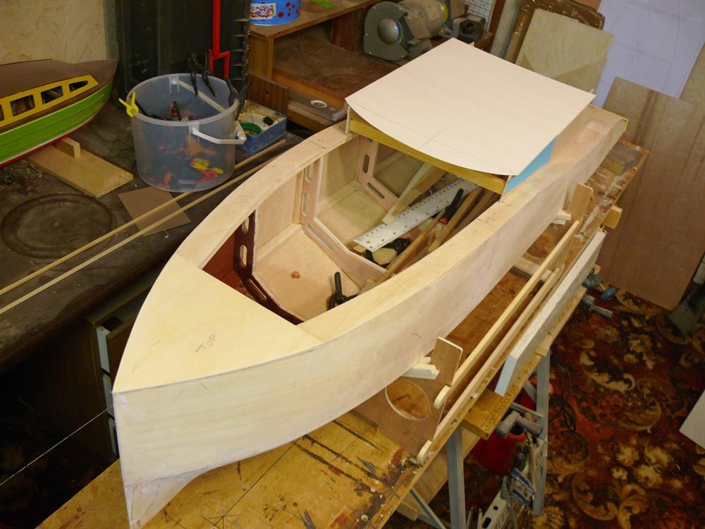

                            Well, the motors have finally arrived and I`m looking at them in utter amazement……..495 Watts!
                            At the moment they are a complete mystery to me….Nicely made though!
                            Plus a picture of the decking, thus far

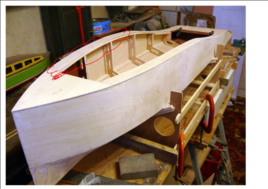

                              It never ceases to amaze me how a slight change in camera angle can create an optical illusion, looking at Bobs photo above you can see the R/H side deck is nice and flat all the way back to midships but have a look at the L/H side deck….there is a distinct illusion of a curve.
                              I know that there isn't a curve but the illusion is very compelling
                              #46922
                                You had me worried there, Paul
                                The deck is flat up to Former 3
                                I want to build up the coaming from the inside of the designed deck opening. So that the coaming is 6mm high and the cabin straddles the coaming rail. The cabin then rests on the deck.
                                The cabin is still the same width as drawn
                                The loose front deck will be sunk in and rest on ledges inside the hull,
                                The cabin will rest on the deck along the sides, but will rest on the foredeck and rest on the rear roll top cover
                                Do you understand my proposal?

                                  Yes I understand and I am all for it especially if it makes the build easier.

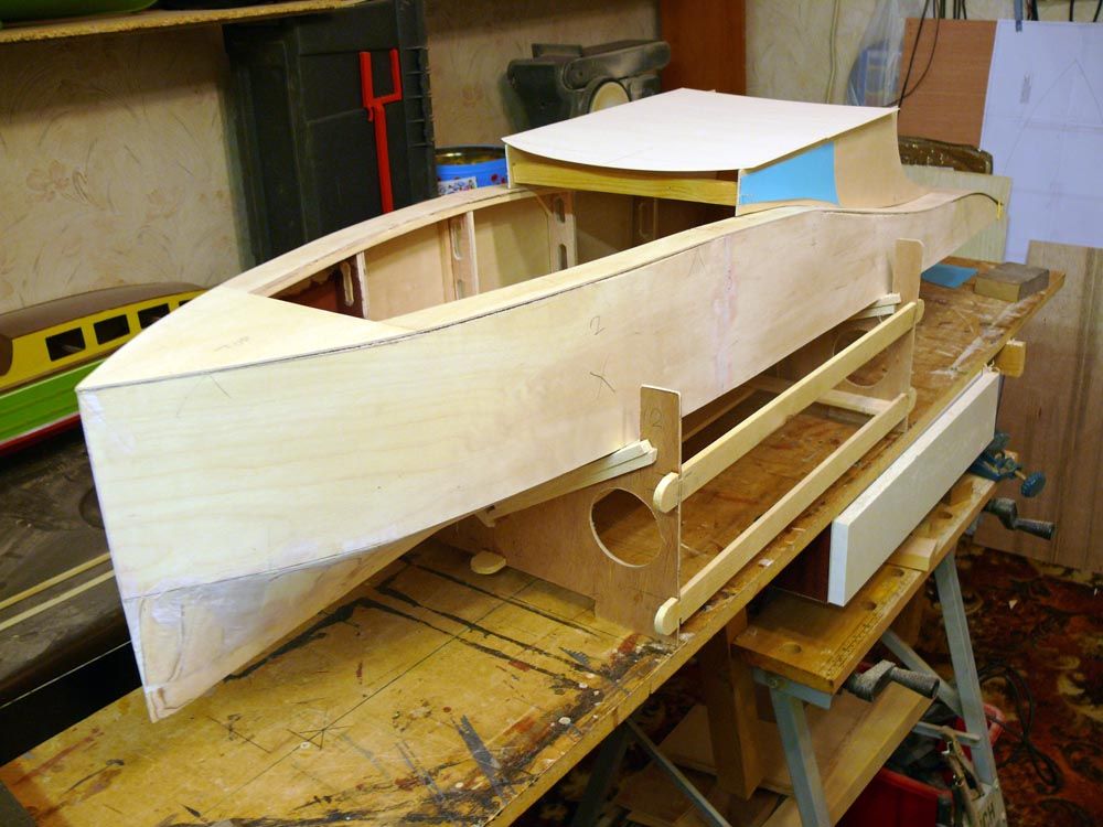

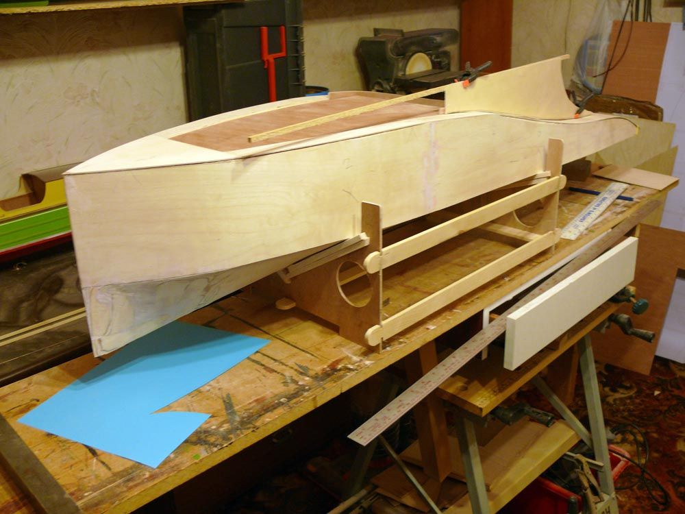

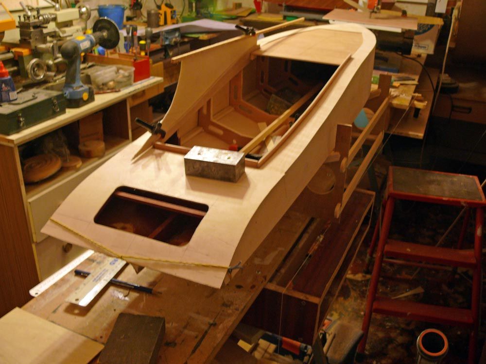

                                    Made some progress today, developing the cabin structure……..What a picnic we`ve had!
                                    The windscreen area follows the roof curve, but it is in fresh air at the moment
                                    The deck top make be extended and go under the cabin…….Well that`s what I`ve come up with anyway!…..Paul is still scratching his head!

                                        You cant beat a drop of Humbrol! it even wet`n`dry`s well after a period hardening. I would be in favour of Halfords spray paint to get a nice even finish to set off the slab sides …do they do a satin black?
                                        I am concerned now looking at this build that when at rest or slow speed it will look just like A.N.Other slipper launch and the snazzy main feature (the wave-piercing bow) will be hidden and so lost.
                                        An upturn or rise at the bow (on top of course) would make even more of an impact on the novel front design when viewed on the stand and also look that much different when on the water.A slight negative rake , even if only applied above the waterline would also add low speed impact (if you see what I mean..).?
                                        If you are going to have a feature…have a feature and make it large.

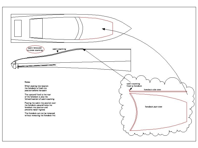

                                                The cabin mock up looks just fine but the following detail will help the readers who might not know what we are talking about .
                                                Regarding cooling the motors I don't know anything about these brushless thingies so you will have to tell me how much heat, if any, these motors generate.
                                                I'm not a fan of louvers as they let more water in than warm air out but if those motors need fresh air then I will have to come up with something.
