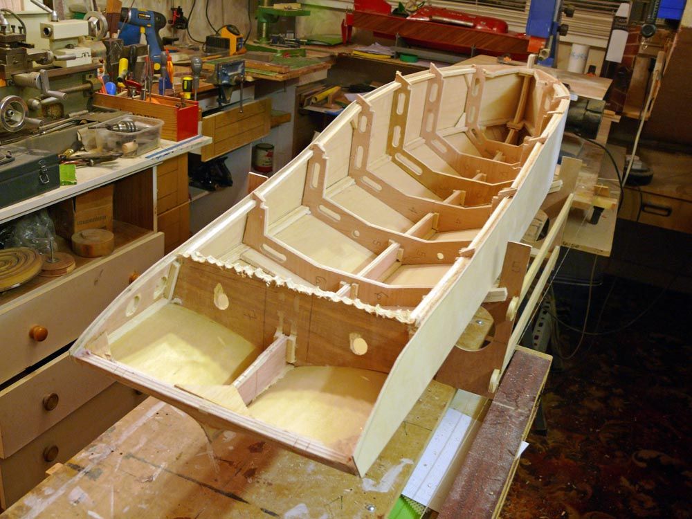

                            Just another picture of Brutus emerging from it`s Chrysalis and the new stand
                            The stand has proved an essential piece of equipment, as the sharp edges of the stern and bows are very fragile, due to their thinness
                            Might have to build in some reinforcement, like brass wire?
                            Former no7 looks rather clumsy, Paul……Shall we lighten it?

                                          Brutus looks very lean and almost fragile with its building frame removed
                                          There is a lot going on around Frame 7 so it needs to be chunky to withstand the various forces that are acting upon it.
                                          How and where do you propose to reinforce with brass wire?
                                          The changeover from combing opening to recessed opening occurs at the front of the cockpit, in essence the foredeck opening is flush fitting where the cabin slots onto a combing. Its covered in the drawings but I am thinking of changing removal of the foredeck from a vertical pull out to a horizontal slide (a bit like a pencil case)
                                          Don't worry about the lack of a keel as the boat should behave like a canoe at low speed and normal speedboat at high speed, don't forget that the fairey boats don't have a keel.
                                          #46777
                                            Hello Paul
                                            I was thinking of sinking 1mm wire into the leading edge of the prow knife edge
                                            The rear knife edges will be protected by the protruding props

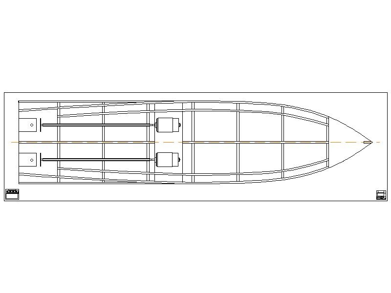

                                            Have you done a plan view of the hull showing the formers and the stringers etc
                                            #46781
                                              Sinking the wire into the leading edge is a good idea and will certainly add some strength to the bow. If you don't mind I will include it as a recommended procedure within the build instructions.

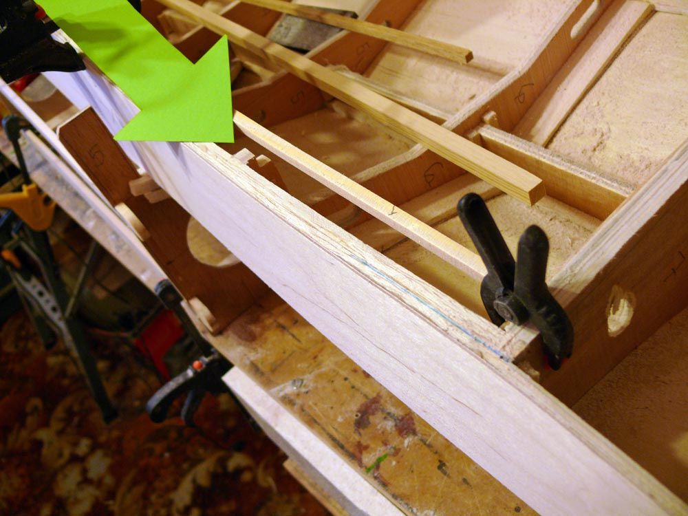

                                                Just noticed that the inner stringers are not running right at former 6, I think the former is not quite right
                                                Please check and report back, as I would like to glue the stringers in tonight

                                                    Sorry Bob but I cant see a problem on the drawings but this doesn't mean that there isn't anything wrong. Can you temp fix the stringers to see if there is something amiss.
                                                    #46785
                                                      The problem is with the notch on F6…….It`s about 6mm out
