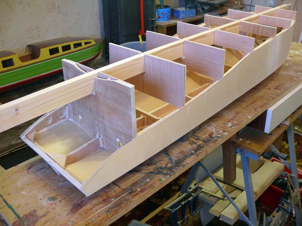

      I can get the concavity out when we turn the hull over……No access at the moment

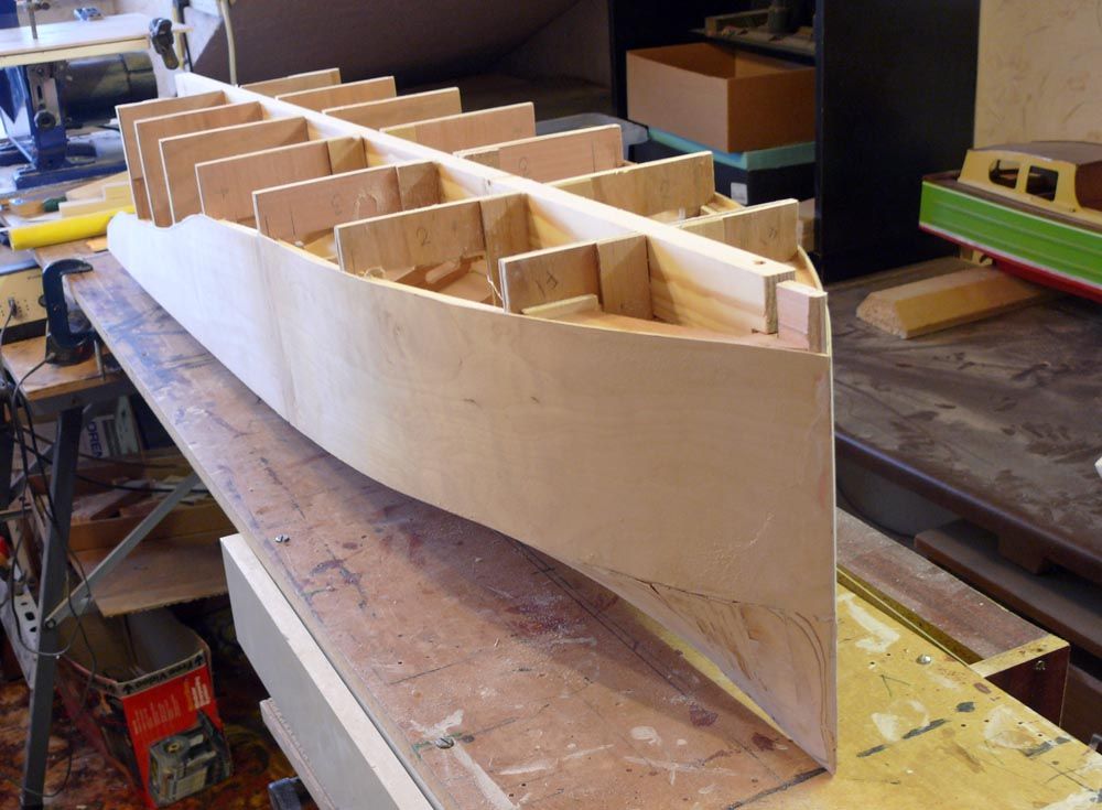

      Fixing the final hull side in place, to use as a guide for the tricky bow section
      Edited By Bob Abell on 26/01/2014 14:19:30

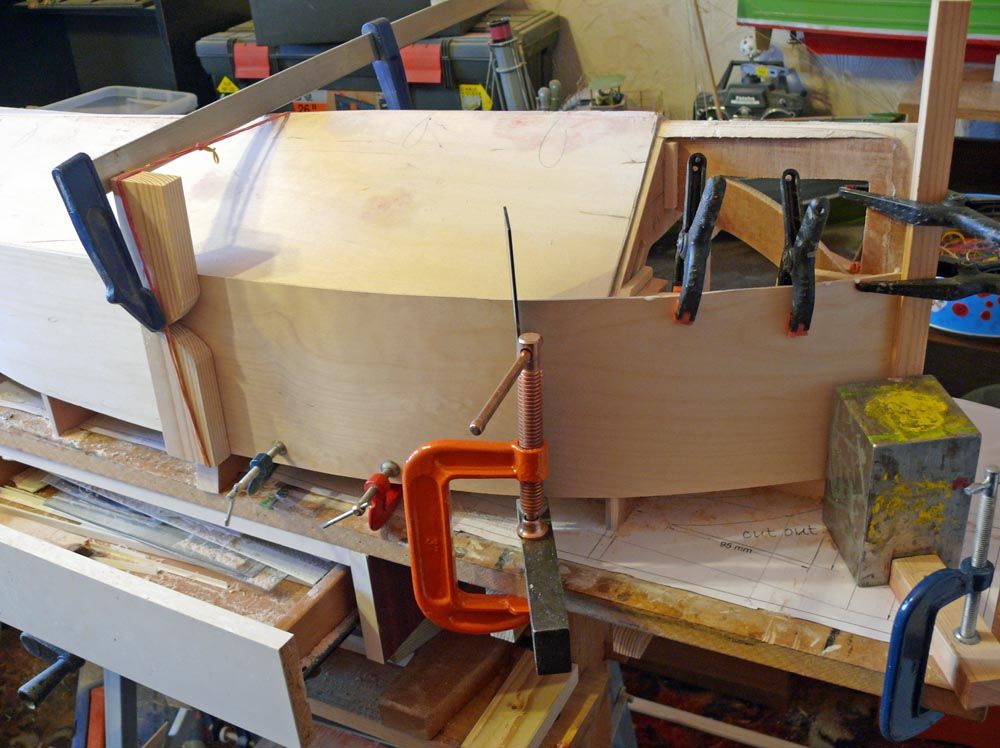

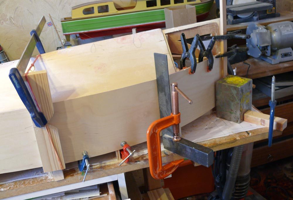

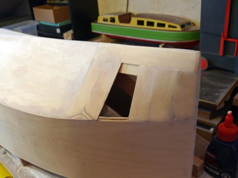

                      Work in progress on the Bow skinning
                      Using 1.5mm ply with twist and it seems to be progressing well?
                      Notice the backup lips for supporting the ply pieces
                      We`re getting there….eh?

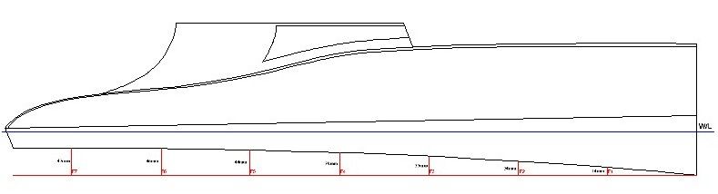

                            The dims would be F3 25mm and F4 31mm, I agree that ply doublers will help with thickening the bow but most of all I agree that its not far off.

                                  These are the true dims of distance to bottom of hull

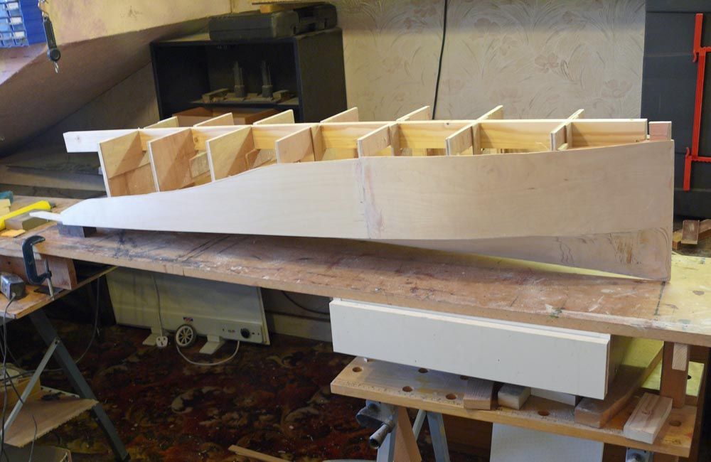

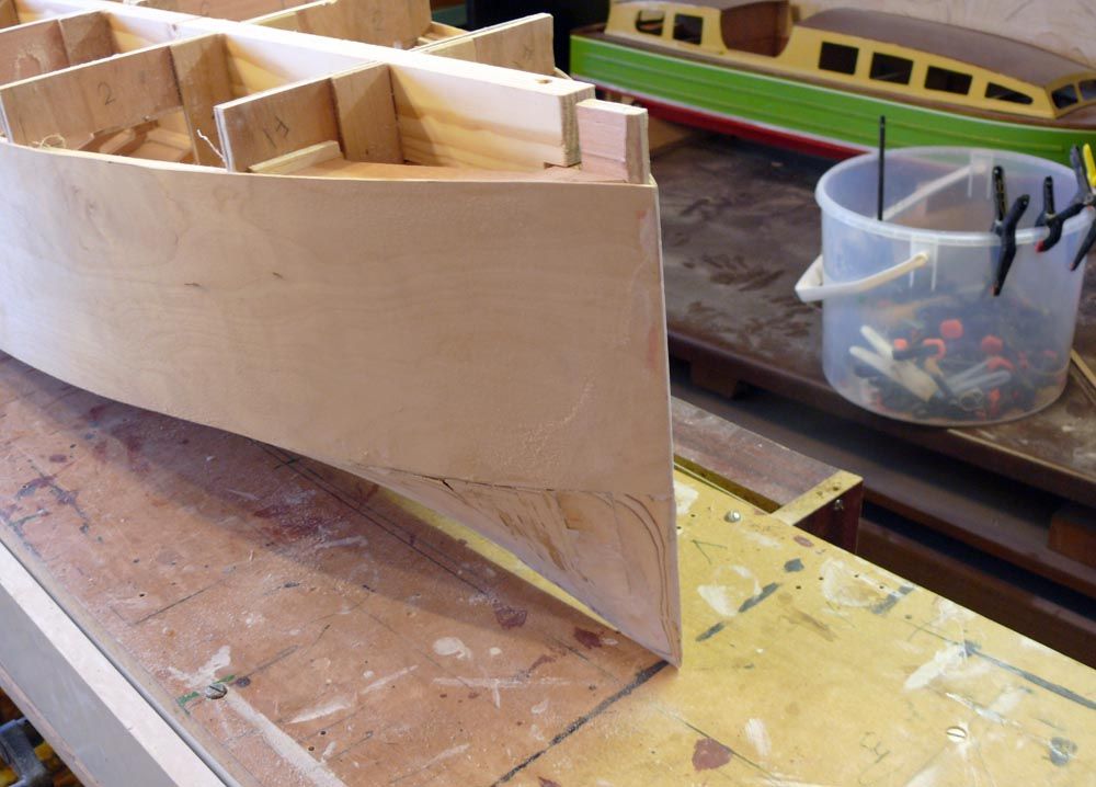

                                                In the meantime, here she is!…………..Brutus!………….Fresh off the blocks and looking Razor sharp!
                                                What do you think of your new born creation, Paul?
                                                Will look even nicer with the formers removed and mounted on a sporty stand!
                                                The waterline btw is surprisingly shallow…….It comes below the chine?………So I`ve ordered some special balsawood batteries!
                                                Paul, the dimension I was after is 15mm…….I`ve got 16mm….So we are ok
                                                #46724
                                                  Bob there is only one thing that I can say.
                                                  You have got the bow just right, I honestly cant tell you how good it makes me feel.
                                                  The watchers and lurkers might not appreciate just how much work you have put in to getting the hull to this stage….but I do and I am forever grateful to you for not loosing your faith in the design or in me.
                                                  Thank you
