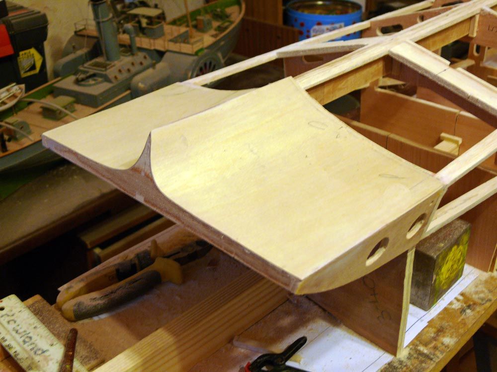

                    #46545

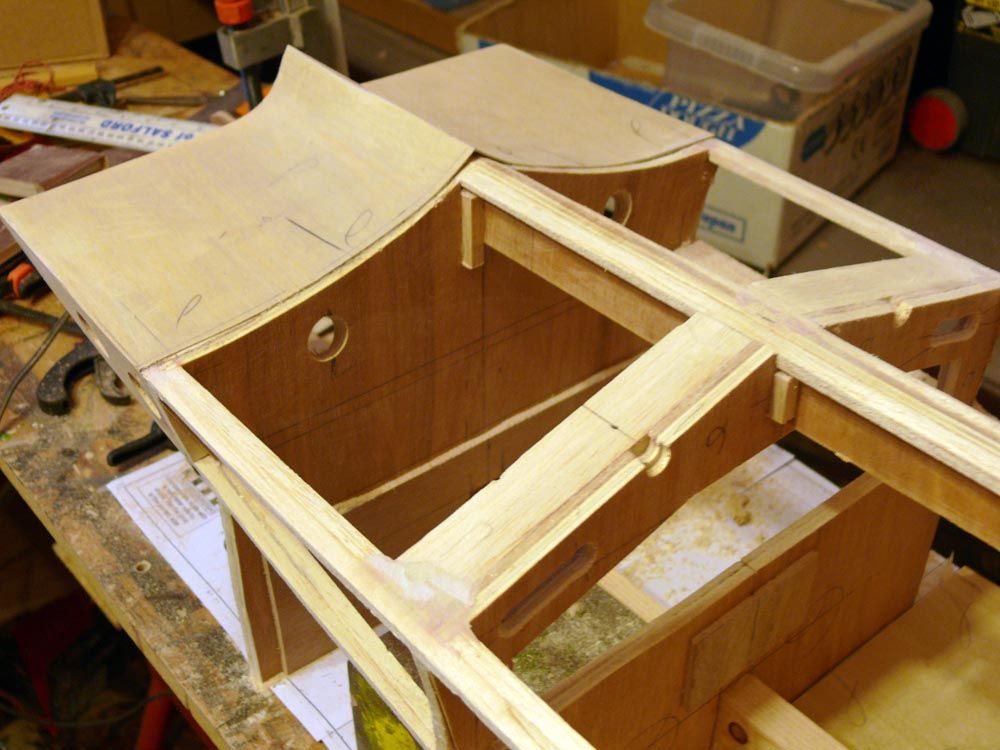

                      The tightest radius is on the transom and is 21mm, the easiest way to form the 1.5mm ply into this curve is to steam the ply and then use a small G clamp to pull it into place, it is a very easy and quick process.
                      #46557
                        Paul said it would be quick and easy!
                        But it was quite tricky and took about four hours!……….Mind you, I was watching the match at the same time!
                        It was well worth the effort though?
                        What`s the verdict, Paul?
                        #46564
                          It looks very nice Bob and exactly how I envisaged it, I don't know why it took you so long as it is a fairly straightforward procedure but I do appreciate how you might be distracted as I know how absorbing these chess matches can be.

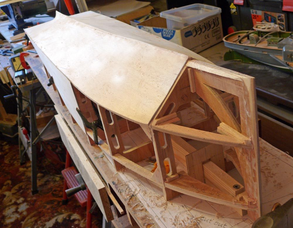

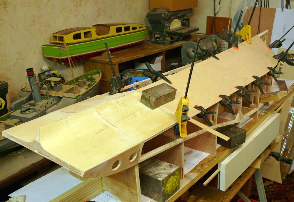

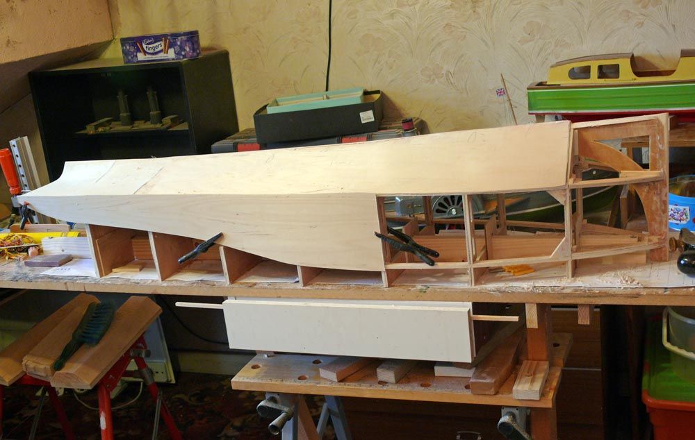

                              #46572
                                Hello Paul
                                Two pictures showing latest WIP
                                The big sheet was quick and easy!
                                Sanding the ply joints looks very untidy when the layers appear unfortunately
                                Note Ellie in the background has had a new coat…….That`s better, hey, Larry?

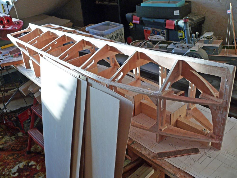

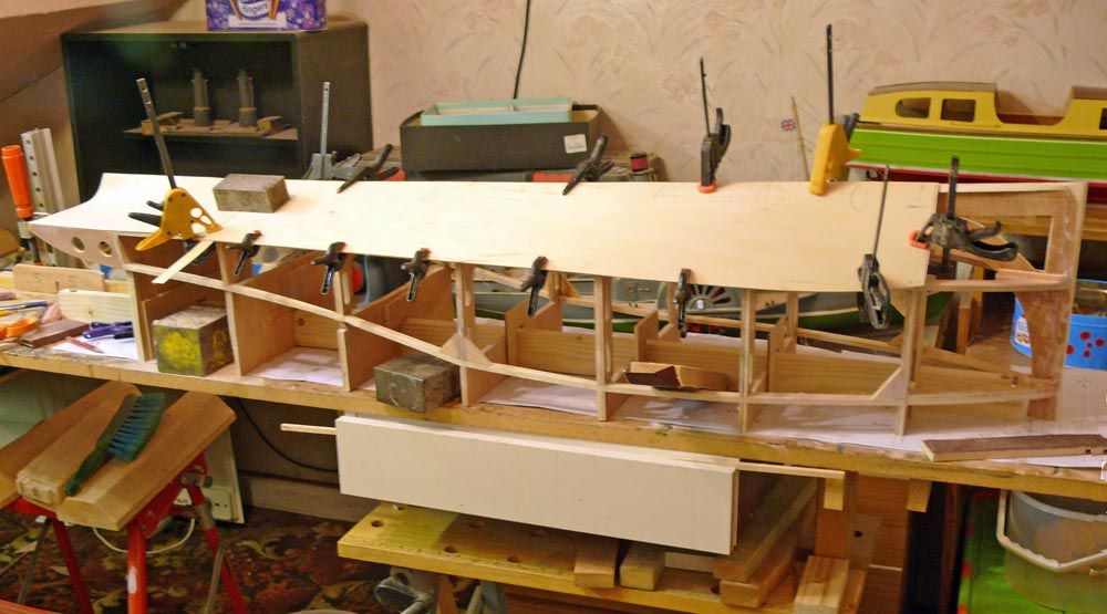

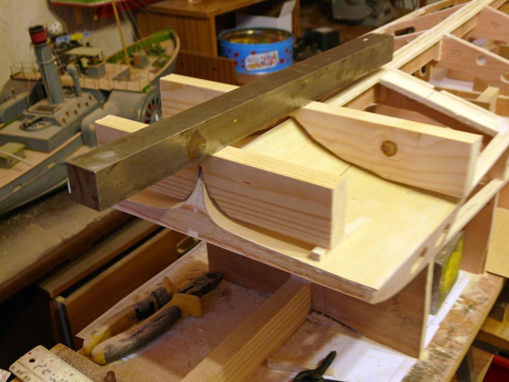

                                                Shop floor to Thomason Towers
                                                We've got the Southern Pretender here blubbering about something or other, but looking at our carcass, we haven't got a keel……..Are we happy with that?
                                                Over to you, Boss
                                                How about, jumping the gun and fitting the outer two sponsons, we discussed earlier?
                                                My humble apologies for doubting the Maestro!
                                                #46592
                                                  This is what we call…….Work in progress!
                                                  Something to feast our eyes on!
                                                  What yer think Paul? Is it as you expected?
                                                  What does anybody think?
                                                  It`s certainly unusual and as Larry said……..It`s a timber Muncher!………..and it`s great fun to build!
                                                  #46593
                                                    Paul/Bob. Certainly an unusual shape and even more so in the flesh. Cant wait to see it on the water. Looks as if it will be a bit nose heavy but I there is the extra depth below the waterline at the bow to compensate…suppose that is whats required to be a wave piercing design!
                                                    Is the keel curved or is that an optical illusion??
                                                    #46594
