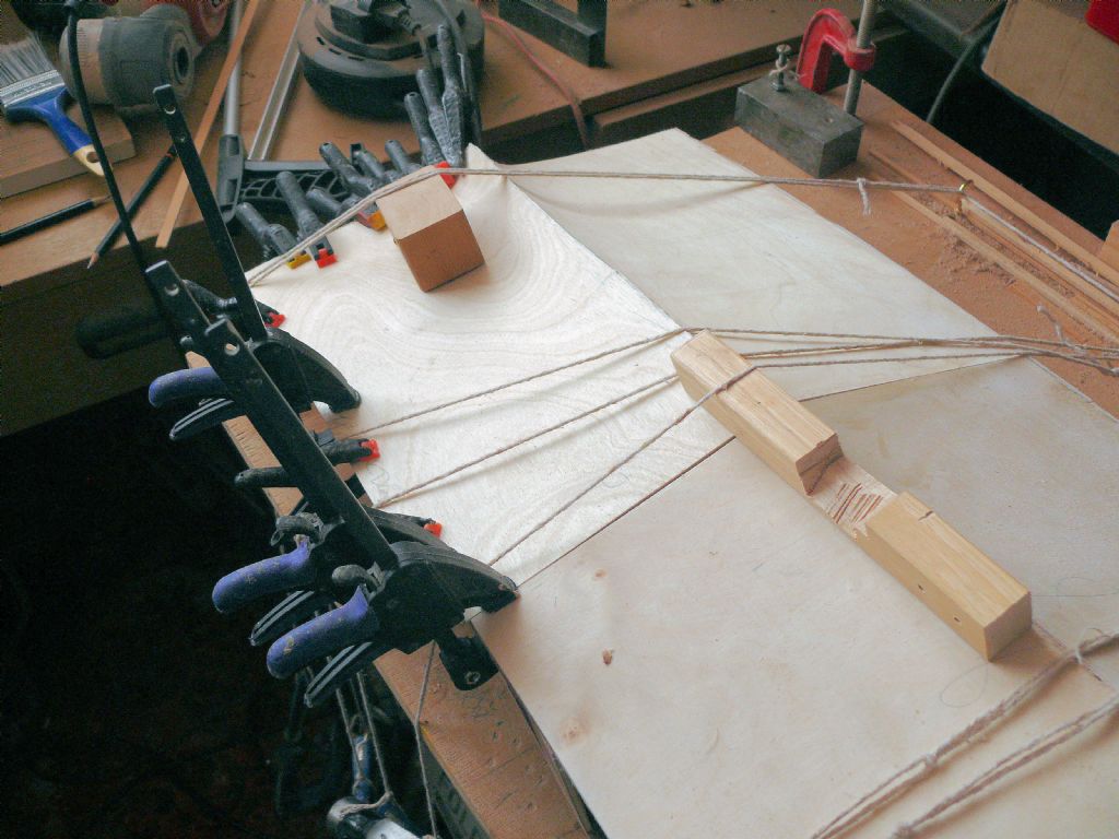

                          The Transom area is quite tricky to build. It involves flaring the 1.5 mm ply into the keel
                          The weighted string clamps were useful and the usual array of clamps
                          #89420
                            This is a masterclass in how to create complex curves by using a few clamps, bits of string and odd scraps of timber
                            Could you take a couple of photos of the transom when all the clamps are removed to show Kevin the result of your work.

                              #89422
                                Please don't rush the process as the photos can wait until tomorrow, the transom was always the trickiest part of the entire build and it takes a lot of skill to get the ply around those curves without twisting the frame.

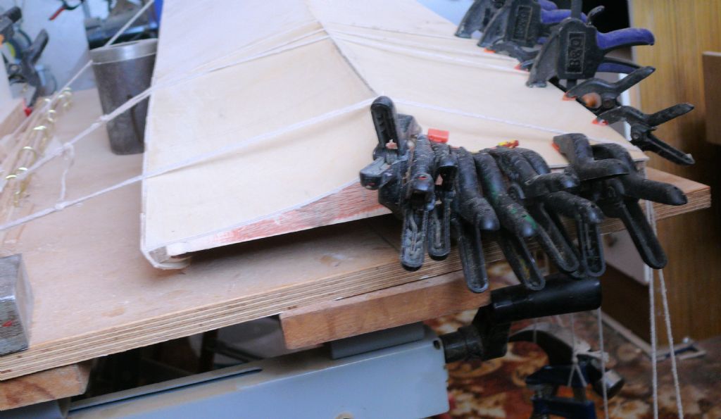

                                  Hi Paul
                                  This photo shows how the clamps are ganged up to prevent the higher clamps from slipping down the fillet
                                  #89426
                                    A clever use of basic equipment

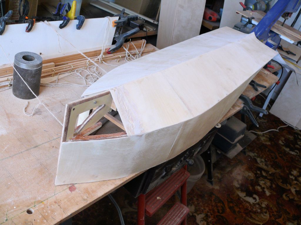

                                      This mornings photos
                                      The Transom area. This section took some head scratching, but it was well worth the effort
                                      General view, now working on the bows area. Using planks and filler.
                                      The panel joints will be hidden when the hull is covered with card

                                      #89458
                                        Hello Captain Bob
                                        You made the transom look easy but forming those tight curves into the razor edge keel is a very difficult task as the keel at that point is basically a long scarf joint.
                                        #89459
                                          Thank you, Paul, having done it before, it was a doddle!

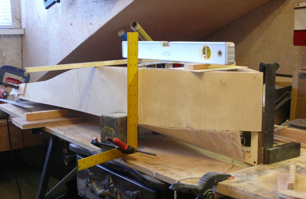

                                            Decided to make a Stand to check the hull
                                            As I was weighing up the model, the unfinished opening at the front, gave me an idea?
                                            Why not fit a pair of Bow Thrusters and do with out any rudders?
                                            Where will the water line come up to?

                                              Looks superb Bob , you make it look easy mate

                                                How are you getting on?
                                                Captain Bob
                                                These are the design water line at 4 different speed levels and as we know that these are correct from sailing the first model.
                                                At medium to high speed the thrusters would be out of the water.

                                                    Excuse me if I have the wrong end of the stick but bow thrusters are not of any use when the model is at speed even if they are in the water. They only work when stopped or very nearly stopped.
                                                    Why has my font gone so small?
                                                    Edited By Chris E 1 on 26/06/2020 16:33:38
                                                    #89480
                                                      You have already proposed to use tank steering with a mid hull rudder.
