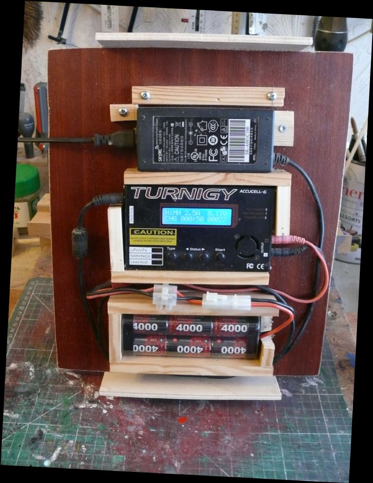

                        Hi Ashley
                        How do you like my snazzy charger set up?

                              Like the charging board, and I keep on thinking it is something I could do with, and have all three chargers ready to go rather than untangling them constantly!

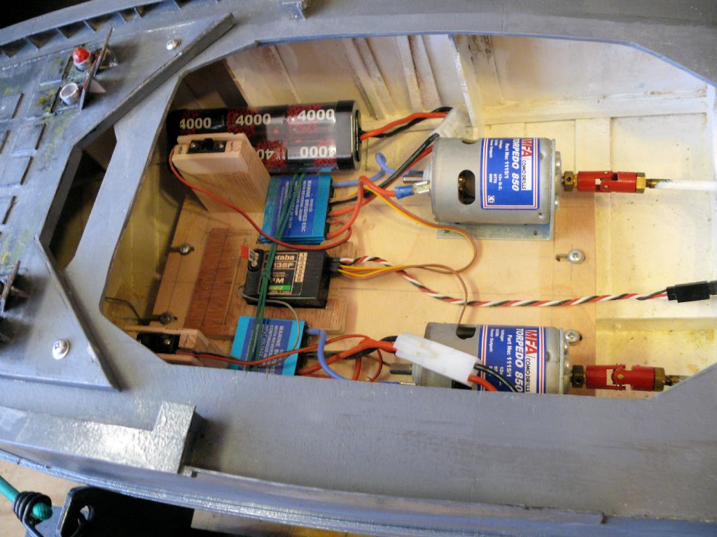

                                Here are the photo`s that Paul requested
                                Dive in Mates

                                    Hello Ashley, it is a Perkins Marine ESC-50
                                    If you reversed the red and blue leads to the motor. would the motor run the other way?

                                          Bob. Do you have a "Y" lead so the steering socket on the receiver controls both esc at the same time?

                                              Don't have a Y lead, Imprefer twin stick steering anyway
                                              John
                                              The Esc's are not mixed……..Don't fancy that either
                                              I have noticed that the prop shaft are quite tight for some reason
                                              Think this requires investigation right away
