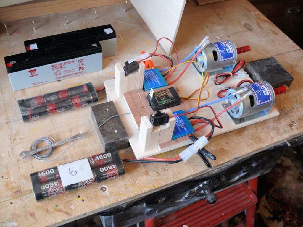

      What is the operating voltage and max amps of your speed controllers?
      #90254
        The ESC`s are……7.5v to 12v
        50 amp…….and 70 amp for a burst of 5 sec
        Just acquired on loan….
        12v batteries 1.2 Ah and 2.1Ah
        So how are we lookin`?
        #90255

            #90260
              Got the system sorted now…..Hopefully
              I know I`ve jumped the gun a bit, but needed to know how the drive chains pan out before finishing the hull
              And the Rudder mech etc
              Have the choice now between 7.5 Volt and 12 Volt available

              #90274
                Bob. The SLA batteries not really suitable for the motors and will not supply the current.
                I would wait and use the Nimh batteries as you have set things up, and see how the boat goes when on the water before buying anything else.
                I see that both esc receiver leads go to the receiver, presumably on different channels. Does this leave you with a channel for the rudders? You could get a Y lead so both esc can be controlled by the single throttle lever leaving the right stick for the rudder?? As a suggestion of course.

                #90285
                  Hi Ashley
                  It was a good job, I only borrowed the batteries
                  THe big VGC sailed Ok on the 7.5 v batteries, and I don't really want to charge about the lake either
                  Thanks for your expert advice though, my mate

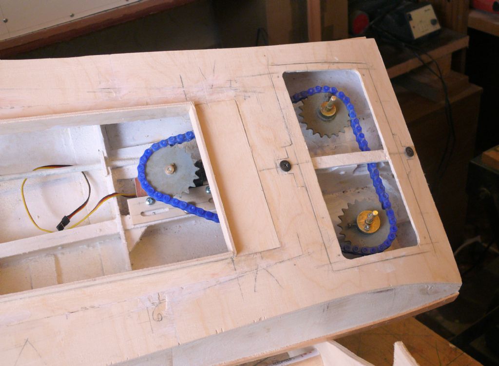

                  #90322
                    Working on the Rudder drive again now
                    The hatch is shown open and placed on the rudder shaft, just to show that the rudder shafts have top support
                    I like the chain drive method, it`s more in keeping for a ship of the future 50`s?
                    The chain and sprockets can be obtained from Hobbies Ltd

                    #90323
                      Hello Captain Bob
                      I like the chain system as opposed to push rods, it spreads the torque across a greater area and makes for smoother movement.
                      #90324
                        Pleased that you like the futuristic rudder drive, Paul

                        #90330
                          Enjoy your tinnie, yes I'm m a big fan of your chain drive to the rudders 👍👍👍

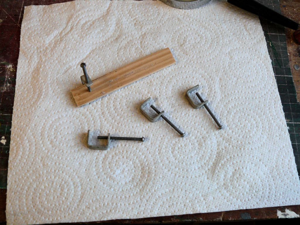

                            I was rummaging in the junk boxes this morning, looking for two really special nuts or screws to retain the Rudder Hatch, when I spotted these little Mini Clamps. Old memories came flooding back to the 70`s
                            Me and my pal, Dave Bailey were always looking for ways of making money. Who doesn`t? ….I hear you say
                            Our first idea was these Mini clamps. We tooled up for bending, punching, deburring and sent them out for Cadmium plating. We borrowed the Works Plastic bag sealing machine and bagged the clamps in packets of ten.
                            Then off to Ashton Model Shop, where we met the our friend, Charlie Jackson. He liked them and offered to sell them on the counter! We made hundreds of the little devils.
                            We then progressed to Turnbuckles for yachts. We made three sizes and once again, dreaming of elusive riches ahead, we tooled up.
                            Er….What`s that?….What`s with this tooling lark?
                            Glad you asked that. We had a giant Engineers Vice and removed the Jaw Tips and fitted an assortment of male and female tools.
                            It was great fun, gripping a sheet of brass and simply winding the vice jaws together and "Pop", a side plate was made! It cut out the profile and stamped out lightening holes and two assembly holes.
                            They were a little work of art. I hope Dave has still got one on his keyring, I try and get a photo of it
                            We progressed to all sort of projects as time went buy
                            More later if any interest is shown
                            Bob and Dave
                            #90341
                              You clever bugger
                              #90342
                                Thanks my mate
                                #90344
                                  Captain Bob a true engineer.
                                  The temptation would be to use a butterfly headed bolt but then you wouldn't be able to get the clamps close together because the heads would clash.
                                  The long bolt allows for easy access when the clamp is in a confined space.
                                  Your bench vice 'press' is a brilliant idea.I
                                  I am officially impressed and would like to see some more examples of your ingenuity.

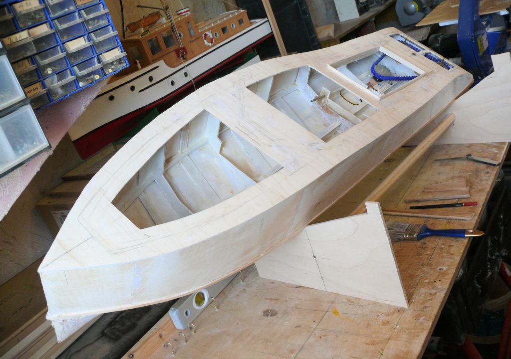

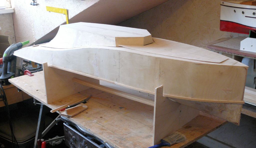

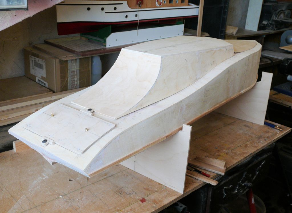

                                  #90387
                                    Hi chaps
                                    Slow progress at the moment, getting down to the bits and pieces
                                    The rudder mech is now finished and works well
                                    Trimming up the superstructure to fit the wibbly wobbly deck!
                                    Using the filler and sanding down….etc
                                    The Control panel is next in line
                                    A few photos to have a look at, especially for Doc Thomason
                                    Comments are always welcome chaps

                                        #90454
                                          Spent most of today, fiddling with the radio gear…….
                                          2 MARINE ESC 50 with reverse and 2 MFA 850 Motors
                                          Only about an hour ago, did it show signs of life!
                                          Both ESC`s have an ON/OFF switch
                                          When the motors finally make their minds up to run….I can turn the on / off switch off and it has no effect
                                          Is this correct?

                                              Hi Paul
                                              I have a little light bulb gadget that fits the plug socket and is a good quick check
                                              The motors run ok, but the system is chronic
                                              Will have another fiddle tomorrow and a word with Howes Models
                                              G' Night Paul
                                              #90459
                                                Bob. Just a thought.  I believe you need to disconnect the red BEC wire from ONE of the ESC receiver leads.
                                                Otherwise, the system gets confused by having loads of battery supplies.
                                                Edited By ashley needham on 30/07/2020 22:55:53
                                                #90460
                                                  THank you Ashley
                                                  We've had this arguement for years now and I've debunked it so many times
                                                  Ive got the the four engined VGC cruiser and the Lady Jane proving the point so man times
                                                  I just wonder where the idea came from in the first place?
                                                  No doubt Mr Grimnasty will appear shortly
                                                  It'll sort itself out shortly…..Hopefully

                                                    Let's think again….
                                                    The system is now working, both motors run together and independently
                                                    Rudder is OK
                                                    My query is…….Why are the in line ON / OfF buttons not working?
                                                    #90465
                                                      the On off switch certainly supplies power to the receiver and presumably turns on the esc itself, so it’s a bit of a mystery.
                                                      If you were to disconnect one of the esc completely, does the other work ok including the on/off switch?
                                                      The bec power lead thing, if it works for you then that’s good, but I think that if you ARE having problems, it is just something to look at?
