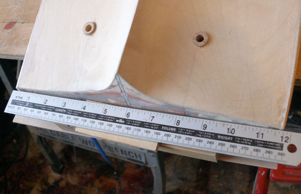

      Should have gone to SpecSavers?
      This rule has caught me out yet again!
      #90166
        Having studied the problem for a few hours, have decided the cure is not worth the aggro
        It helps to have a short memory at times
        What`s 3mm between friends anyway?
        #90170
          I am a little confused about your missing 3mm, the oblique angle of the photograph and lack of reference hasn't helped me decipher your problem.
          #90171
            Hello Paul
            it's quite simple….
            Look at the numbers 10….11….12
            The actual inch line is between the numbers……10 and 11, but for 12 inches, the inch line comes comes before 12, losing 1/4"
            Just to make room for the hole at the end!
            It's my fault, but it is easily misread
            #90175
              You are talking about the ruler.
              I thought you had a problem with the stern of the boat and that the ruler was to demonstrate an incorrect measurement
              #90186
                What's 3 mm between friends anyway?
                #90188
                  Bob. I see what you mean, and you are right. With a stern of that width, a few mm makes no difference reallyl
                  #90192
                    Thank you, Ashley for your kind words of encouragement
                    Normally, I can put things right with a bit of wood and filler etc, but the kinky keel is only thin ply and there's not much meat to play about with!
                    Will give it more thought this morning, I was thinking about masking the sharp edge with a capping strip etc
                    But you are right, I think I'll turn a blind eye to it and do the Nelson Touch……..I see no ships etc

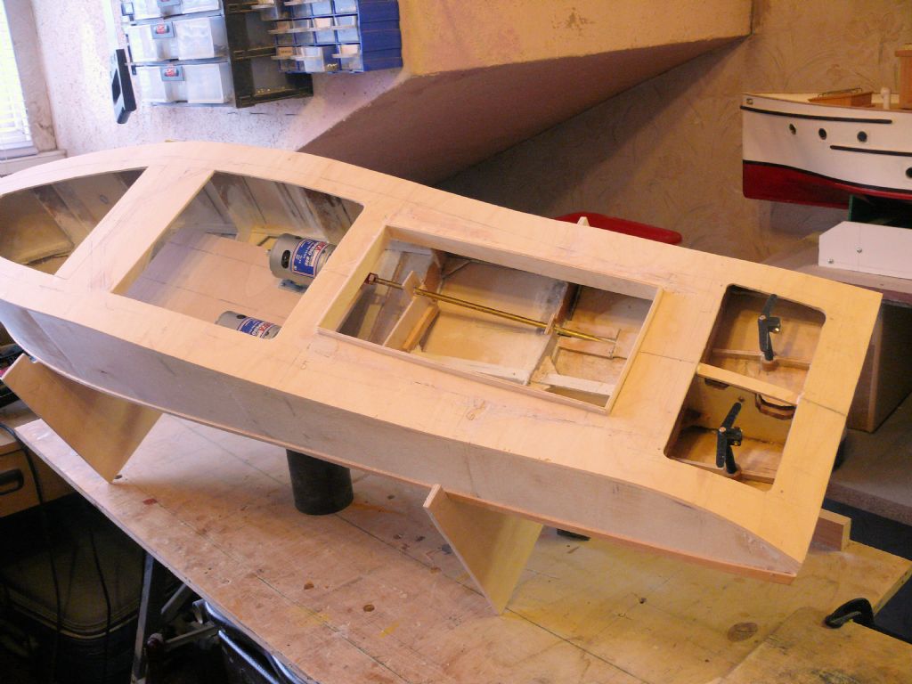

                        The prop shafts look about 10 degrees off the horizontal
                        The motors look quite cumbersome at 10 degrees, but they look very nice if horizontal?
                        Any comments out there?
                        #90203
                          Apparently the reduction in radar image for modern warships is not only to make them less detectable at long range, but also to make the radar countermeasures more effective. By making the size of the radar return from the ship match the countermeasure return more closely it helps to confuse missile radars.

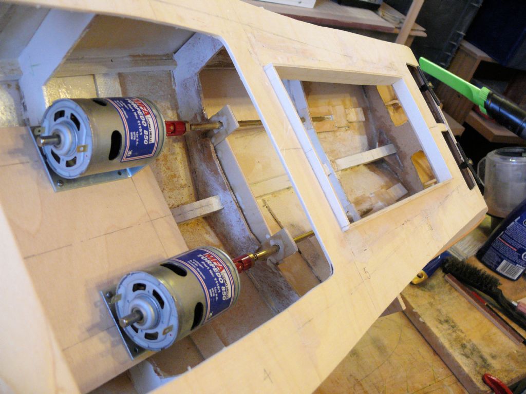

                          Chunky powerful motors Bob, would be better if they were a bit more in line to put less strain on the u/j??. Are you using single, or twin u/j??
                          #90204
                            Thanks Ashley
                            Just bolting them to a nice flat 6mm ply base right now
                            And large enough to fit the Control Gear too
                            Will try the level motor idea first, just to see the effect, they should look more authentic being level?
                            I`m using just one U/J at the moment
                            #90210
                              To be honest, probably with such a shallow angle it would not make much difference.
                              As I have said before Bob, it’s your model, if you like the look of flat motors…go ahead!
                              #90213
                                I've been looking at the original drawings from MK1 and it might help to install a support section running the full length between the underside of the prop tubes and the inside of the hull, this would help prevent the potential for whipping from any imbalance in the drive train.
                                #90215
                                  Hi Paul and Ashley
                                  The motors are now mounted on a small sheet of 6mm plywood and just pushed into the hull and it lined a treat with the shaft ends
                                  I like the big chunky motors BTW chaps……They look just right for the job
                                  The motors have also lined up with the incline of the propshafts too…….Another stroke of luck again
                                  Back on the job with a smile once more
