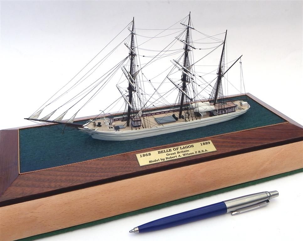

                        I don't mind people asking. Don't have any trade secrets! smiley Here is the pretty little Belle of Lagos when just started, and then when completed.

                          Thanks Bob
                          That sure is rough!
                          From a very ugly duckling to the proverbial graceful Swan!
                          Is this the effect you're intention?

                          #70453
                            @bobwilson59101
                            Not really,
                            I have never been much good at carving. So my shaping is done with quite heavy rasps and files, coarse, medium and fine wet & dry paper. Then, as the whole lot is covered up with paper plates, all the roughness disappears.
