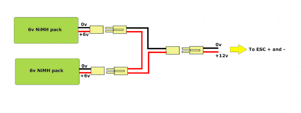

              I found , at good price, 1 power pack 6v 4500MA
              is it possible to buy 2 packs and to join them in series so I will have 12v and 4500MA?
              trouble on looking for ESC with BEC they do not have in Italy

                  Connecting two 6 volt batteries of the same capacity in series will give the 12 volts that you want. It is important to make sure that both batteries are kept in the same state of charge, the best way is to charge them in series as if they were one 12 volt battery.
                  Your chosen ESC should be just fine.

                    That speed controller would be suitable, although not having used that particular type I can't personally recommend it – but it is a popular choice in the UK.
                    You can make up a wiring harness to connect two 6v NiMH packs in series to give 12v. Here's a diagram. The harness may be available commercially but I have no information about that.

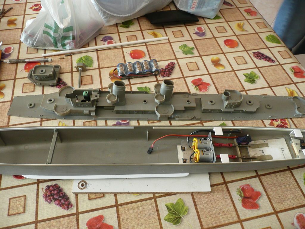

                      Hi Guys,
                      I would like to say thanks to all helped me on understanding how to use ESC and not only it…..
                      I started with my uss Fletcher and all works well
                      work is on progress
                      regards
