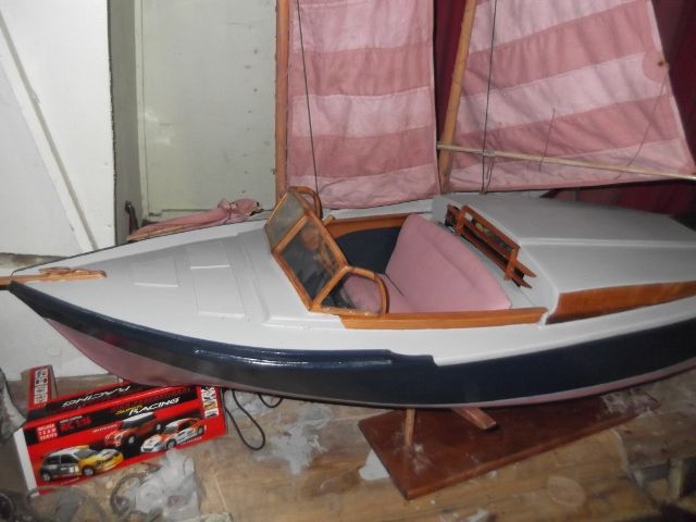

            The last of the painting is done, and the squabs are in the cockpit.

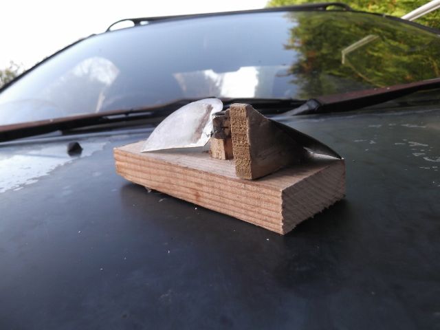

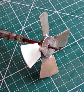

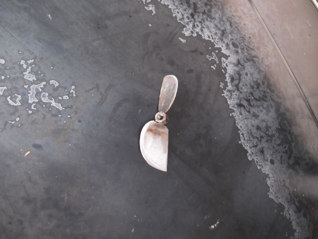

            The new prop is under construction….

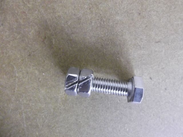

            Starting with a couple of s/s nuts with slots cut in them
            And a couple of 1mm s/s blades welded in.dscf5896 (640x480).jpg
            (Yeah, I did the welding, can you tell?)
            I made up a simple jig, to check the pitch is the same on both blades. not sure what the pitch actually is, but about 40 degrees.
            The diameter is the same as the previous prop, the blade area slightly larger, but quite a bit more pitch. I'll give her several runs on the water, and adjust the pitch as required. ( if the weather comes right….) Dead line is the 29th, so fingers crossed.
            #50128
              Very inventive of you, Amy J
              But I don't like the idea of two blades gyroscoping about, held together with a home made weld?
              Would have been safer, had the blades were made in one piece and twisted with pliers?
              Similar to this…..Great Eastern
              #50129
                Bob. I think, given the smallness of the blades and the relative low speed of the motor, that the blades will be ok. After all, what harm could come..other that a blade breaking off and piercing the boat causing it to sink???
                Thats a good shape you have there Bob (great shape, Amy).
                Amy. Normally there is decreasing twist out from the boss, so the blade angle decreases(as you know). Would a brass prop enable a better prop shape, and be easier to make? You could even consider making a dog-drive, and be able to use plain tube for the boss. Two projections on the shaft could be easily effected by a couple of weld spots filed down, the boss tube simply needs a couple of locating slots in it and a nyloc at the end to hold it in place

                  Thanks Bob and Ashley.
                  I think the welds will be fine, my welding doesn't often break!
                  There is a slight amount of helical pitch in the blades, but given the coarse pitch, the difference between the root and tip is not great. I agree brass would be easier to shape, (I don't much care for working with stainless) , and I have plenty of it, but I'm not set up for brazing or silver soldering. The nuts for the boss makes the prop self tightening.

                    I take it you are not welding the prop using the car bonnet as a workbench cheeky
                    Only jesting. The model is looking great.

                    Amy jane September
                      @amyjaneseptember49770
                      Hi Dave
                      Given the state of the paint work on my car, I don't think it would much matter!

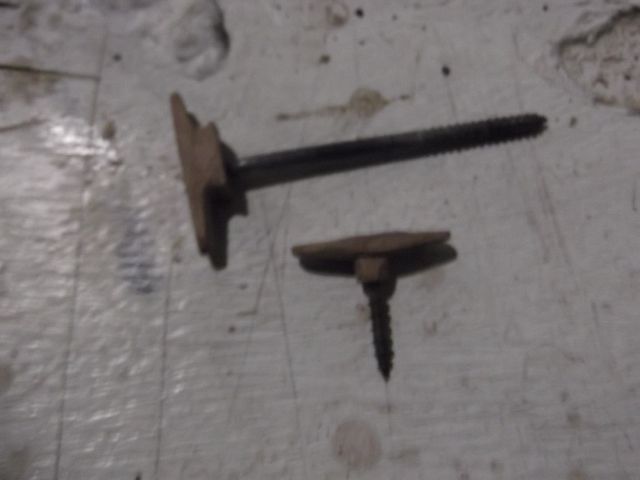

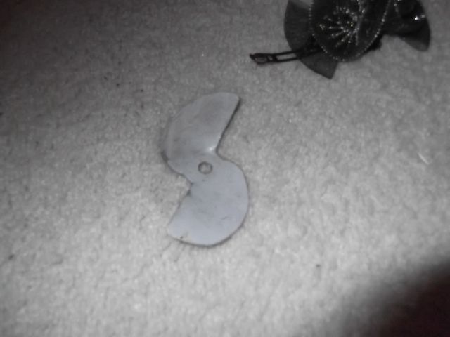

                      Incidentally, this is the prop…..
                      that was on the boat, in this photo…..
                      It shall be interesting to compare performance!
                      #50179
                        Yes, and there was hardly any pitch on it at well !!! cool
                        (great shot)

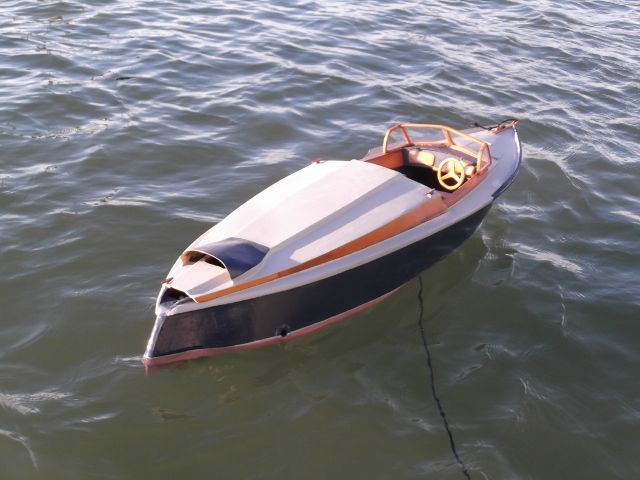

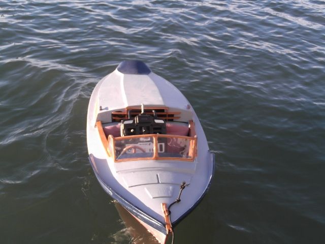

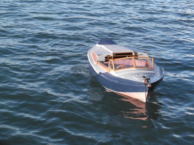

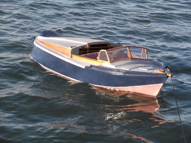

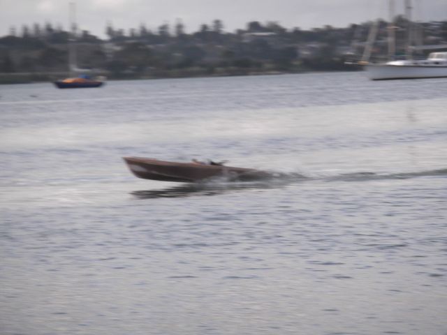

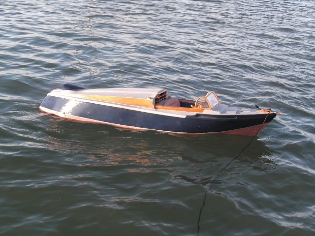

                                      Hello me hearties! Enjoying your warm weather? We're getting some sub zero nights here at the moment, this was my poor car this morning!
                                      Weeellll….. I had real, real blonde moment this week! Got the boat all going, good long bench run, with the cover on, no problems. Lugged her into the car, raced off to the wharf after work, all excited like….
                                      dscf5932 (640x480).jpg Da. Blinking forgot to blinking well check the blinking tide! I can't get away from the moored boats at low water, so good sense had to prevail. I put her in the water any way, and took a few shots. (She's at anchor, and the crew is off for a swim, Ashley….)
                                      Here's one for Bob, with the transmitter for scale.
                                      Any way, the tide will be good next week, so I shall try again.

                                      #50529
                                        I like your frosty work bench, Amy!….lol
                                        Your launch is an absolute credit to you……Really well done…..True scratch building at it's very best!
                                        It looks the part tied up too…..What's that little black box on one of the pix?…….lol
                                        I'm amazed that none of your NZ kinfolk have not made a comment…..Is there a logical reason for this?
                                        All the best, AJ
