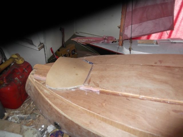

                    Hello

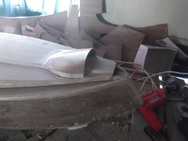

                    Not much progress this week, I'm afraid. I made an air out let for the back of the engine cover, but didn't like it, so I ripped it off and started over. Second one was better.
                    And the beginnings of a cockpit.
                    I finally settled on a scale of 3"=1'. Makes her a 20 footer, a comfortable day boat for two, with room to sun bathe on the engine cover and space for a picnic hamper and a few bottles of wine…

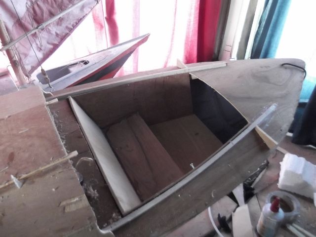

                              Hi all.

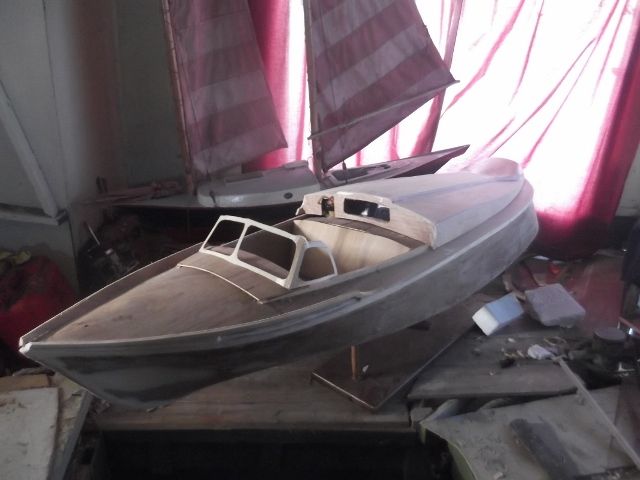

                              A bit of time has been spent filling and sanding, bullwarks added to the bow (wouldn't do to have all those empty wine bottles rolling over board, would it?) The cockpit is ready for detailing, and a cardboard mockup of the wind screen made.
                              Happy now with the rear scoop, (The first one looked remarkably like a baboons face!)

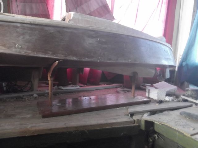

                              Look Bob! A flash display stand! (made from the bottom shelf of Lynn's book case, I wonder if she has noticed yet)
                              #48836
                                Amy. Not yer usual top..modelled on anything or just out the old brainbox?
                                #48837
                                  Hello Amy
                                  Your model has charm and novelty and would have made a lovely article for the ModelBoats Magazine
                                  It`s not too late……..Have a word with Colin?
                                  I like the stand, it shows off your excellent model in a very dramatic pose!
                                  The rear vent would have looked nicer, had it been a sheet of louvres?…..You can them ready made
                                  Would give your model…The Ferrari Look?
                                  Still, a nice model though

                                    Hi Ashley, The model is kind of designing her self at moment, I'm just going with the flow…..
                                    Thanks Bob, I did consider louvres, and they would have looked quite good, but opted for the scoop. I was quite pleased with the stand, gives the feeling of the boat flying along.
                                    Very kind of you suggest it for the mag, but I'm sure Colin already has plenty of fine models lined up, judging from the work I've seen on the forum!

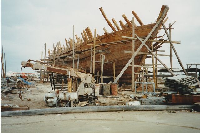

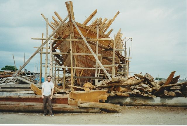

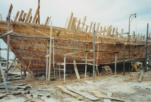

                                                All this talk of adzes and yule logs reminded me of a trip I made to Dubai about 20 years ago. It was just before Christmas in 1992 when we were despatched to investigate an aircraft with flying control system problems. At one stage the customer said, not entirely tongue in cheek, that he thought there was a ghost in the machine, but it was probably just air in the hydraulic system.
                                                On our weekend off we took the opportunity to have a look round the shipyard in Dubai creek where dhows were still being built by traditional methods, no modern machinery in sight. Here are a few photos.
                                                Yes thats me in one of my hairy phases stood in front of some hefty sized chunks of timber.  I have no idea where they got the timber from, there are not that many trees in Dubai.
                                                The slightly bizarre christmas connection was that we were working outside in temperatures of >30 deg C totally immersed in an arab culture but on return to our hotel near Dubai International Airport the first thing you saw on entering the foyer was an enormous christmas tree complete wih all the usual decorations and carols being played over the sound system.
                                                Gareth

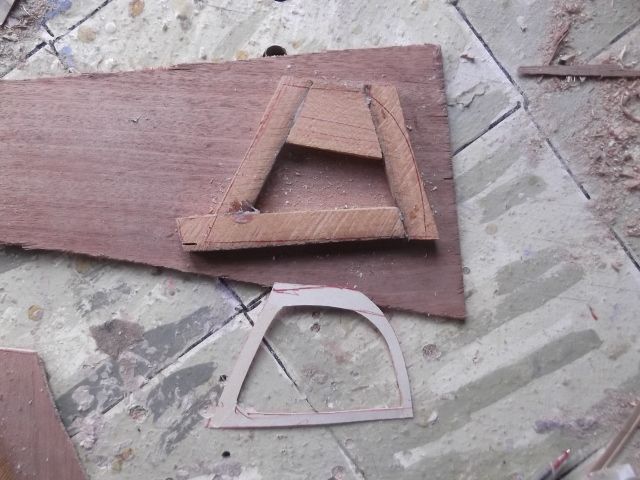

                                                    Right, on with the build.
                                                    Actually getting a little frustrated at only getting a few hours a week to work on the boat, but never mind, will get there in the end!

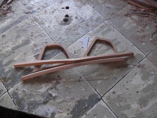

                                                    Made a start on the wind screen. Silly girl that I am, I decided it would have to be done in varnished Kauri. It's starting to become the most challenging part of the build so far! Once again I doth my cap to the skill of you fine scale builders, and humbly lay my hatchet at your feet!

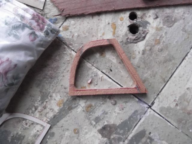

                                                    I started buy gluing up the sides out of over sized bits
                                                    which I then cut down to size. The upper and lower cross pieces were made from two bits, finger jointed together.
                                                    here are the bits, almost ready for assembly. Just need to cut the rebates for the clear plastic.

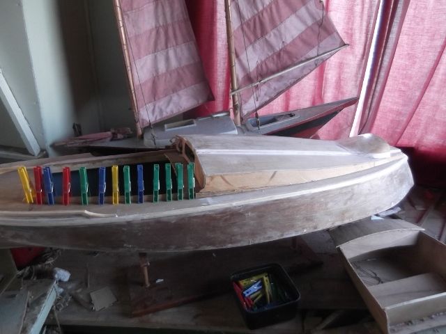

                                                    I glued a thin plank along each side of the engine cover and cockpit coamings, which will be sanded and varnished in due course.
                                                    I thought it would be wise to make the cockpit removable.
                                                    Kauri is not the ideal timber for this. Although it is stable and close grained, it is quite brittle and splits easily.It has the most beautiful golden colour once varnished, and the close grain looks much more scale like.
                                                    Incidentally, I've been using my home made glue for quite a bit of this build now, and is proving quite satisfactory. It is resonably strong, and totally water proof. It costs about $16 a litre to make from readily available ingredients. (All three of them) Any one interested in the formula need only ask.
