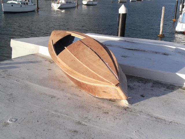

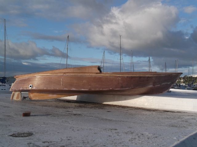

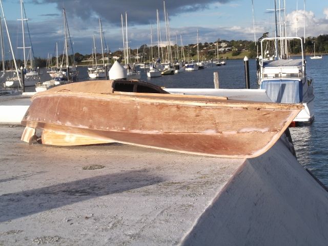

          Well, Bob as promised here are a couple of general view shots. The cradle is made, though the glue wasn't dry in time. So, due to the shortage of palm trees, I took the boat down to the jetty…

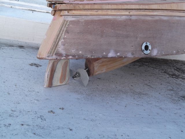

          The rudder and prop are in. Following Ashley's advice, the prop is made up from a bit of sheet ali, so it can be easily adjusted until I'm happy with it, then something a bit flasher made. (or not) I was researching props and was suprised at how little pitch the had, only 3 or 4". Until I discovered that they were being coupled to 26cc engines that were producing 5hp! The revs must be horrendus! The prop on this is 4×7" for a much more civilized 5,000 rpm.
          The business end is looking, well, business like!

              That's looking really nice and business like, Amy J
              Are you going to paint it or varnish it?…….Varnish?
              How does the engine run?
              Keep up the good work

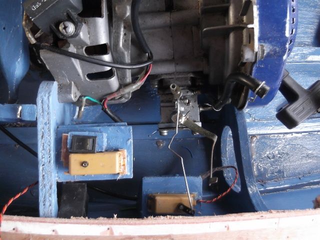

              #48161
              Amy jane September
                @amyjaneseptember49770
                Hi there Larry. Great to have you back on deck! Take good care of yourself m'dear.

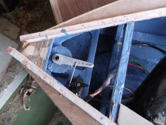

                Thanks Bob. She'll be mostly painted, but there will be plenty of varnished kauri trim. I haven't run the engine since the testing for the clutch, but these little engines are sweet runners, so not anticipating any problems.
                Exhuast is in
                rudder set up
                The rudder stock is left over prop shaft. The bottom has a steel cross piece welded in, and the ply blade glued either side. The top is squared off and the ali tiller slipped over and pined through
                throttle hooked up.
                All systems have been tested, and everything is working properly. Next step is to install the petrol tank and shield the radio from electrical interference, then it's off for a test run….

                  I have a couple of questions about your prop :
                  a. How did you ensure that it is dynamically balanced – if that prop is not properly balanced, at 5000 rpm it could vibrate violently and even shear the propshaft.
                  b. What grade of aluminium did you use ? My experience with sheet aluminium that I have used is that it is quite soft and when you bend it fracture lines can appear ?

                    The aluminium is from a office partition frame, and is quite soft, but seems quite robust. Lynn has been making model aeroplane propellors out of this stuff for a year or two, with good results. (these are 9 or more inch props, turning at 15,000 plus) The prop was properly balanced on Lynn's prop balancer.
                    Thanks for the interest and good wishes, like everything we do, time will tell…..

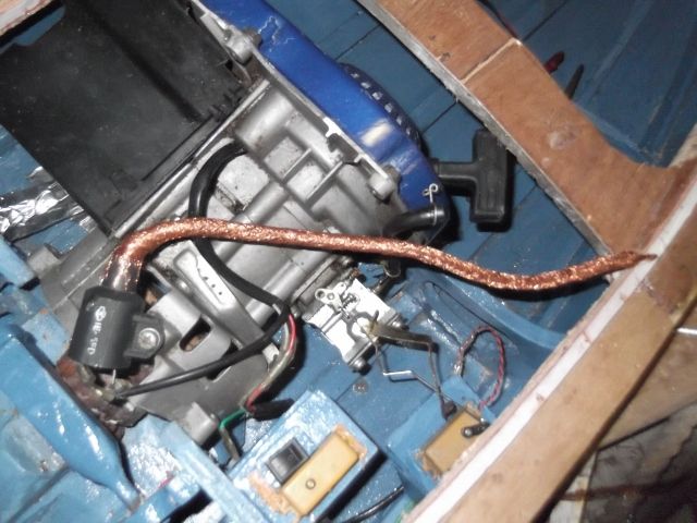

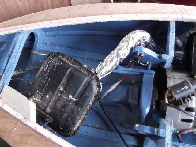

                    #48263
                    Amy jane September
                      Hello all.

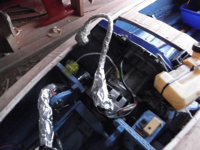

                      Phew, that was a learning experience! Neither Lynn or I knew the first thing about shielding the engine, to stop interferance with the radio, other than that it had to be done. So we both decided to research it independently, then compare notes. There was a lot of different opinions out there, and the debate on some of the forums got quite heated! placement of radio servos, use of ferrite rings in servo leads, not using metal push rods etc etc. We came to the conclusion in the end that it all came down to doing a proper job of shielding the high tension side of the ignition. Properly done, nothing else much mattered, not properly done, none of the other stuff would be of much help. It also seems that 2.4 meg is much less affected (I'm useing 40meg). All those of you that have done it all before, please feel free to comment, the more information the better. Rightly or wrongly, this is how I went about, and it seems to work. The servos are rock steady at any engine speed.
                      The first step was to shied the HT lead and spark plug. This was done by removing the pug cap and sliding several layers of copper mesh over the lead.
                      The mesh was stripped off a length of co-ax TV aerial cable, of which I have plenty.
                      The next step was to make a new plug cap. It would seem important that the plug cap covers the plug right down to the cylinder head, and that the copper screening covers the cap and earths to the engine. I put the original plug cap back on, put the plug in, then wound the cap and plug with a strip of stocking, right down to the thread. This was silicone rubber coated and more stocking wound on etc, untill a sustantual cap was built up. The copper screening was then wound around the cap and tucked in side it, so it would earth against the hex on the spark plug. A bit of solder was used to hold the winds of mesh together, then the whole thing was wound with tape. The coil was covered with ali foil, as was the rx.
                      So all is ready for a range test, and a run on the water, but the weather is lousy!
                      Aj

                        #48274
                          Amy. There is a lot of rubbish talked about interference..other forums?? there is only one you need.
                          There is no right or wrong. I think you have taken the sensible course of action here, supressing the ignition system. I think you seem to have mad e a thorough job of it and indeed the proof is in the eating of the pudding or something and indeed you dont appear to have any issues so must have done it right.
                          Paul T is the man for supressing i/c engines, if not the masses.
                          Lousey weather?? are you having us on..it is always sunny downunder surely??

                            Amy, just looked at the rest of your photos..noticed the rudder is wood, and not best office furniture ally/car body steel/gold forged from nuggets found in your stream??? any particular reason other than its easy to do??
                            I am going to say that the skeg/propshaft support looks a bit fat to me.I can hear the sharp intakes of breath at the extreme cheek being displayed here is raising any sort of issue regarding this fine build but is just looks a bit, well…FAT to me and draggy…so I  am saying so, or have I read but forgotten that the Adze has yet to come out on the nether regions of this craft.
                            Its difficult this, one never knows how someone is going to take comments on a build, and by this I mean of the critical variety..not just criticism per se, but constructive criticism. This is a forum after all and when people put, say, pictures of their first build on the site, and one looks at it and thinks….hmmm…could do better here and there..no one says so, and all the posts are usually of the "well done for your first build" kind, and so the first time builder never knows that improvements could be made in some areas, or if they do they do not indicate that they know of the failings and so on. It`s just tips and hints really that need passing on, but I know some people just get the hump if you dare to suggest anything could be made a bit better. Should we be passing comment? or only positive comment to the exclusion of all else???
                            I hope you dont mind me mentioning the fat bit, and it not a criticism but merely an observation. You obviously know what you are doing and no doubt are aware of this anyway and are going to either slim it down or indeed leave it alone as you know it wont make much difference. Extra meat on this area may indeed be called upon due to the herculean forces due to be exerted by the 26/35/40/500cc engine. BUT it is the sort of thing perhaps other people would not notice and it could be something that needs to be pointed out.

                              As for the "fat bit", no of course I don't mind, I even agree with you! The explaination is simple. The only tube I had at the time was 3/4" and I have planed the skeg down has much as I dare!
                              The wood on the rudder is to fair in the 3/8" rudder stock.

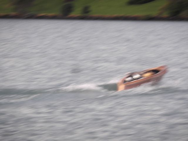

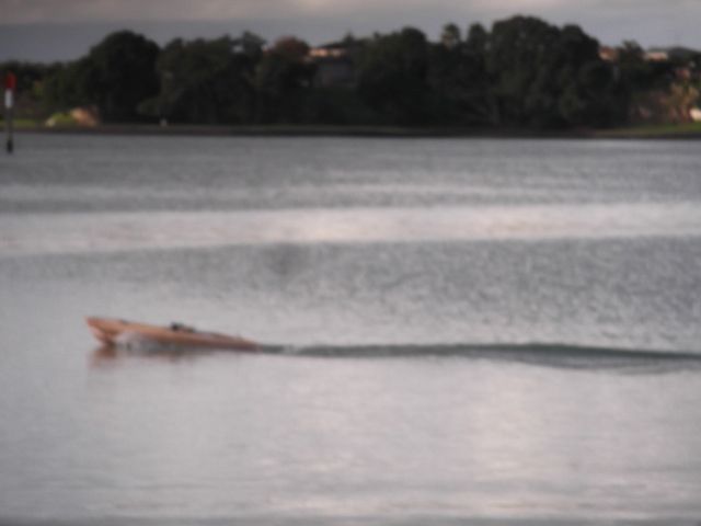

                                              #48389
                                              Amy jane September
                                                Hello again.
                                                Thanks for the good wishes all!
                                                As it turned out, no need for nerves at all!
                                                Here we go…..
                                                Just a shot in case I never see her again…
                                                Start her up, (stared second pull), push her off, engine at idle, take a deep breath and engage the clutch…..
                                                Yipeeeee!!!!!
                                                Sorry the photos aren't better, I was on my own, so it was a bit of a juggling act, camera in one hand, transmitter in the other! The boat handled flawlessly, banking nicely in the turns, and running straight in between.
                                                The clutch worked well, engaging and disengaging happliy. Cutting the throttle automatically disengages the clutch due to prop drag, nice when coming back into the wharf. She had a good run, got her air born, jumping her own wake. Gets about 20 minutes on a tank, which is plenty.
                                                She sounds good too, not too loud, and everything done with a deep rumble suggestive of real machinery!
                                                I'm guessing a scale speed of 20-25 knots (that is the speed she would be doing if full size), so I may play with the prop a little, to see if I can get a bit more out off her. That, a bit more rudder throw, and some trimming ballest forward, is about all the modifications I think she needs.
                                                On the right track I think….. I'm happycheekylaugh
                                                Aj
