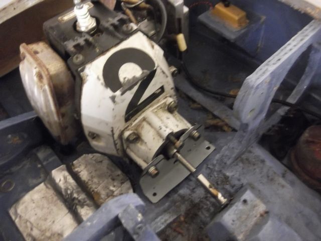

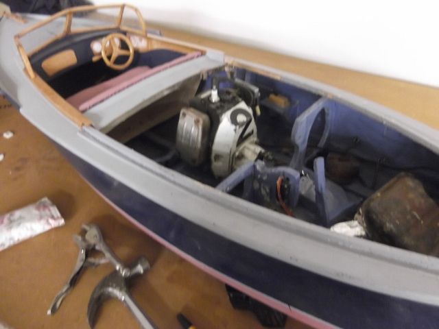

                    A start has been made on installing the weed eater engine
                    Looks a bit lost in there after the generator engine, but is much higher revving, so with a cut down prop, I'm hoping the performance will still be pretty good. I have a few ideas about not making it sound like a weed eater engine…. I wont have to modify the engine cover at all, which is good.
                    engine mounts ready to screw in. The weed eater has a centrifugal clutch built in, so the dog clutch has been discarded.

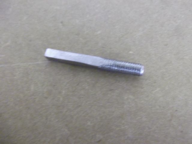

                    A bolt was ground and filed down for a drive dog. I will use a short length of the weed eaters flexible drive cable as a coupling.
                    Aj

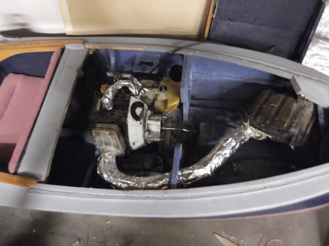

                            A bit more progress…
                            The engine and tank is in, and flexible coupling done.
                            The coupling is a short length of the weed eater drive cable, slid in side a short bit of s/s tube. A turned down bolt is on either end , one squared for the engine , the other slips into the prop shaft, and is welded. The tube is then squashed to capture the cable. The after engine mount is set on a rubber block, to allow a little movement. The forward engine mount it screwed to the hull. In an effort to stop the the whole thing sounding like a weed eater, I want to transfer the engine noise to the hull, (to give a nice rumble) and minimise the exhaust noise. To this end, I decided to retain the generators exhaust and muffler. The weed eater muffler had the outlet jammed up against the engine, so I closed it off with a bolt, and tapped a new nipple in.

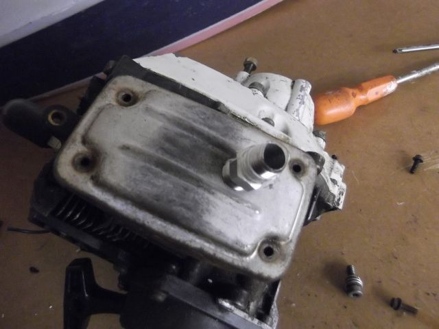

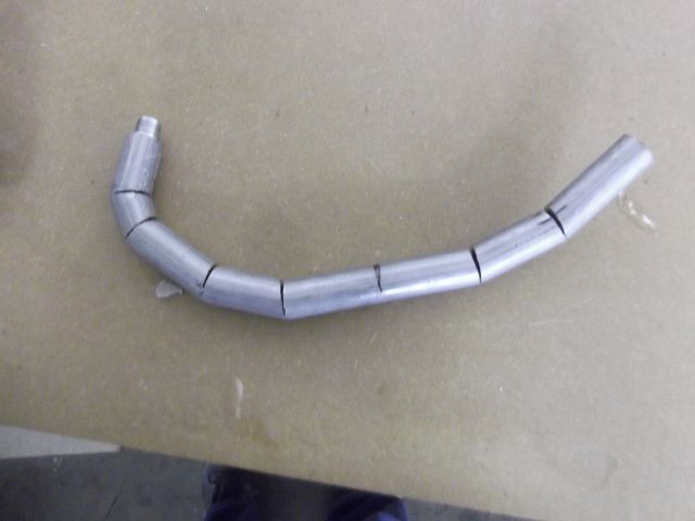

                            A length of s/s pipe was cut and bent to shape to connect the engine up to the existing exhaust.
                            which I will weld up next week.
                            Aj

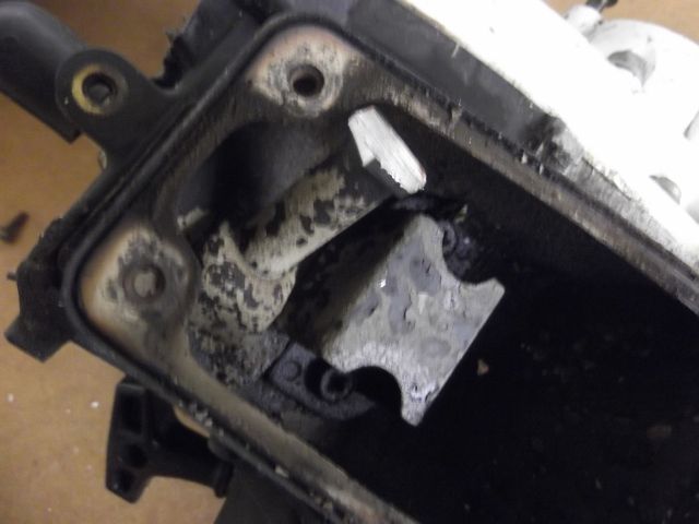

                                          Well, the exhaust is hooked up and insulated, the throttle servo in, plug lead screened. all that remains to be done is hook up the petrol tank. The weather is all gret and grindy again, but she shall be in the water at the soonest opportunity……
                                          I have stripped down the generator engine and could find nothing wrong with it. The rings are good, the bore is fine, no damage to the piston or blockage in the ports. The big and small end bearings have no play. Gaskets all good, so I'm flummoxed. I've reassembled it, and will but it on the test bench for a try in due course. Shall let you know….crook

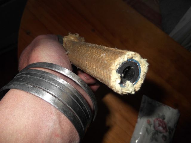

                                                After a suprisingly short sulking period, I hammered the prop shaft straight, made a new prop, (just bent ali sheet this time) replaced the rudder servo with the metal geared one I'd used on the clutch and rebuilt the windscreen. Whew…
                                                At Lynn's suggestion, I replaced the failed coupling with this
                                                a bit of compressor hose, with a bit of heavy kevlar braid slid over it, attached with two hose clips each end.
