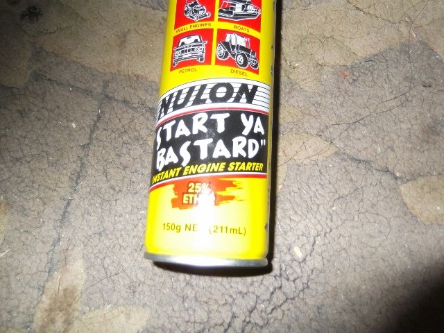

                                              oh by the way, this is what we call ether engine starter down here……
