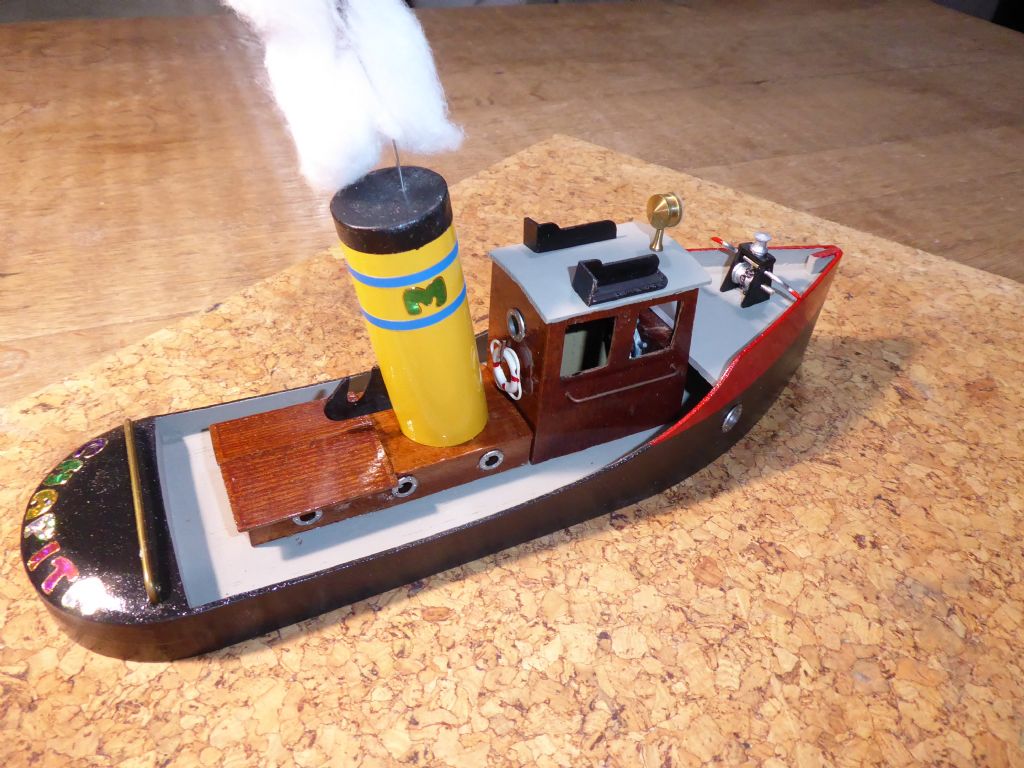

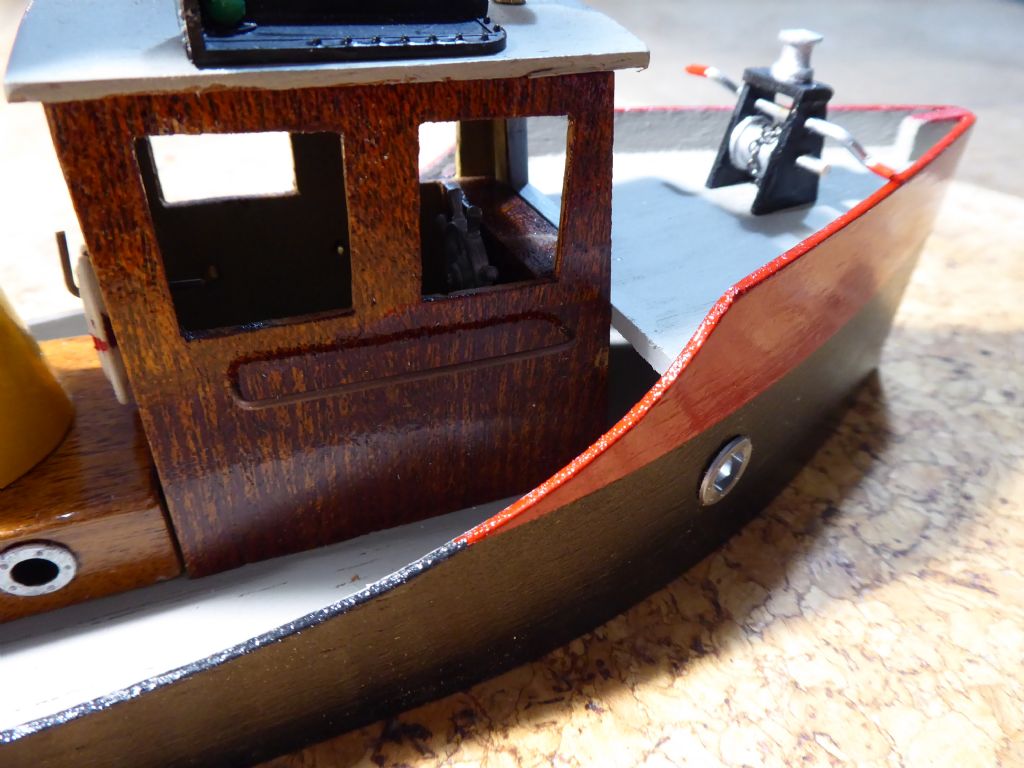

I am happy to use balsa on my models, once properly sealed and surface hardened using a number of methods it is a perfectly adequate material, especially for a small boat like Tyfone.
