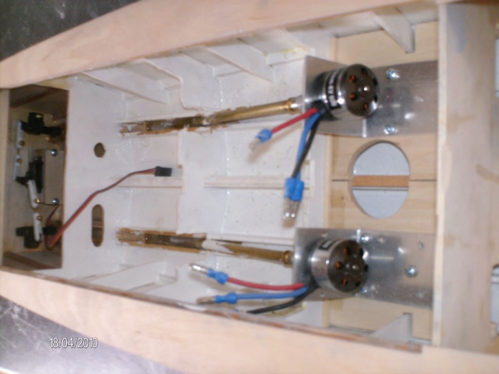

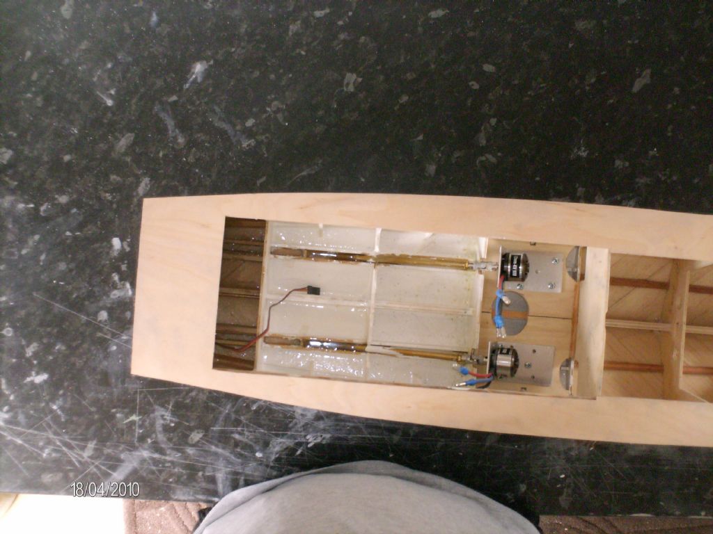

                              . They cost £49 each for a motor and esc. I only have 2 pics of them in situ and 1 is a bit blurred

                                That looks a real nice neat set up.
                                I have heard that most of the outrunners have the outer body of the motors spinning the same as the shaft.
                                It looks realy good,did you have to get special couplings for the motor to shafts ?
                                I like the way they are mounted as well, is that alloy sheet ? or is it something else that has to come special with the motors ?
                                and do you seriously get 55 minutes run time at this sort of speed ?

                                  I cannot remember if they were groupner or robbe or even huco but they are all pretty much the same you can get them with a threaded end for the shaft and the other end plain for motor all in different sizes.all the outrunners run with the body spinning as far as I know and the in runners have the shaft spinning. yes I do get 55+ by using 2x 7.2 3300 ninh batteries one for each motor and 1 of them powers the esc`s. the motors came with a front mounting plate and I made th beds in Aluminium.
                                  The motors have 3 connections and if you get a prop turning the wrong you just swap any 2 of the 3 round. I have quite a few pics of the build process but not any more showing the motors.
                                  Tony
