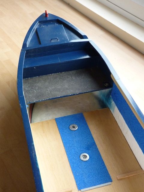

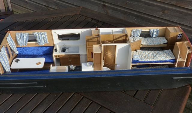

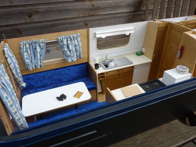

I have just about finished a 1:12 scale narrowboat, which has taken me about a year to construct. It is 43 inches long and the internal layout is based on a composite of several boats that we have spent holidays on.
The hull was supplied by Deans Marine and is not normally advertised for sale as there is a minor moulding error in the bow rubbing strakes but this was easily rectified by sanding off the offending parts and replacing them with styrene strips of an appropriate size.

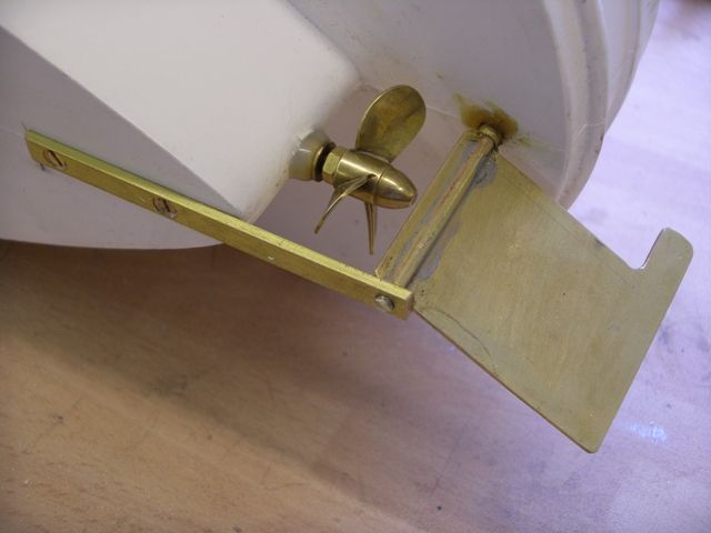

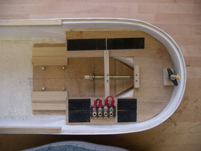

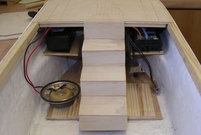

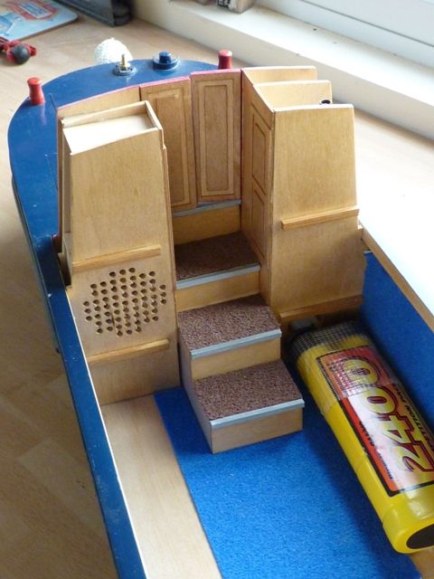

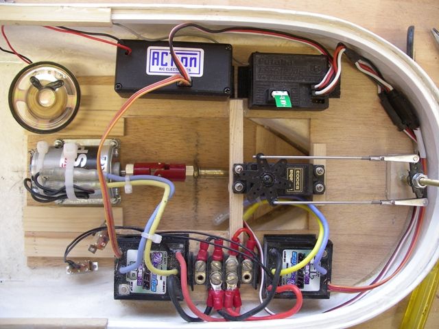

Since we wanted to fit out the interior with a representative layout it was a bit of a challenge to fit all the electrics in the back end. The battery fits under one of the rear bunks. The motor is a Graupner Speed 500E nominally a 12 volt motor but only running on 7.2 volts. The propeller is a 40 mm 3 bladed unit. A Raboesch bow thruster was also fitted but is normally switched off as the turning performance is quite good without it.
The sound unit is a small Action Electronics unit and is fairly quiet but adequate for this installation. The loudspeaker was originally going to be mounted directly under the engine access panel but ended up in one of the aft wardrobes.

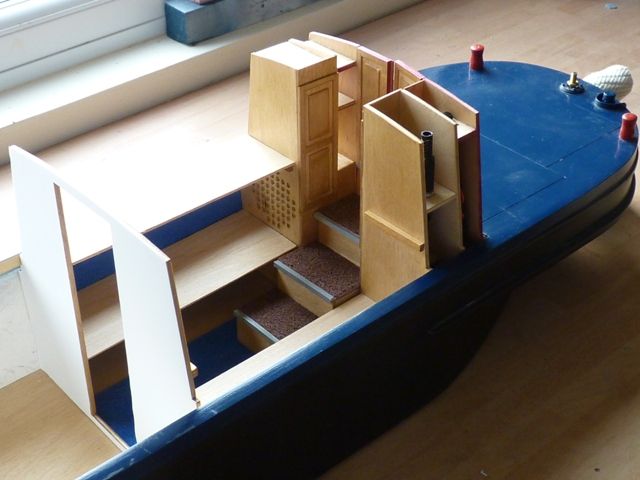

There are several sheets of lead flashing under the floor to ballast the boat to what I estimated would be the correct level, based on some early bath tests. As it turned out it was a pretty good guess as I have not needed to change it in the end.

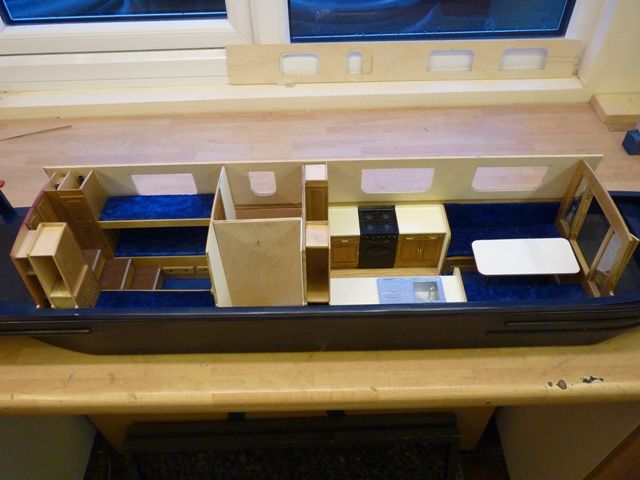

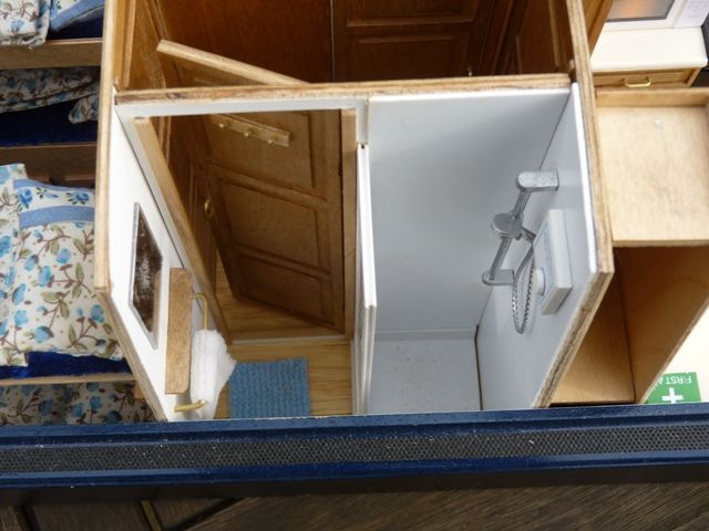

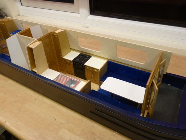

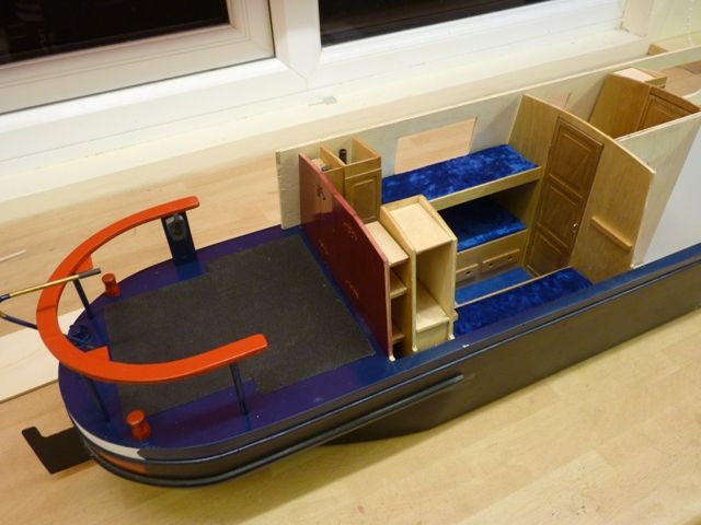

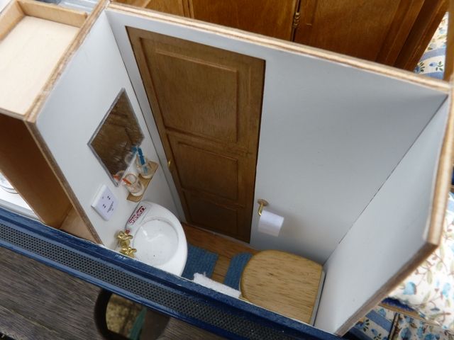

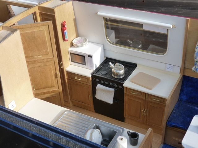

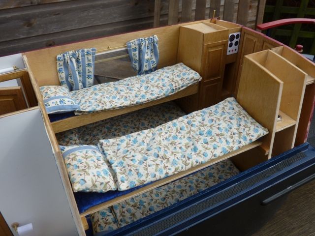

The cooker, fridge and microwave were purchased as dolls house accessories. All the cupboards, table, bunks and kitchen units were made from 1.5 mm ply.
My wife Elizabeth made all the curtains, mattresses, sleeping bags and pillows. She also made some 1:12 scale toothbrushes for the bathroom.

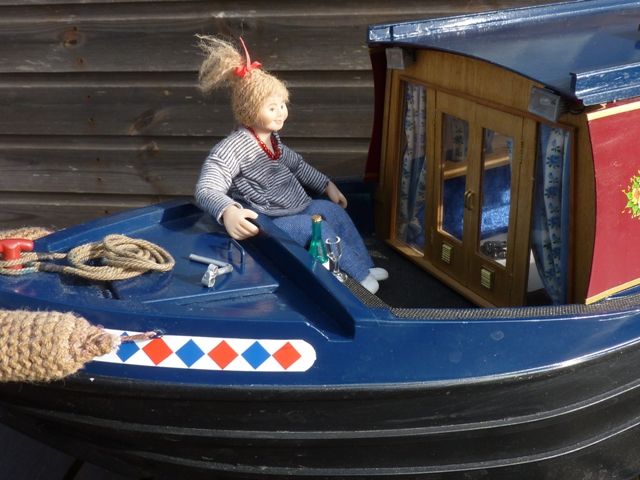

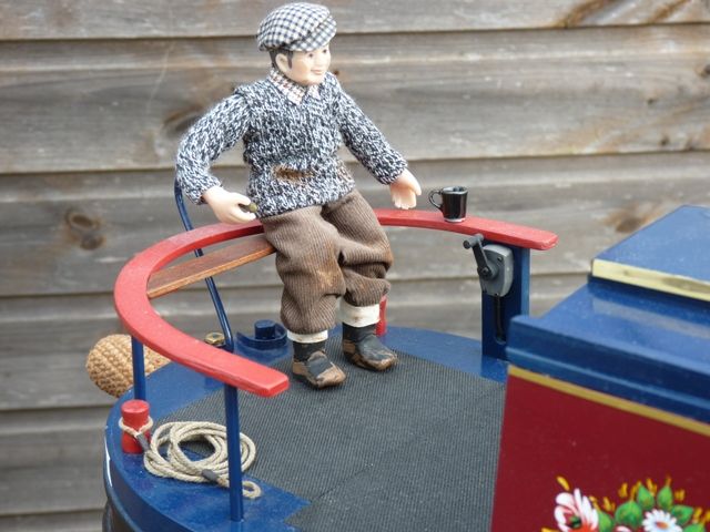

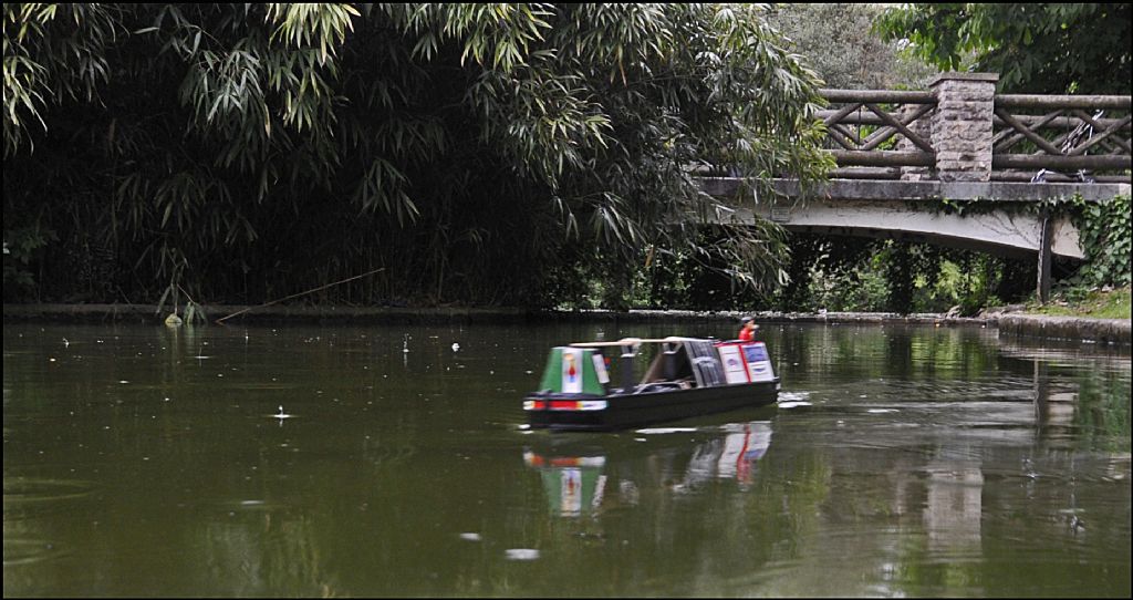

On the water, Walbut Dream has turned out to be easy to sail, quite manoueverable without the bow thruster but has very little freeboard so tends to ship a bit of water when the going is rough. Despite the flat bottom it does not roll much.
