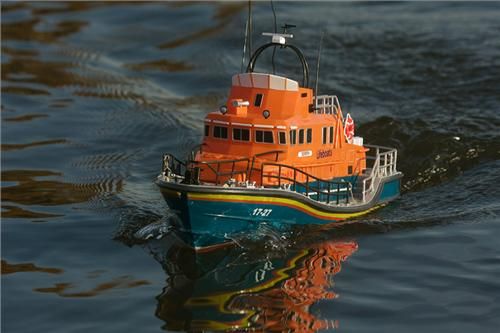

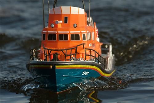

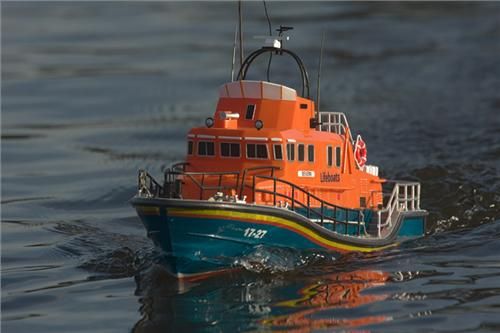

                                                      http://www.modelboats.co.uk/wp-content/uploads/sites/5/images/member_albums/3889/Lifeboatseven1.jpg
                                                      http://www.modelboats.co.uk/wp-content/uploads/sites/5/images/member_albums/3889/Lifeboatseven3.jpg
                                                      http://www.modelboats.co.uk/wp-content/uploads/sites/5/images/member_albums/3889/Lifeboatseven2.jpg
                                                      Well I’ve finished what I can on the seven, still a slight leak from the rudder stems, I cut them to down a bit to short,
                                                      currently powered by a 12v 3000a batt with 2 x mfa 385 motors, with 2, 23mm 3 bladed brass props, giving a good result.
                                                      some good lessons learn’t, would I do it again mmm maybe.
