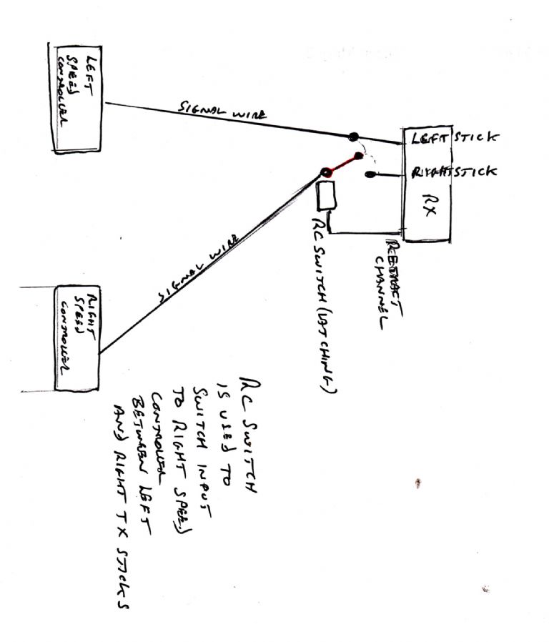

            It used to be quite easy to do this until the latest speed controllers came along! My Fishery cruiser model uses the undercarriage switch on the TX to operate an electronic switch on the RX to swap control from one to two sticks using a Y lead from one of the speed controllers. These older Astec units could be swiitched on and off without problems but most modern ones need to do a reset when the power is interrupted which takes several seconds and you lose control during that period.

                  Sorry, I should have made it clear in my earlier post. My method entails swapping the signal wire as per the rough diagram below., not switching on and off power to the ESCs. However I was told that simp[ly interrupting the signal can cause a reset.
                  (Not sure why the pic is sideways!
                  Edited By Colin Bishop on 07/07/2020 11:03:07
