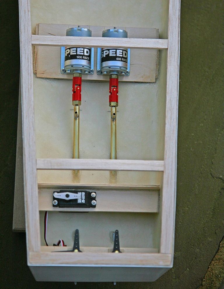

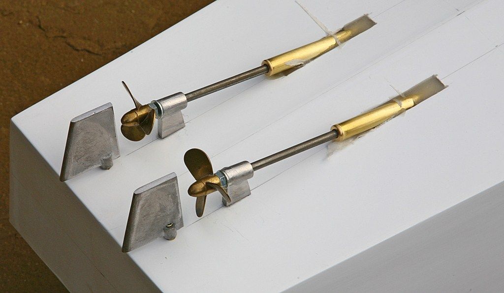

                    Hi Neville,
                    These two photos should help you. they are of a Perkasa model MTB. The size is probably different to yours but the relative proportions should be pretty similar so you should be able to use them as a guide to your model.
                    Hope this is useful.
