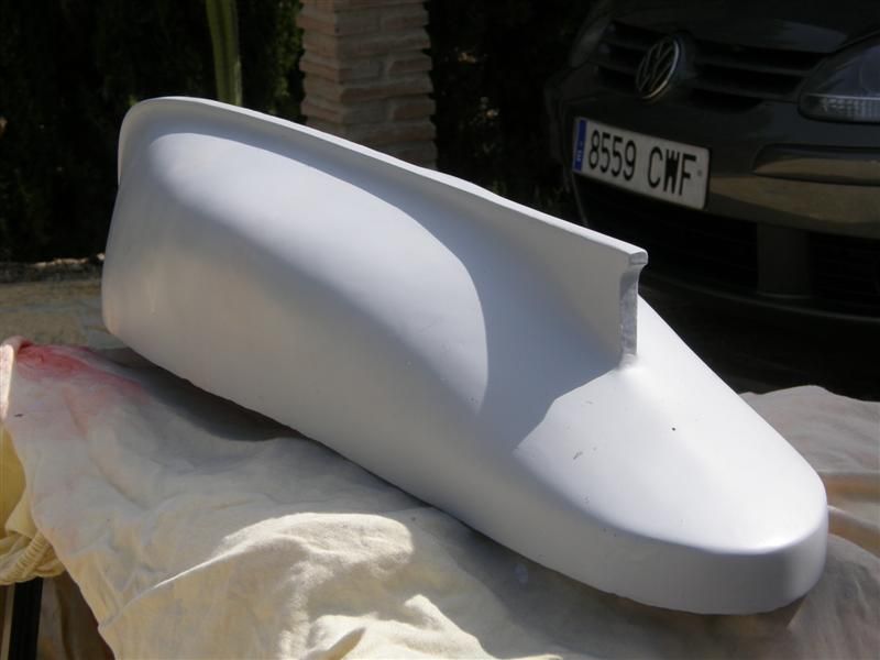

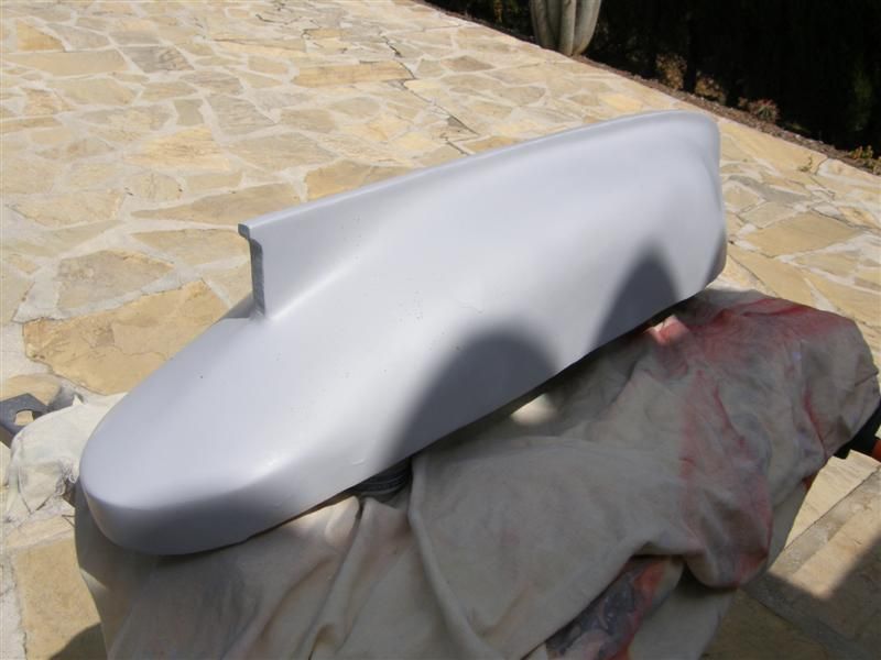

            A day to celebrate…..Applied first coat of primer, simply to highlight areas not quite up to the mark. I am delighted to say that it does not look too bad. There are one or two areas to apply a little more filler, mainly tiny holes in the glass fibre. I can now treat these areas and then prime it properly, before moving on to the next stage..
            I knoe the primer ran, but I was more intent on getting the paint on rather than a good surface at this stage.

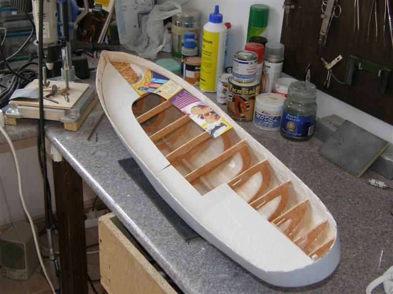

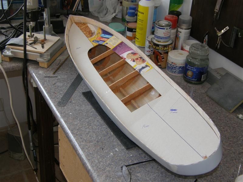

              Blimey I feel like I am galloping along now, having made up the card template for the deck. When I find the right wood, I will cut it out….Next running gear to look for.

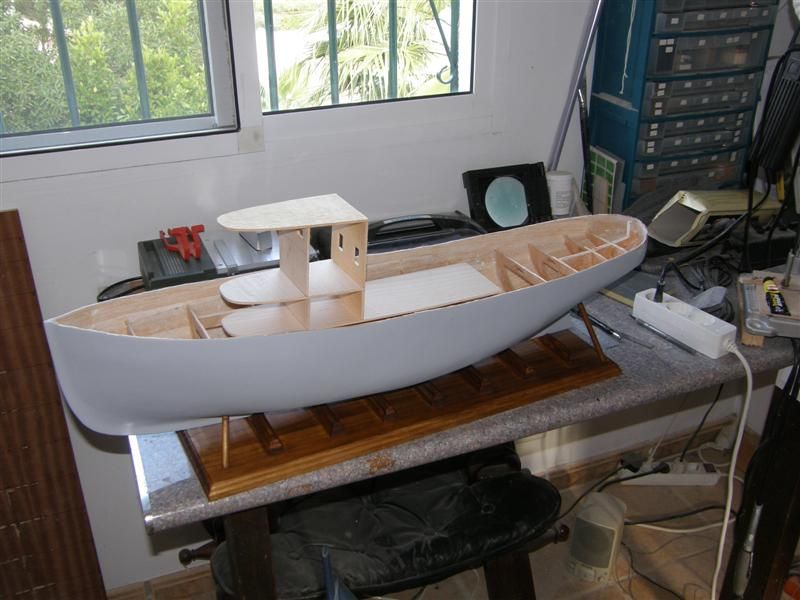

              Barry Foote
                @barryfoote68385
                Not much work done on the hull, apart from construction of a sub deck, as I have still not decided where to buy my prop and prop shaft from, so I got on with the stand, which has been finished with a little antique finishing oil.
                I also started a basic frame for the superstructure, but that is about it for now until I get hold of some more 1mm ply, shaft, prop and some figures…

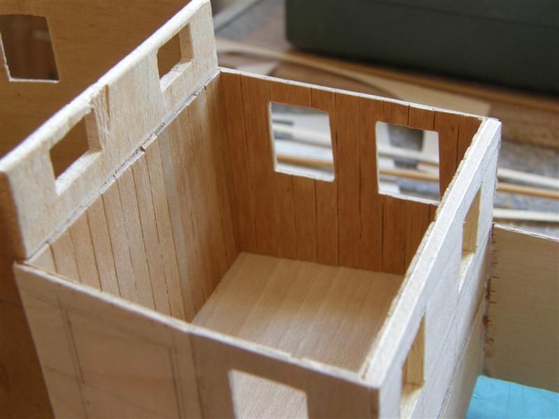

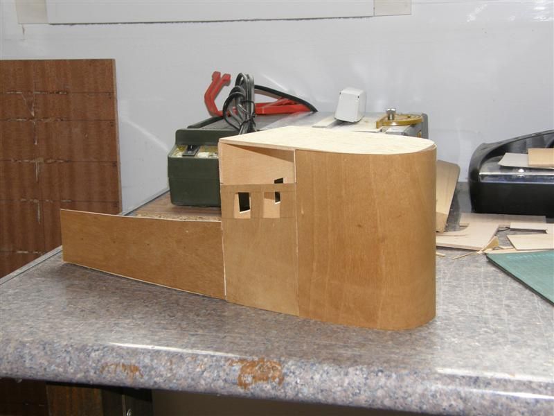

                                              Onto some detail for a change. I have started to build the main superstructure, planked the bulkheads in the galley, made up a workbench and started the stove, which will be finished when I know what type it would be. Also made up a kitchen wall unit, which has to be painted white.
                                              Edited By Barry Foote on 31/05/2009 15:15:18
                                              #21207
                                              Peter Fitness
                                                @peterfitness34857
                                                Looking good. What did you use for the cooktop, Barry?
                                                Peter.
                                                #21209

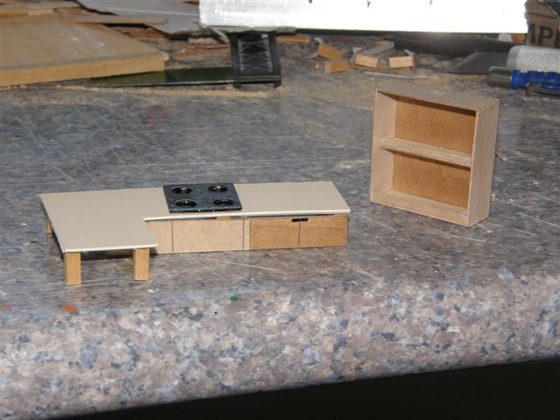

                                                Barry Foote
                                                  @barryfoote68385
                                                  Peter,
                                                  1mm ply, carefully cut out. A coat of sanding sealer and gloss black. This will be followed by matt varnish to dull it down. The rest of the worktop is done with a product I hardly ever use…..plastic card..
