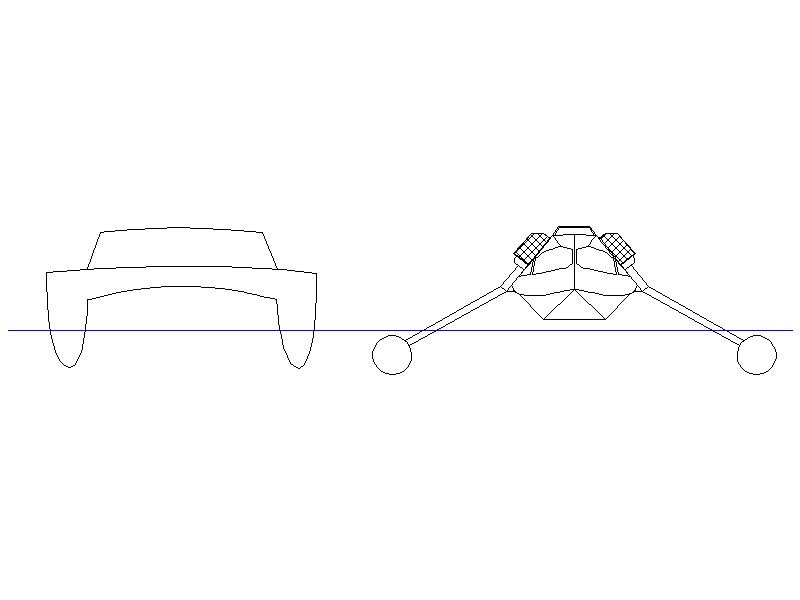

        To keep the discussion going I will say that it is easier to think of this boat as a hybrid catamaran rather that a complex submersible.
        A catamaran has a significant portion of its hulls below the waterline but doesn't suffer from buoyancy problems.

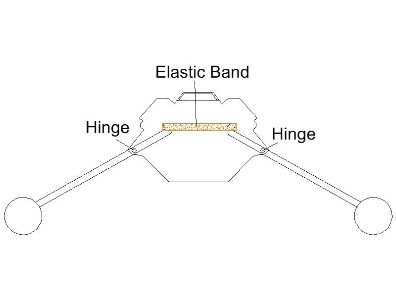

                                            Instead of problem solving with tools try casting your mind back to when you were a boy and look at the question through uncomplicated eyes. The answer will surprise you and make you think 'of course, how simple'
                                            #55240
                                              #55241
                                                Gosh, How simple. The easiest things are the best. Ashley

                                                  I still think that the wings should be synchronised somehow?
                                                  They can't possibly move in equal amounts…..Especially with powered sponsons
                                                  Don't wish to throw cold water over your idea
                                                  #55247
                                                    You throw as much cold water as you want, you have more than earned the right to criticise my work.
                                                    What would you do? (bearing in mind your comments about pie in the sky etc)
                                                    Paul smiley
                                                    #55248
                                                      Hello Paul
                                                      I would fit a piece spur gear segment to each arm and mesh them together
                                                      And if there is any space left…..A motor with a pinion could drive one of the segments
                                                      Then that'll be a proper controlable mechanism
                                                      Well, you did ask
