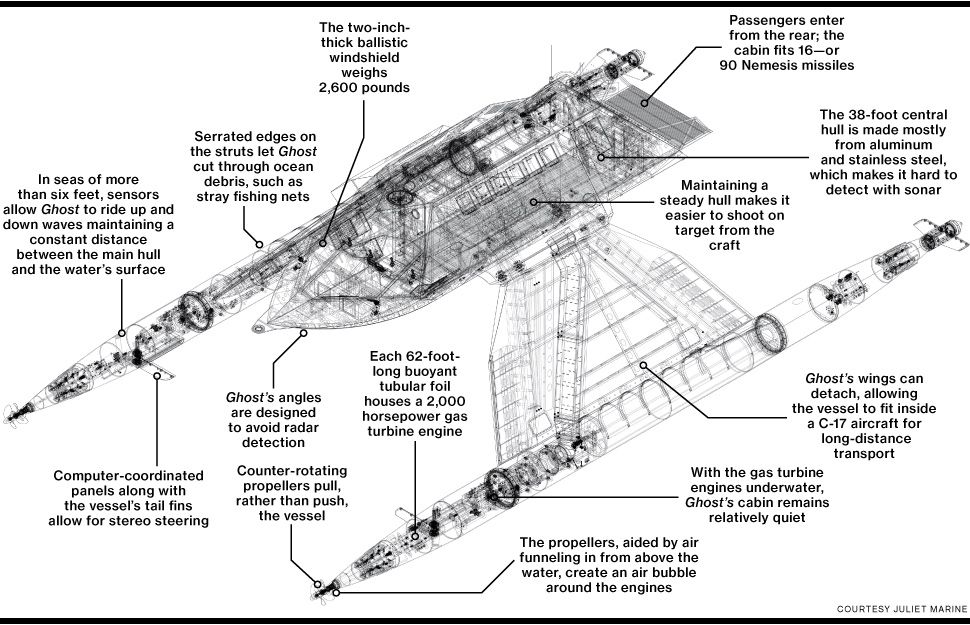

                      It would be designed to be built in five sections: hull, wings and sponsons, transport and storage wouldn't be a problem so 4ft would be achievable.
                      Looking at the drawing the propulsion is by counter rotating propellers in the nose of each sponson but there would be a lot of research to do as the science is really cutting edge.

                          Personally I would take those drawings with a pinch of salt. They will not be giving much away here. rather like looking at a cross section of Dan Dare`s Anastasia;
                          Brushless yes, ordinary waterjets/tunnelled props or simply ordinary props at the rear of the prods is as close as you will get. just consider that a model boat will be massivly overpowered compared to the original.
                          Getting a model to rise at it goes faster (using the outriggers) will be very difficult. Not that I KNOW, but you develop a feel for things when you dabble with the unusual.

                              The sponsons are heavy and don't float????…….Why?
                              The boat sets off with the sponsons wide open, which allows the hull to float on the water surface
                              As the speed builds up the sponsons pivot down and surf the water?
                              The props are fore and aft in the sponsons
                              Have I got this right, Mr Designer, sir?

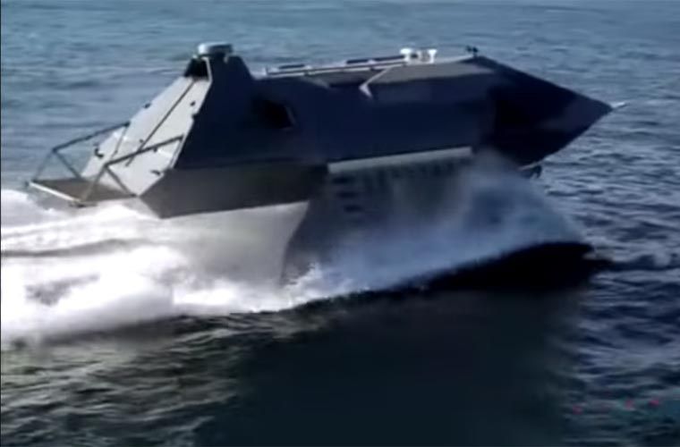

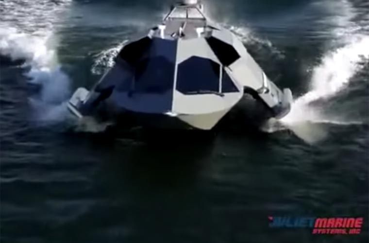

                                          Look at the spray on the 2nd last picture
                                          What is causing it?
                                          #54771
                                            I think it is water Bob…
                                            It's the fireworks on the last image that worry me!
                                            #54773
                                            Diede van Abs
                                              @diedevanabs87670
                                              The spray is simple: It is a fast moving craft and the foils have a positive incline towards the hull, so water will climb up over the edge.
                                              You can see on that same second picture they found out it were an issue and they (retro?)fitted a set of extra foils perpendicular to the foils, as spray guards…
                                              This craft is extremely tempting and interesting to build, but don't underestimate the balance issues of it: because the surface area at sea level is extremely small, even the tiniest unbalance will result in a severely listing craft. Real life SWATH ships (which I count this one as) do have dynamic balancing systems to counter crew movement…
                                              But PLEASE, design and build a model. It will be a great craft if you get it going!
