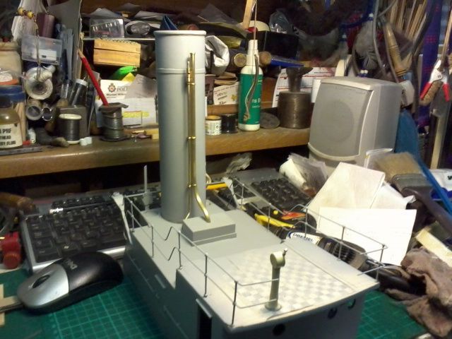

      couple more picks of the brass works on the funnel

        Hi Mick…
        The brass pipes on the funnel look great, nice work as usual.
        Did you find the pipe bending coils or work out another way to get the curve?
        Also the telegraph in position is a good touch.
        Great to see it coming together,
        Ian

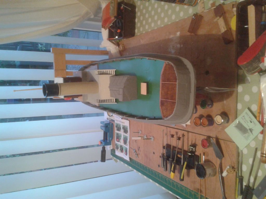

          Hope you don't mind… I have reposted your latest image upload, so we can see the great work you are doing , without chasing the thread back to your picture library.

            believe it or not thats also our kitchen table and worktop! I do suffer about it though LOL!

                THERE IS ANOTHER WAY TO BEND THE BRASS TUBE, FIRST ANNEAL THE TUBE THEN NIP ONE END TIGHT THEN MELT LEAD WARM THE TUBE AS YOU THEN POUR IN THE MOLTEN LEAD WHEN ITS COOLED DOWN YO CAN THEN BEND IT WITHOUT IT COLLAPSING ON YOU, THE TRICK IS KEEPING THE BLOW TORCH ON THE TUBE AS YOU POUR TWO'S UP IS BEST IF YOU CAN GET THE HELP,
                I WOULD BEND IT AROUND SOMETHING RATHER THAN TRY IT FREEHAND i DID HAVE A JIG SOMEWHERE MM! i WONDER,

                  Hi Mick..
                  Thanks for the explanation on how to create the bend, it looks great on the funnel.
                  I might go for plastic pipe and paint same colour as funnel, but not sure, yet ..still looking for the bending coils.

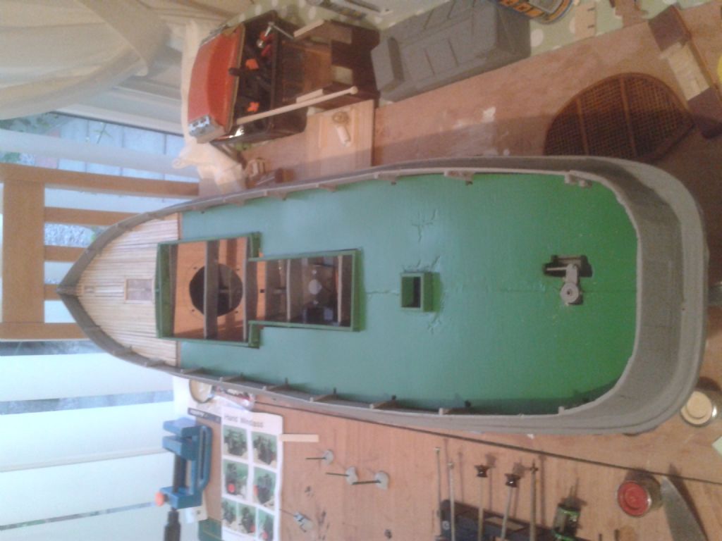

                                              #53108
                                              IAN_I
                                                @ian_i

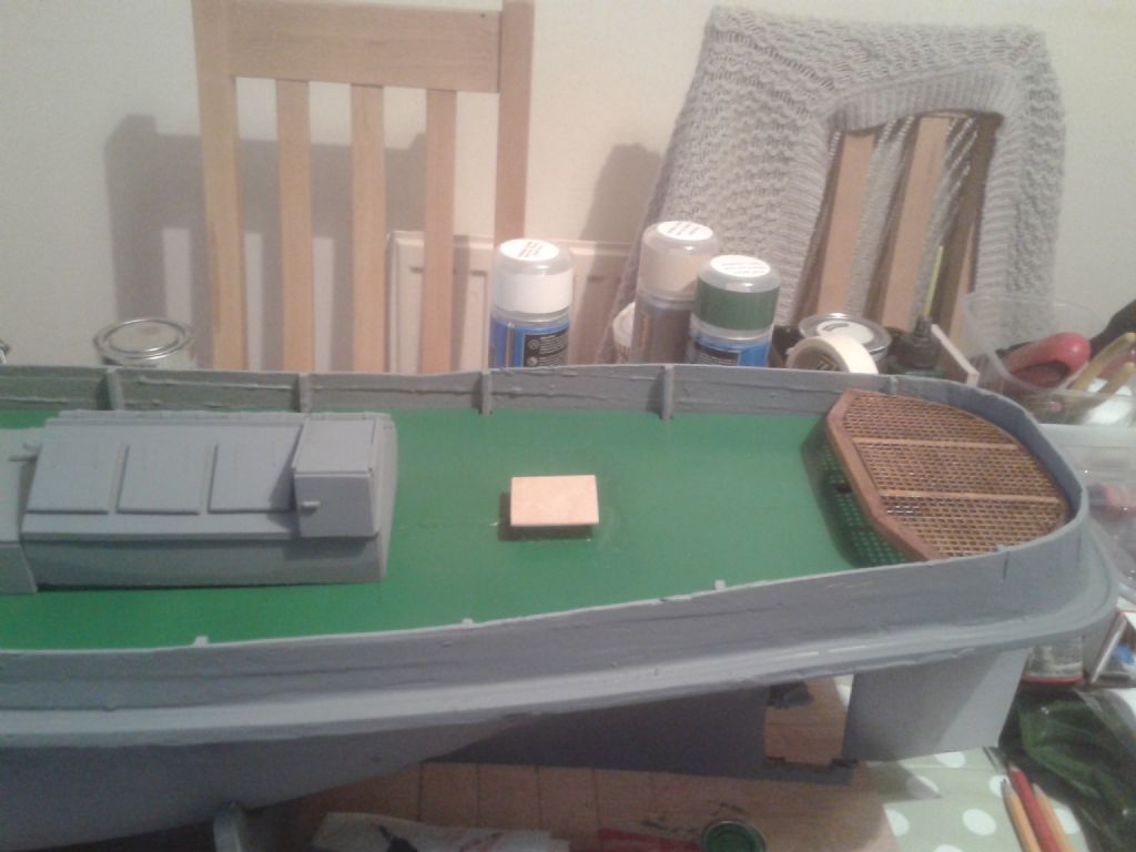

                                                #53109
                                                IAN_I
                                                  @ian_i

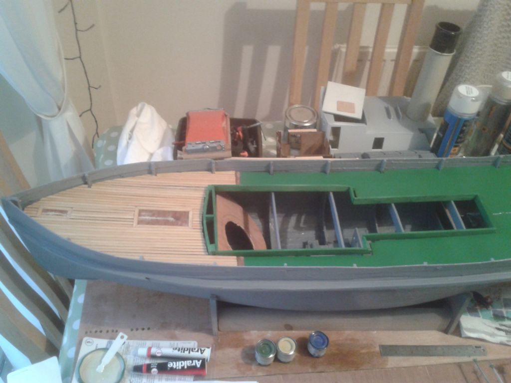

                                                  green4.jpgThe deck has sanding sealer, primer and green spray paint.
                                                  #53110
                                                  IAN_I
                                                    @ian_i

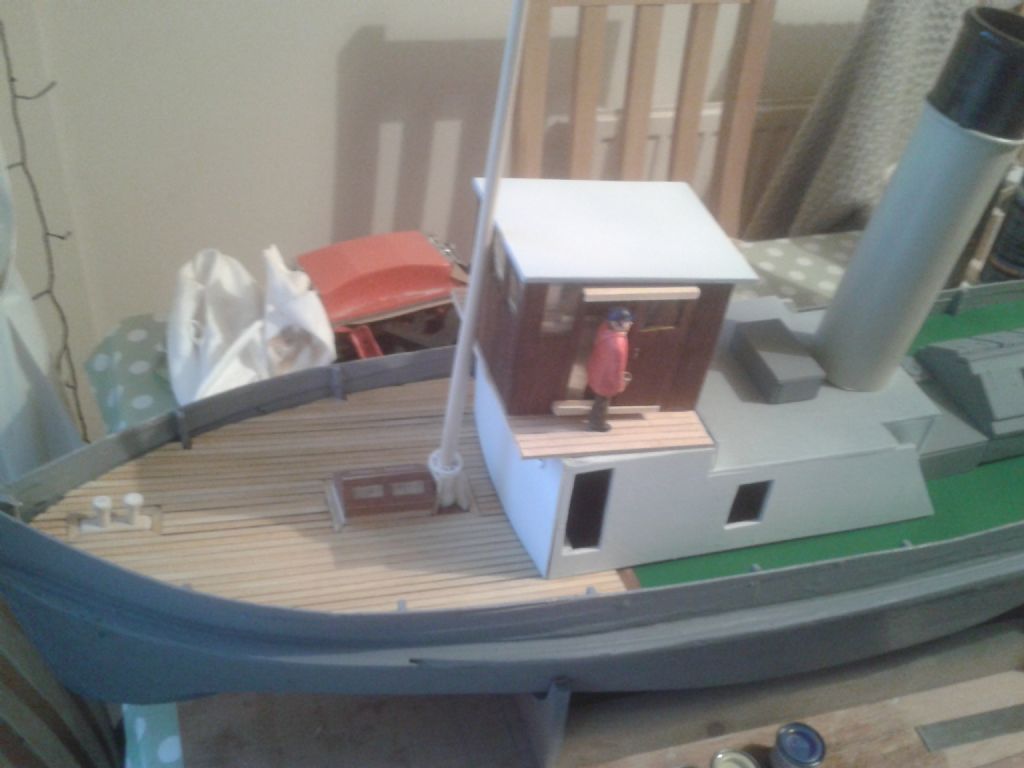

                                                    green6.jpgWhile I am waiting for the paint to dry… I have got every piece indoors to help the drying, before sanding the hull.
                                                    So took this opportunity to put the parts together.
                                                    #53120
                                                    michael wilkins
                                                      @michaelwilkins74576
                                                      I have the deck house painted white had to bring it inside to dry to cold and wet in the shed will be looking for some spray paint for the deck and the creamy one for the funnel and davits and ventilators,
                                                      I have the front deck planked up on a backing ready to put on after the whole deck fraid I am following Johns directions to the letter will have all the supports for the bullworks to put in I noticed they are not all square to the deck that seems a bit daunting,
                                                      yours is looking good now as well, are you going to make the davits and cradle from brass?I have a spare tow hook I made,
