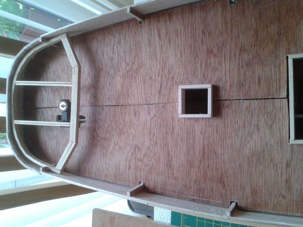

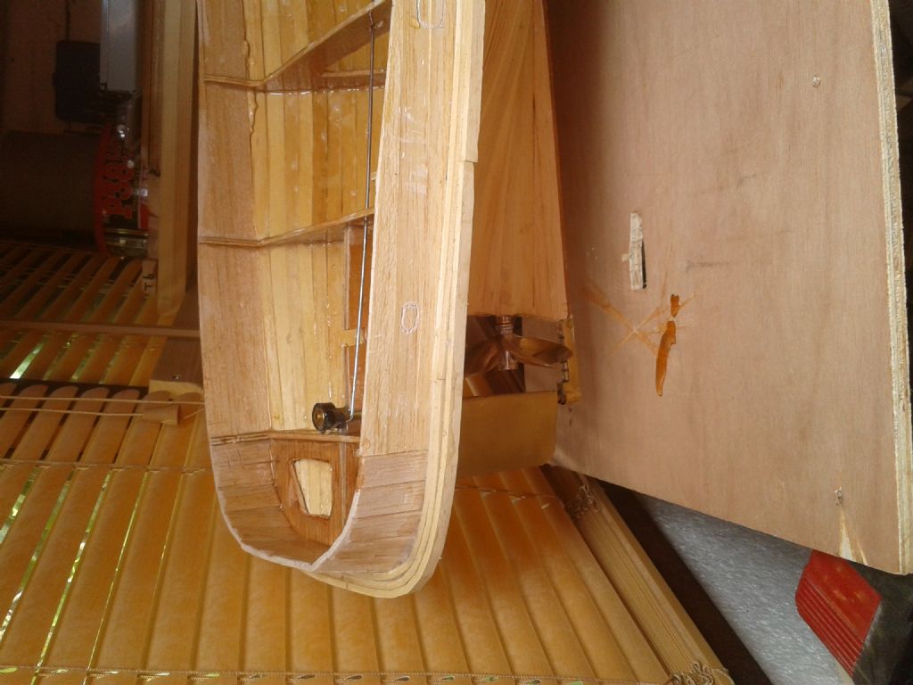

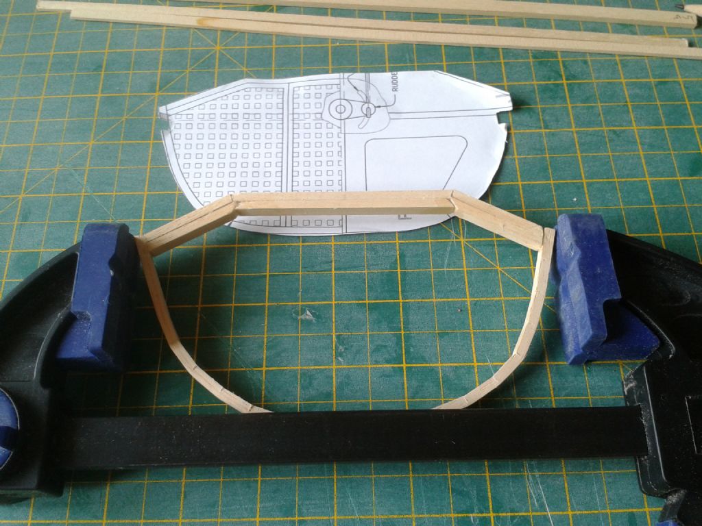

          A couple of pictures on the way I bend the stern frame for the grating…

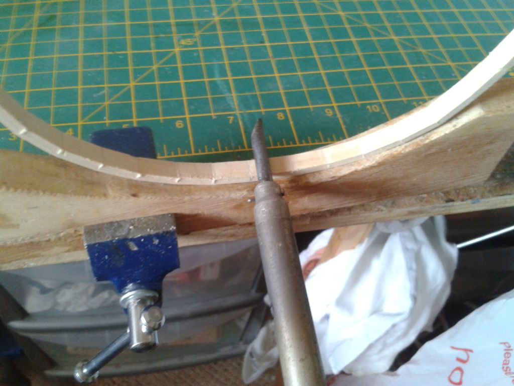

            To get the curve without the wood snapping, I soak the planks for a hour or so…

              I have yet to do this, did you make a card template first or just copy from the plan??
              think I will get this done this afternoon, I put cuts closer 1/8" it will bend then without any soaking or heat, there are some prtty tight curves on a guitar even tighter for a mandolin and the same method is used for most instruments,

                ..>>I have yet to do this, did you make a card template first or just copy from the plan??<<
                I photo copy the section from the plan on to a 4A paper then cut this out as my template..

                  Hi! Ian, finally made the grating, thats a piece of work if ever,

                    Pleased to here you have completed the grating.. I ran out of staying power on the first attempt.
                    I should have created the grating in a square then cut it out to fit.

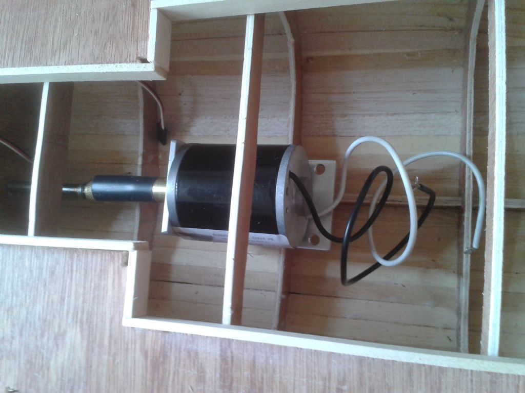

                          The T24 motor has just arrived and am keen to get it in place then I can seal the prop shaft in place..

                            Mick …I made such a hash of the grating I have taken Johns advice from the magazine and ordered the laser cut pieces, so will complete once they arrive by post.

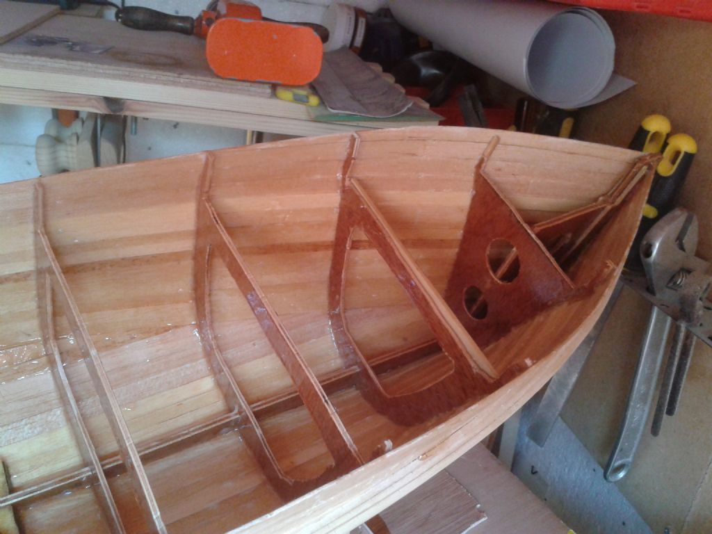

                                Starting to Resin coat the inside of the Wattle…
                                #51243
                                IAN_I
                                  @ian_i
                                  will let this coat harden then see if it needs a second coat to fill any holes…

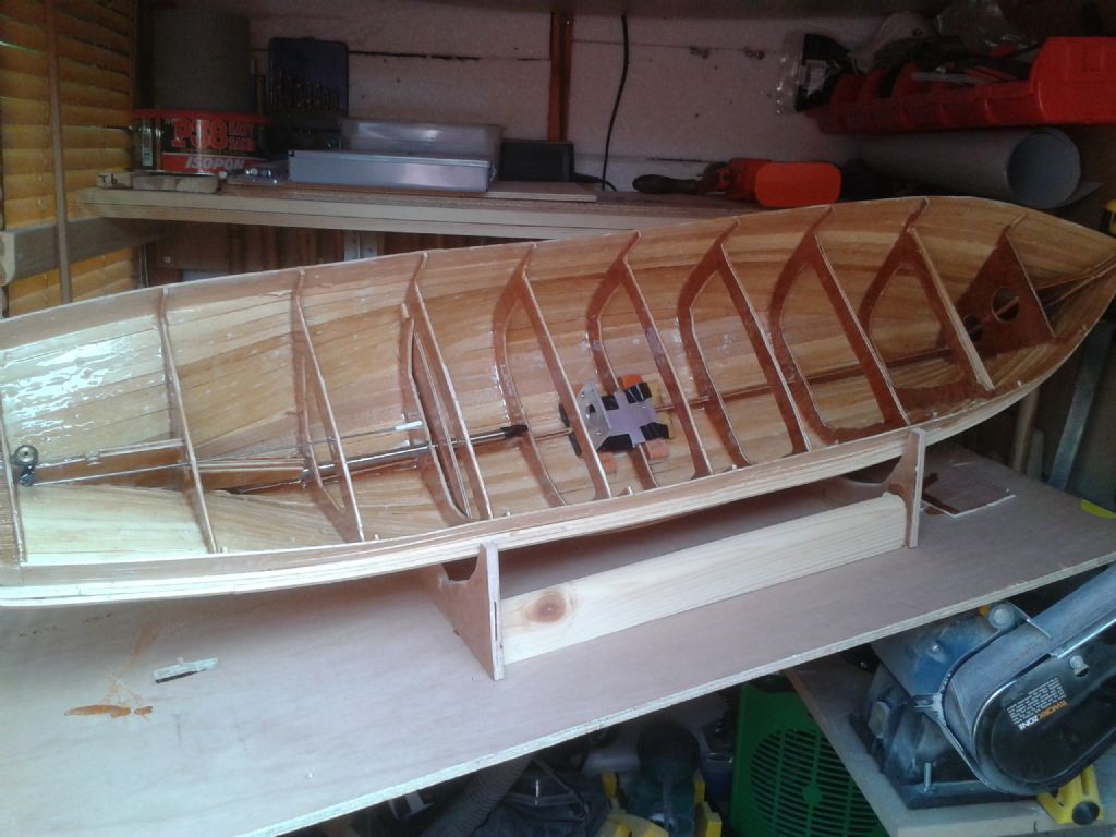

                                            Thanks Mick.. I got my bolts from a pound shop… might be a bit of a problem where you live…lol
                                            I made two curved wood plinths shaped to the hull, with sponge underneath to help with motor vibration reduction.
                                            Then screwed them in place, to the spine of the hull, once the bolts had been aligned to the motor bracket, I glued them in place. Also now has a thick laver of resin to hold in place.
