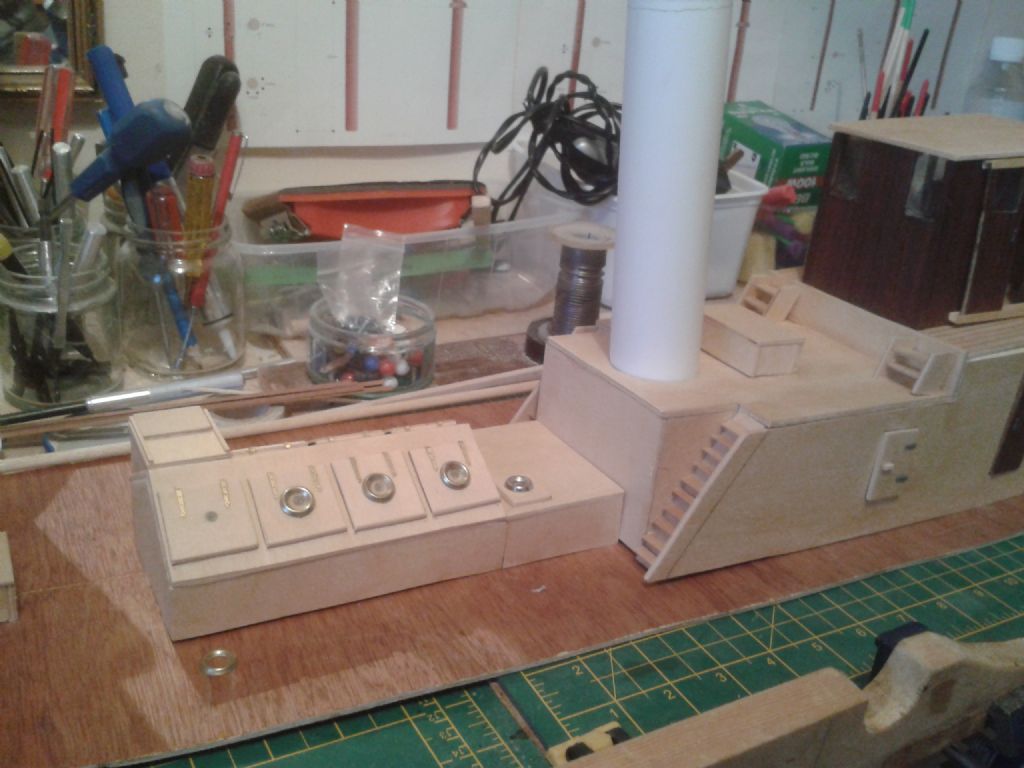

                #50295
                IAN_I
                  @ian_i
                  Hi Mike…
                  Hope you have followed AJ and Bobs instructions on create album, we are looking forward to seeing the build.

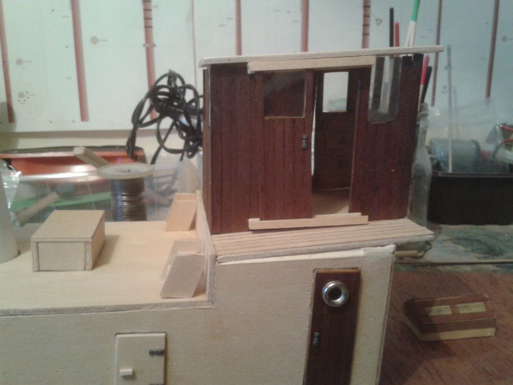

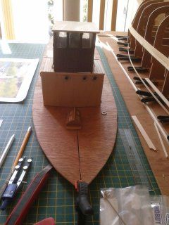

                  A few close ups of the cabin and deck area.

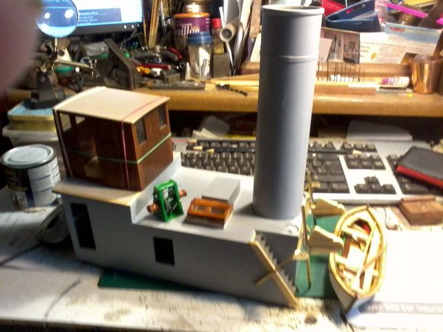

                  #50296
                  IAN_I
                    @ian_i
                    side and rear view..

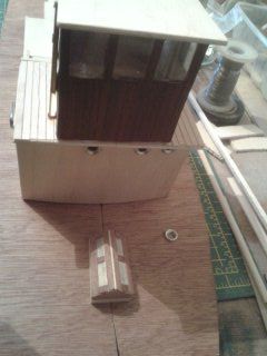

                    #50297

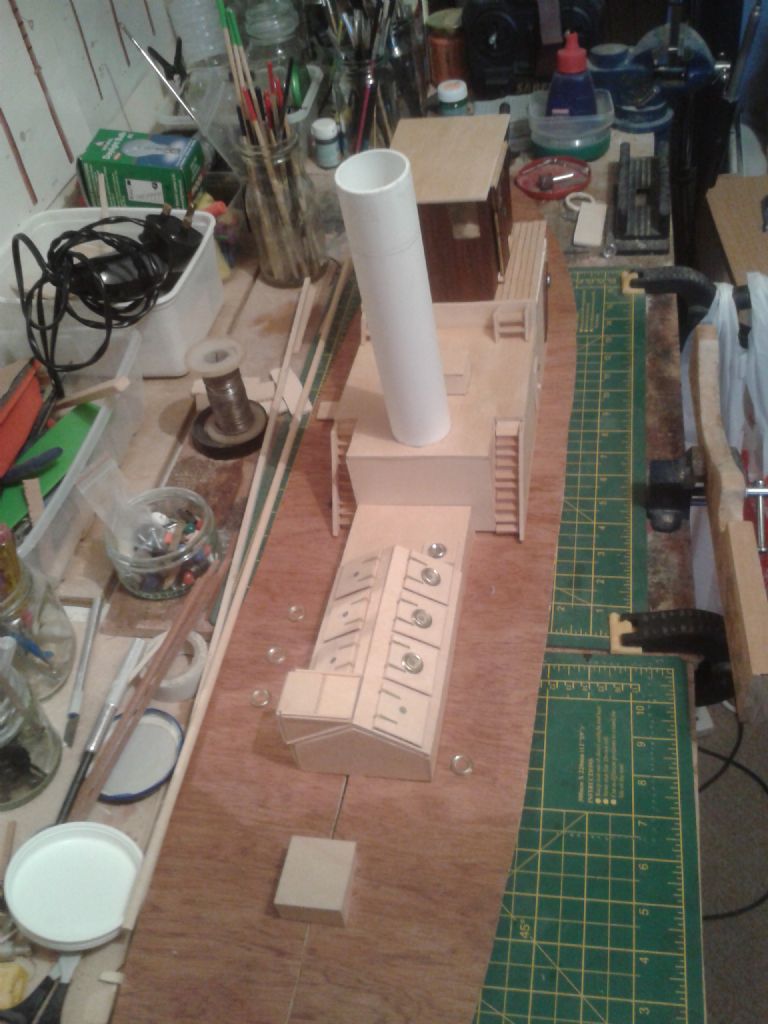

                    IAN_I
                      @ian_i
                      deck view..
                      #50298

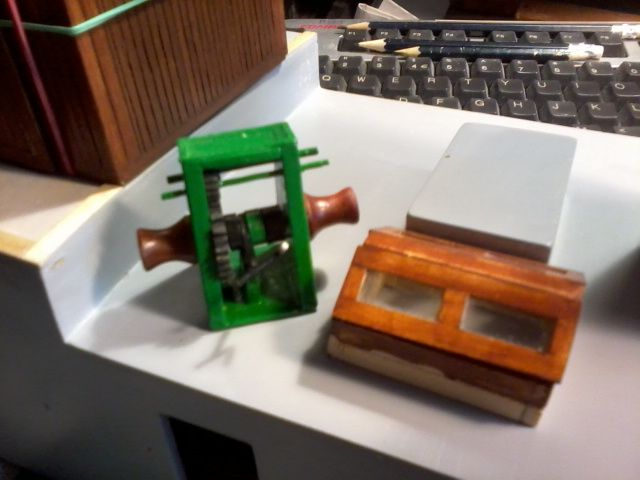

                      IAN_I
                        @ian_i
                        long view..

                                  Amy jane September
                                    @amyjaneseptember49770
                                    You're welcome, Mike.
                                    Both boats are looking great, double the pleasure! Oooh, I like the 'pod Mike.

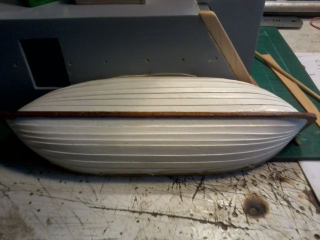

                                    #50308
                                    IAN_I
                                      @ian_i
                                      Hi Mike…
                                      Great looking build, very good eye to detail.
                                      As AJ said… the small boat great detail,
                                      also the funnel did you make from scratch or manage to find
                                      the right size poli bore ?
                                      Regards,
                                      Ian

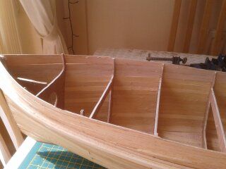

                                      #50333

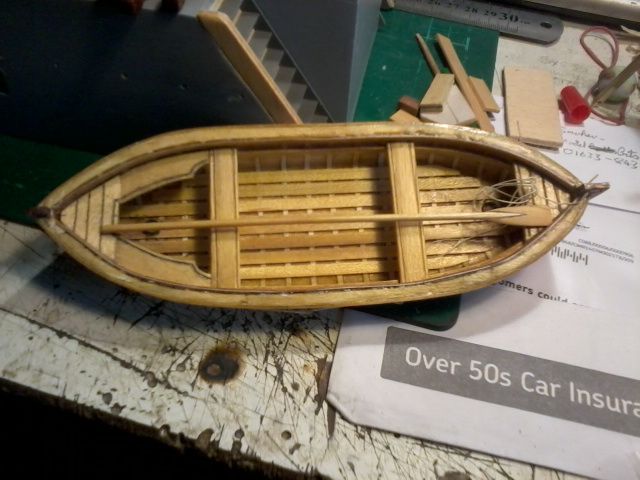

                                      michael wilkins
                                        @michaelwilkins74576
                                        Hi! thanks the encouragement most welcome,
                                        the first thing I made was the lifeboat LOL!! enjoyed making it a few details to finish it but not much,
                                        the funnel was made from a 2" dia cardboard tube soaked with shellack then continuosly rubbed down and re coated many times until sanding stopped bringing up the fuzz! then fiberglassed inside to make it strong and waterproof as I will be putting in the foggy 2 and it does get condensation inside the funnel and thats that,
                                        more filling and rubbing down on the hull I thought I took pictures of it but couldnt find them so will take more and see if those sprites and elves leave them alone.
                                        so its goodnight ya all
                                        mick

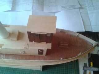

                                        IAN_I
                                          @ian_i
                                          Hi Mick…
                                          I look forward to seeing the hull, hope you manage to upload ok…lol
                                          a good find with the cardboard tube, I am still looking for a funnel or will have a go with poli sheet.
                                          I have a some pics to upload later, have just put all the parts together ( loosely ) to see how it looks.
                                          Regards,
                                          Ian

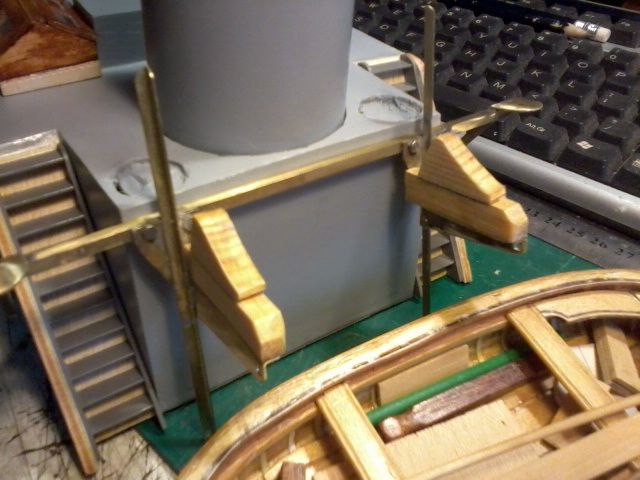

                                          #50344
                                            Ian. Try some of this for size. Good website, loads of useful gear.Ashley
                                            http://www.ema-models.co.uk/index.php/abs-tubes-fittings/one-piece-extruded-tubes/vessel-tubing-50-8mm.html
                                            #50353
                                            IAN_I
                                              @ian_i
                                              Hi Ashley..
                                              Will check out the EMA site, many thanks for the info.
                                              Ian
                                              #50354

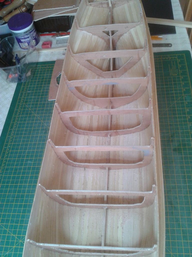

                                              IAN_I
                                                @ian_i

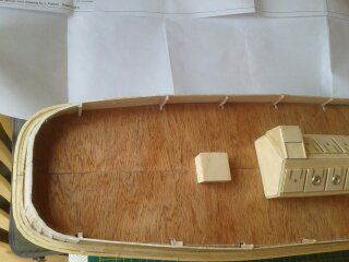

                                                cut out the supports from the ribs…
                                                #50355
                                                IAN_I
                                                  @ian_i
                                                  check for level..
                                                  #50356

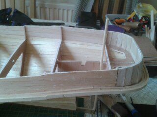

                                                  IAN_I
                                                    @ian_i
                                                    loose assemble of parts to see how it looks..
