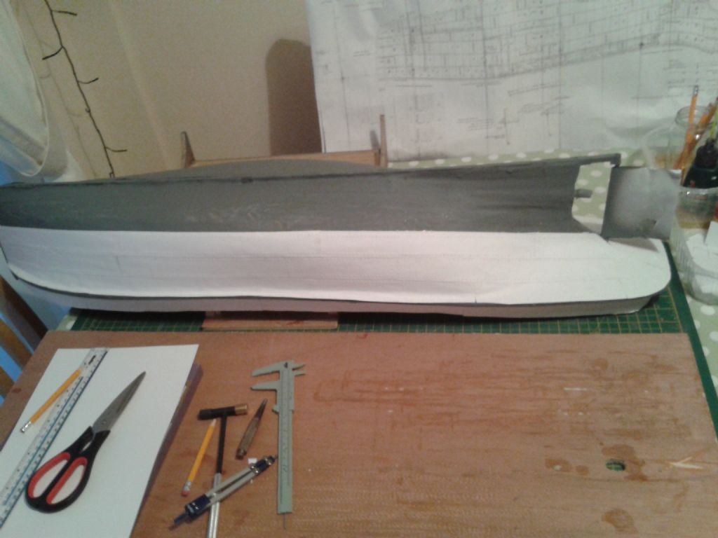

      #59493
      IAN_I
        @ian_i

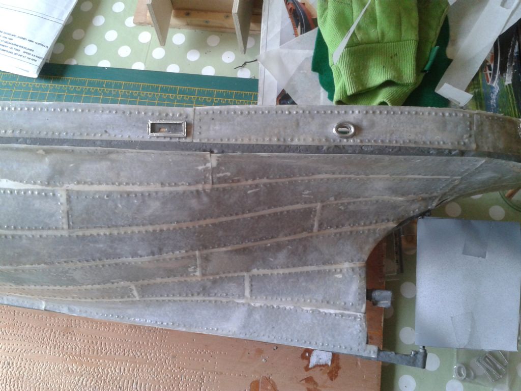

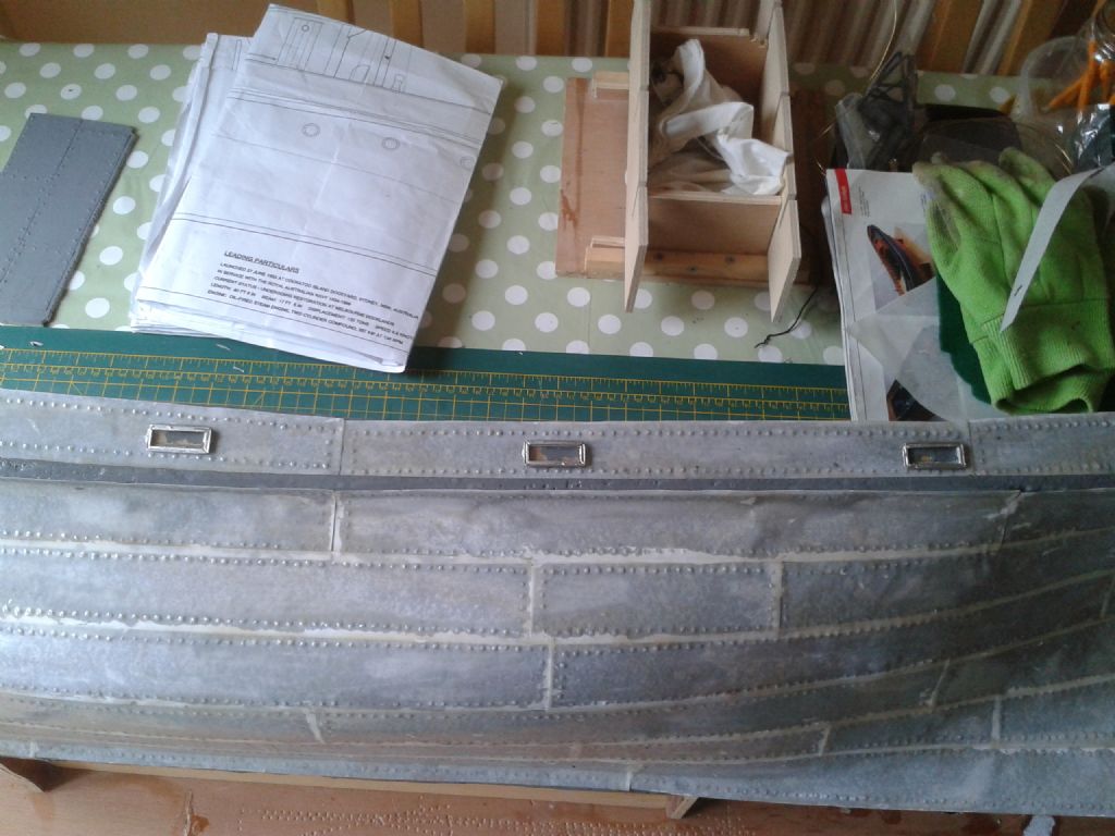

        It was a long job making all the panels and making the rivet points…
        #59494
        IAN_I
          @ian_i
          coating the card to make it water proof once the panels had been finished seem to take ages..

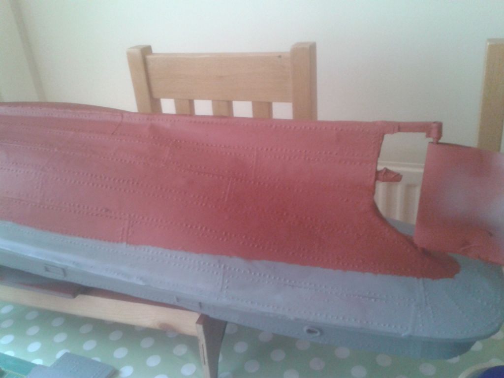

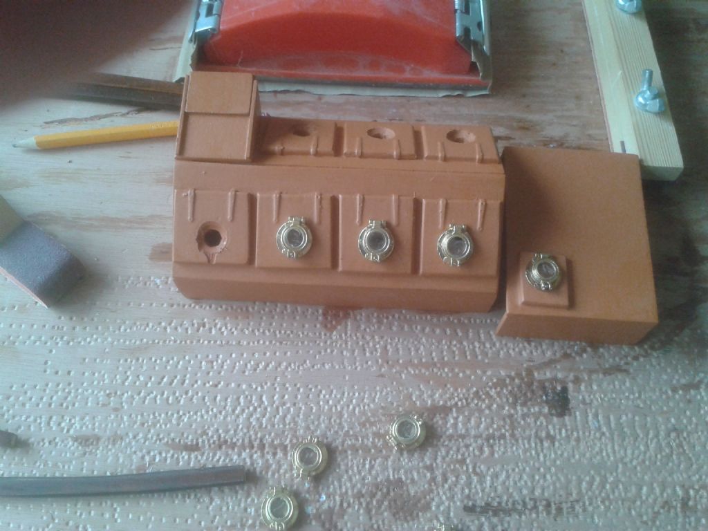

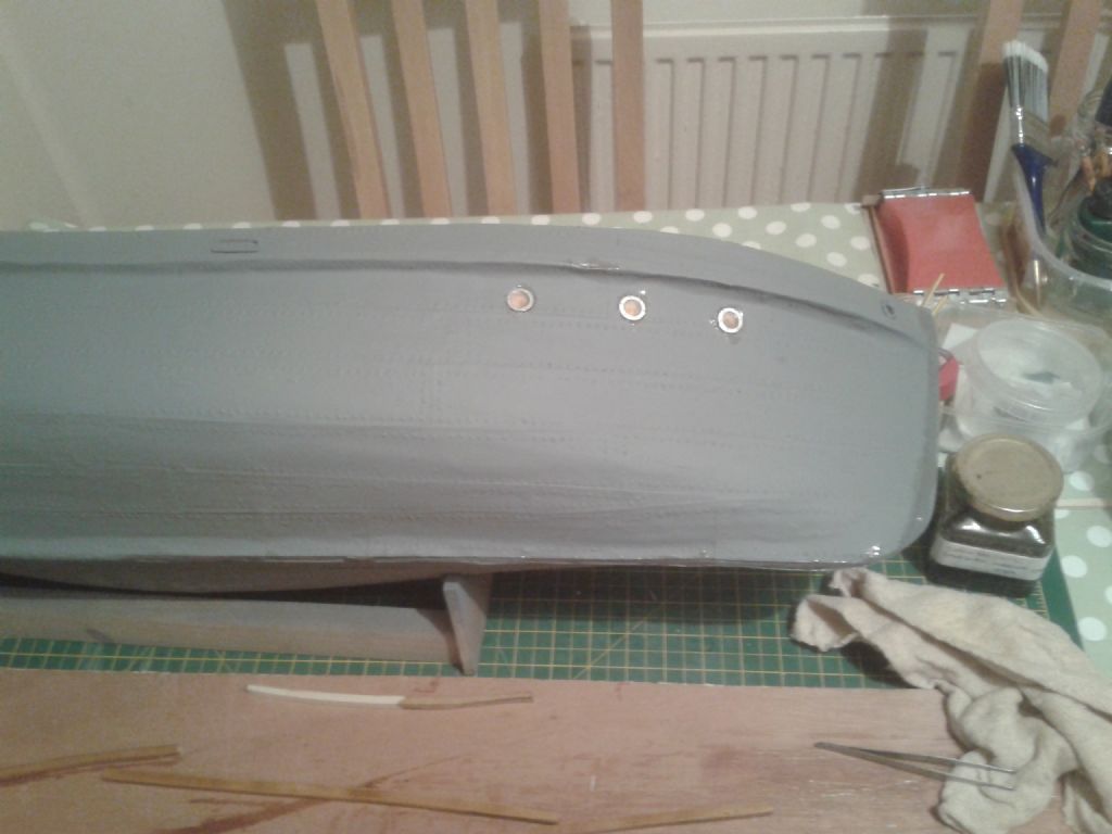

            #59496
            IAN_I
              @ian_i
              ..red primer…
              #59497
              IAN_I
                @ian_i
                new port holes..

                  Hi! Ian, WOW!!!! looking excellent, plating looks spot on, I haven't done the plating as I still keep getting the running out of time thing cant seem to shift it keeps coming back so I just crack on this Wattle has been whetted and runs perfect it had a bit of a list to stbd. so adjusted that and its second sea trial is now due,
                  I did find a tool that can be used for making the rivet effect its a thing used to mark a dressmaking plan onto paper, it is just a handle with a wheel that has teeth on it and it is really good will impress thin ali sheet no problem
                  I will be starting on the amazing hull as the SWIFT a gunboat from the Vietnam war a coastal patrol boat built from foam,
                  where did you get those portholes from they are excellent, my copy of the wattle magazine is well thumbed through as well, I have just finished the mast cables and screw adjusters I have made it so I can take them off and lower the mast for traveling.

                    Hello Ian,
                    I must chip in here, and say that I absolutely agree with Michael Wilkins – those are very pretty portholes, not least as they are the hinged cover type, which always adds to the appearance!
                    Am likewise very impressed by the effort you've put in to the plate-and-rivets effect, and even more so by the result! It really looks the thing!

                      AMP is the port hole supplier I found them in the model hobby parts book, will get more detail.

                        Thank you for those very kind words, I do appreciate them and have been driven by your excellence in your build.
                        The portholes are a great find and the model hobby parts is a great asset to the realistic look of the wattle or any build.
                        Hobbys had book 2016.
