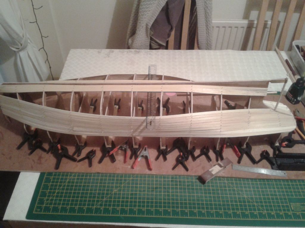

                        #49957
                        IAN_I
                          @ian_i
                          Planking complete
                          #49958
                          IAN_I
                            @ian_i
                            Both sides even
                            #49959
                            IAN_I
                              @ian_i
                              Measured a stand from rib C to G.
                              #49960
                              IAN_I
                                @ian_i
                                Can now epoxy resin inside before sanding outside.
                                First coat of sanding sealer on the out side.
                                #49961
                                IAN_I
                                  @ian_i
