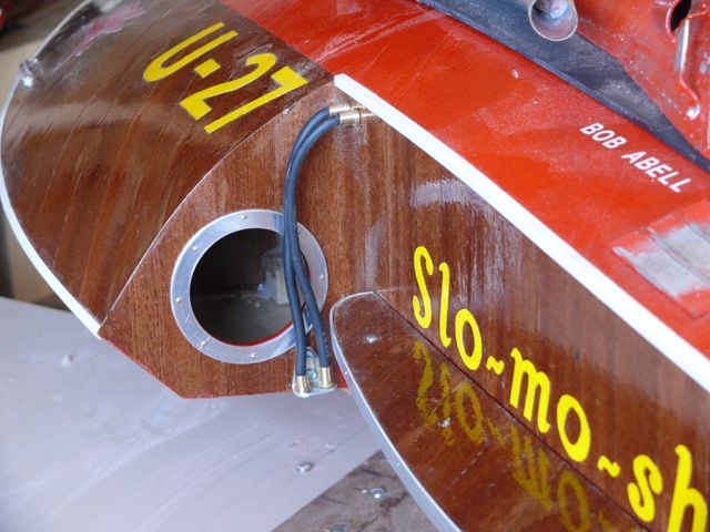

            Just look at this chaps……..What I thought was a cover, when seen on a small photo….turns out to be a gaping hole each side of the hull!
            Hmmmm………Am I brave enough to copy this?
            Will need top consult my floatation  tests pix before I get the saw out!
            I`m tempted!…………………..Bob

                  The will be very handy for getting the batteries in too!

                    I believe that in use that hole has a cover on it and this has been left of in the museum to allow a view of the structure in side. As you point out very handy for bty acess I’m seriously considering it on mine if the bty’s will fit through. doubt it though !
                    Phil
                    #26251
                      Hello Phil
                      I`ll sandwich a black plastic cover between the ali ring and the hull wall.
                      Next time we sail, I`ll see if it really needs covering

                        I’d lay money on it Bob looks like the quickest way to turn it into a submarine to me
                        “Periscope depth if you please No1”

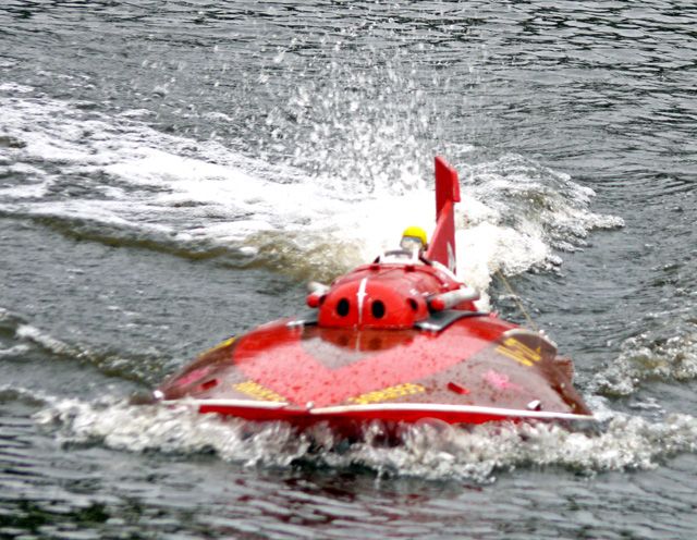

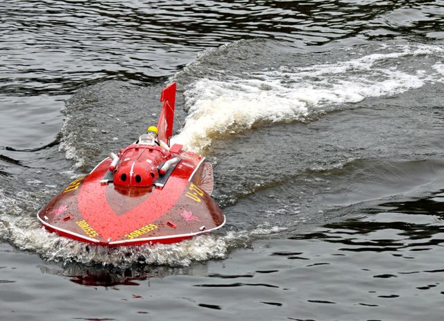

                                The 4th Test
                                Slight improvement, but still stuck like Gorilla Glue to the water surface!
                                The boat lay in the water nicely, now that the balance was adjusted correctly.
                                Next mod would be something to break up the suction effect……..Any ideas chaps?
                                Did an anchor test, with the boat connected to a fishermans spring balance and we got exactly 8lb……………………How`s that, Paul and Phil?
                                Looking nice waiting for the off!
                                Just coming round for a fly by!
                                There`s plenty of fire and brimstone available………..How about a few “steps” to reduce the suction effect?
                                Still got too much water squirting out at back!
                                PS…..Many thanks to Keith for taking the pictures!

                                  I`ve just had a word finally, with the club`s Speed Freak………John G`…………….And he put his finger on the problem, straight away!
                                  He says that the MMB 900 motors are “Torque motors” as opposed to “Speed motors”
                                  And they work best with coarse pitch props
                                  The latest props are on the limit of max pitch…..(100mm)………………So the next step would be to gear the props up by……..2 to 1…….because the motors can live with this!
                                  The motors run at…….9000 rpm, so by gearing them up, I could get 18000 rpm and using a smaller prop……………She will fly!!!!!!!!!……………Where have we heard that before?

                                            OO er..so near yet so far!
                                            The power is simply not being applied into the water judging by all that white stuff out the back…and the white stuff is concentrating in a single column as well..? how about a fence separating the props as a try out to see if interaction is hindering max.performance?
                                            please please try some boring 3 blade brass ones, out of sheer curiosity!
